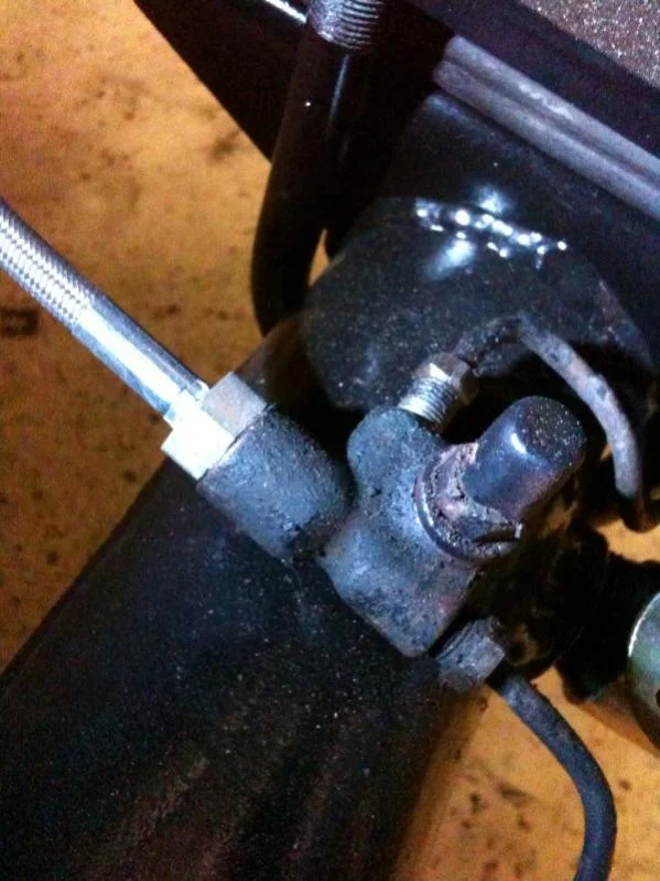

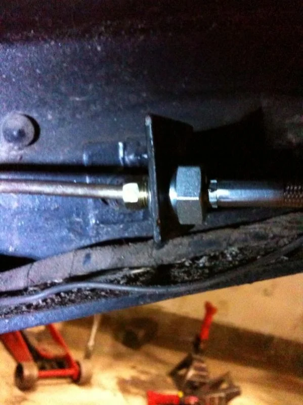

While completing a SOA on my FJ40, I hit the wall with the 9-mm issue as well - Aside from being dirty my lines seemed to be in good condition so I devised a way to use ALL the existing "T's" and connectors with the exception of the ones connected to the new - Soft Lines which were 3/8 - 24.
  • Cut the short steel line threaded into the soft lines and remove the 9mm fittings
  • Using a longer new steel line I cut the appropriate length - slid the 9mm and 3/8 fittings on and using a flaring tool from Kragen Auto Parts re-flared the cut end.
  • Reinstalled lines using the old 9mm fittings and new 3/8.
  • This worked with both front and the single rear.
  • The original steel brake lines that piggy-back the rear axle housing worked surprisingly well after the SOA in the rear.
I'm a Dirtbike Veteran venturing into the 4x4 world. Hope this is helpful. ORME Brothers in Van Nuys, CA made my custom lines in a snap - great quality.
First attempt at importing pics - I apologize in advance if I'm a failure.
Here are the new Soft lines connected to the original steel lines using the 3/8 fittings I slipped on.
Sorry the pics are so large - I thought they'd be tiny coming from an iPhone.
Hope these help my post from earlier.
