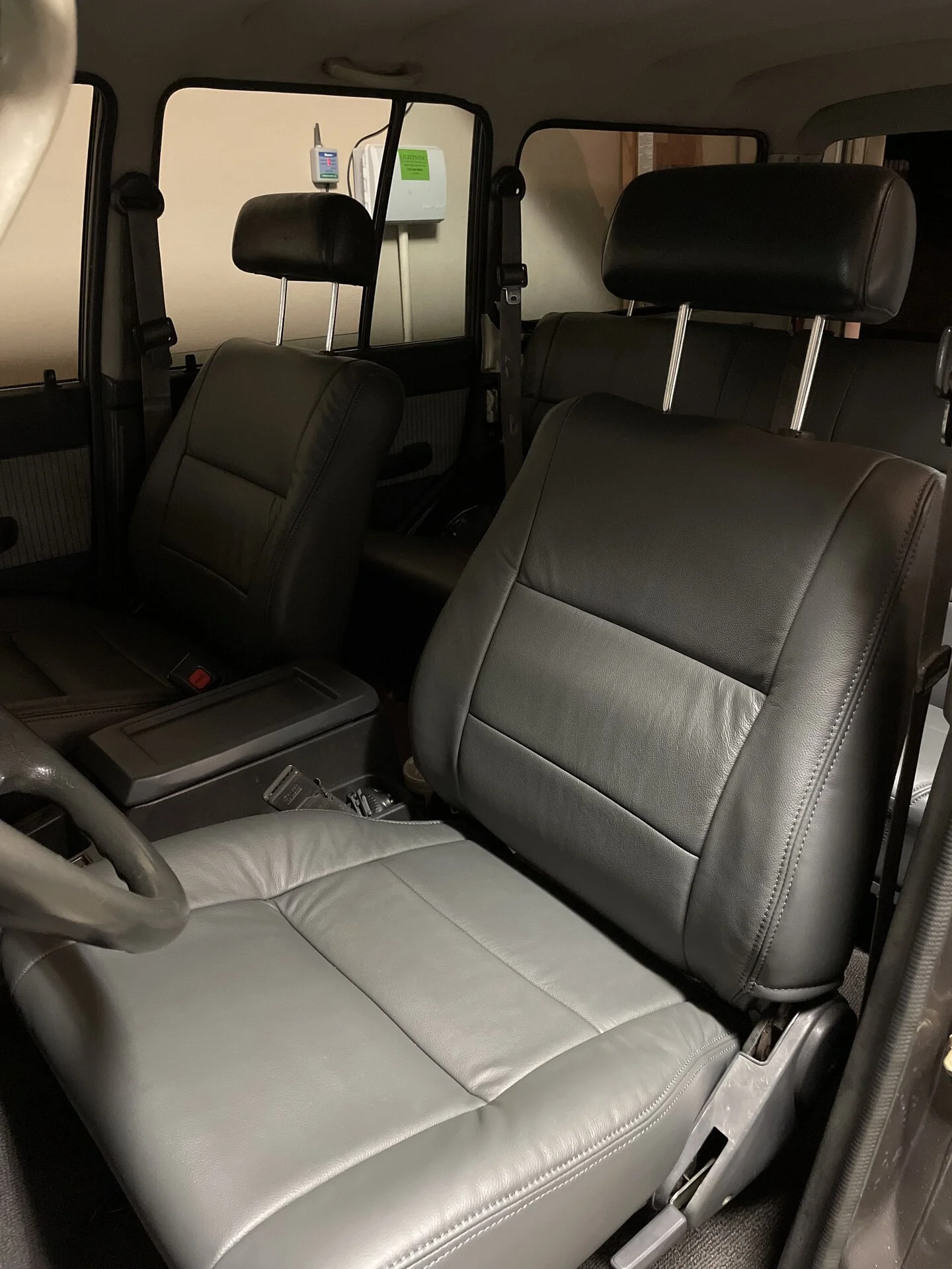

I debated various seat options as well - mine were trashed (front and back fabric, and front foam bottoms). The SM option would probably be the most comfortable but was not in my budget. I debated just dropping in some affordable Smitty Bilts for the front, but couldn't get my head around everything not matching. Ultimately, I ordered two new foam bottoms from Specter (various IH8MUD threads on that subject) and ordered leather re-upholstery from Mosley Motors (color Graphite). It's a little darker than what the photo indicates. I'm pleased with how the project turned out (but will be happy if I never see another hog ring). It was a straight forward project, with the exception of the headrests which I still haven't figured out. Really pleased with how well the leather fit (and it smells like a new car now). I did add a little seat back bolster foam for the driver seat while I had things disassembled (which is why there's a slight ridge on seat back).
