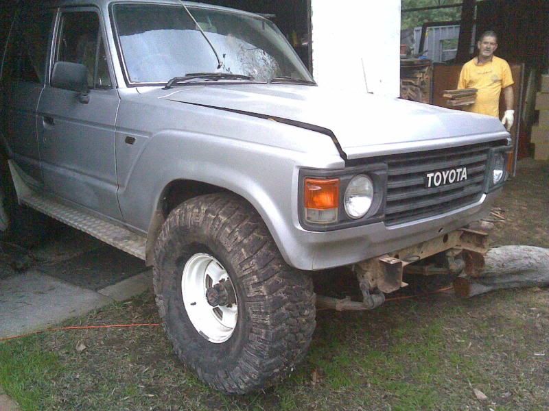

Factory flares? :confused:
-Carl
You have many sets of eyeballs on your build...
it seems that way :):)
-Carl
as Toyfj45 pointed out, they are off a 62 series, well a top of the line 62 series, my original white 60 was actually a base model 62
the new one (60Bob) is a HJ60
Dude....Sick.
thanks mate, im glad you like
i did a bit of work on it over the last few days...
pulled my high steer arm off to get it machined to fit the factory 60 series drag link, (the drag link hole is suited for a hilux drag link..dont know why...it just is) so i should have that back this friday,
also have to redrill the flange on my Tcase, as my front drive shaft has a hilux double card joint at the top to help clear the notched front crossmember. i will try to do this before work tomorow, if not deffintatly friday!!
my extened brake lines should also be here on friday so i will be fitting them and also springing over the back end..:):)
so lots to do, but fingeres crossed it all goes smoothly
keep up the input guys, its help the process to keep moving along
