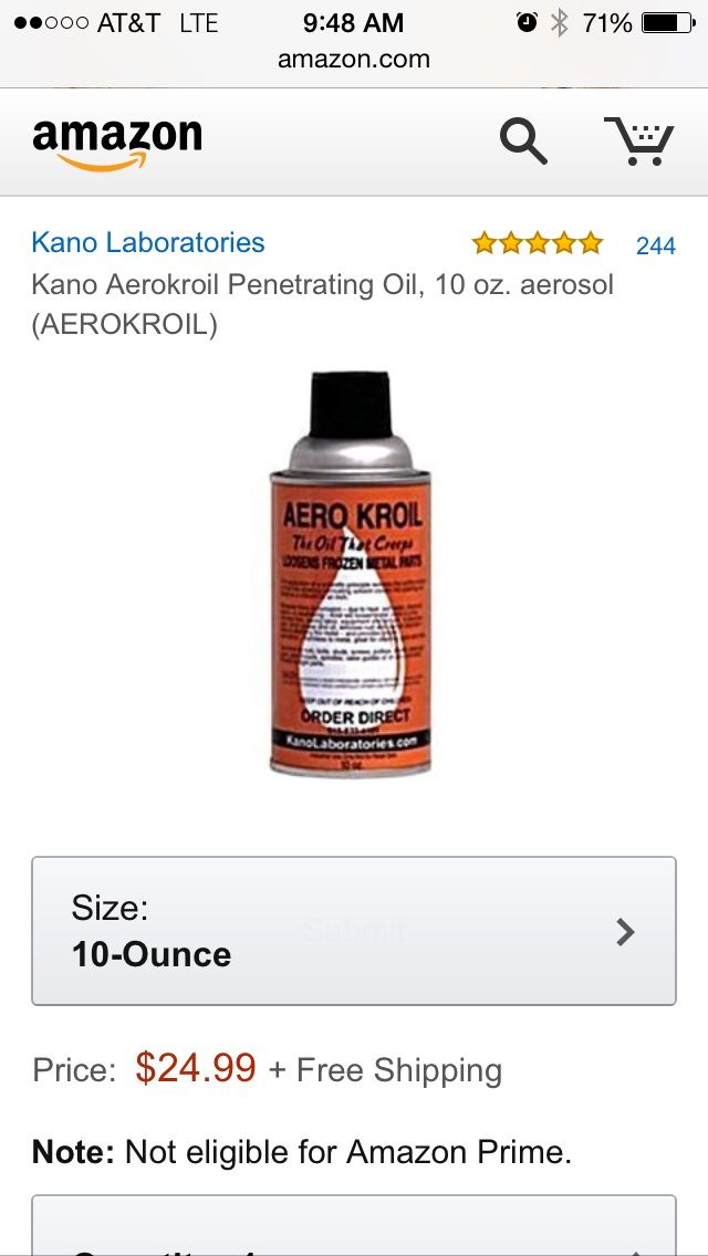

Buy you some Kroil and spray everything....it kreeps and get to where it needs the lube.
I've never used it before. Amazon makes acting on tips like this easy.
