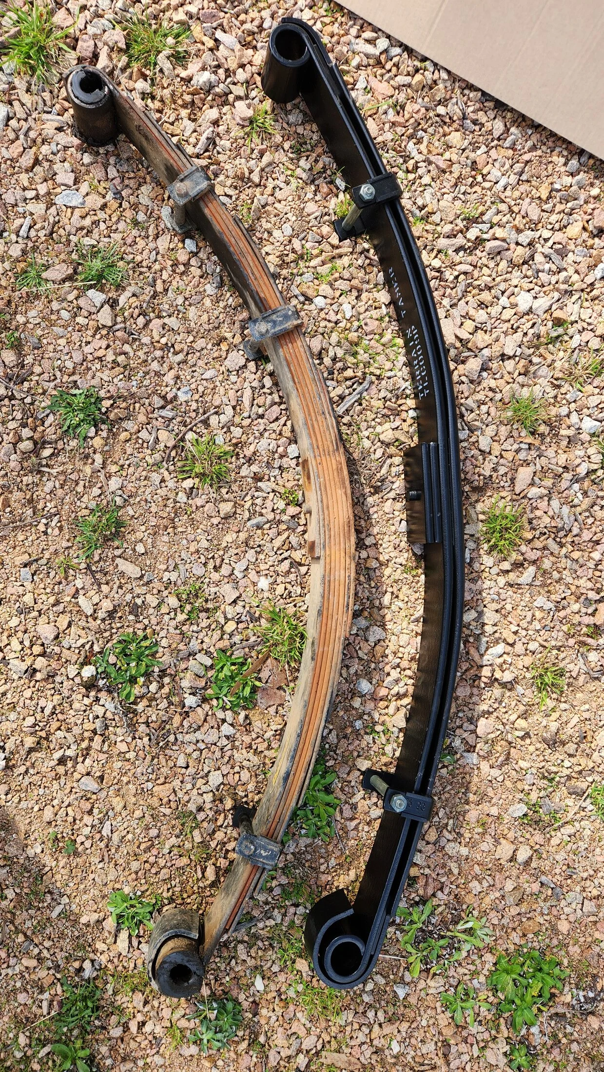

I've had the Terrain Tamer parabolic springs in my HJ61 for probably 6 months now so I rekon I can do a bit of a review
They are super light. Way lighter than the old leaf packs. You probably shave off 20kg - 40kg.

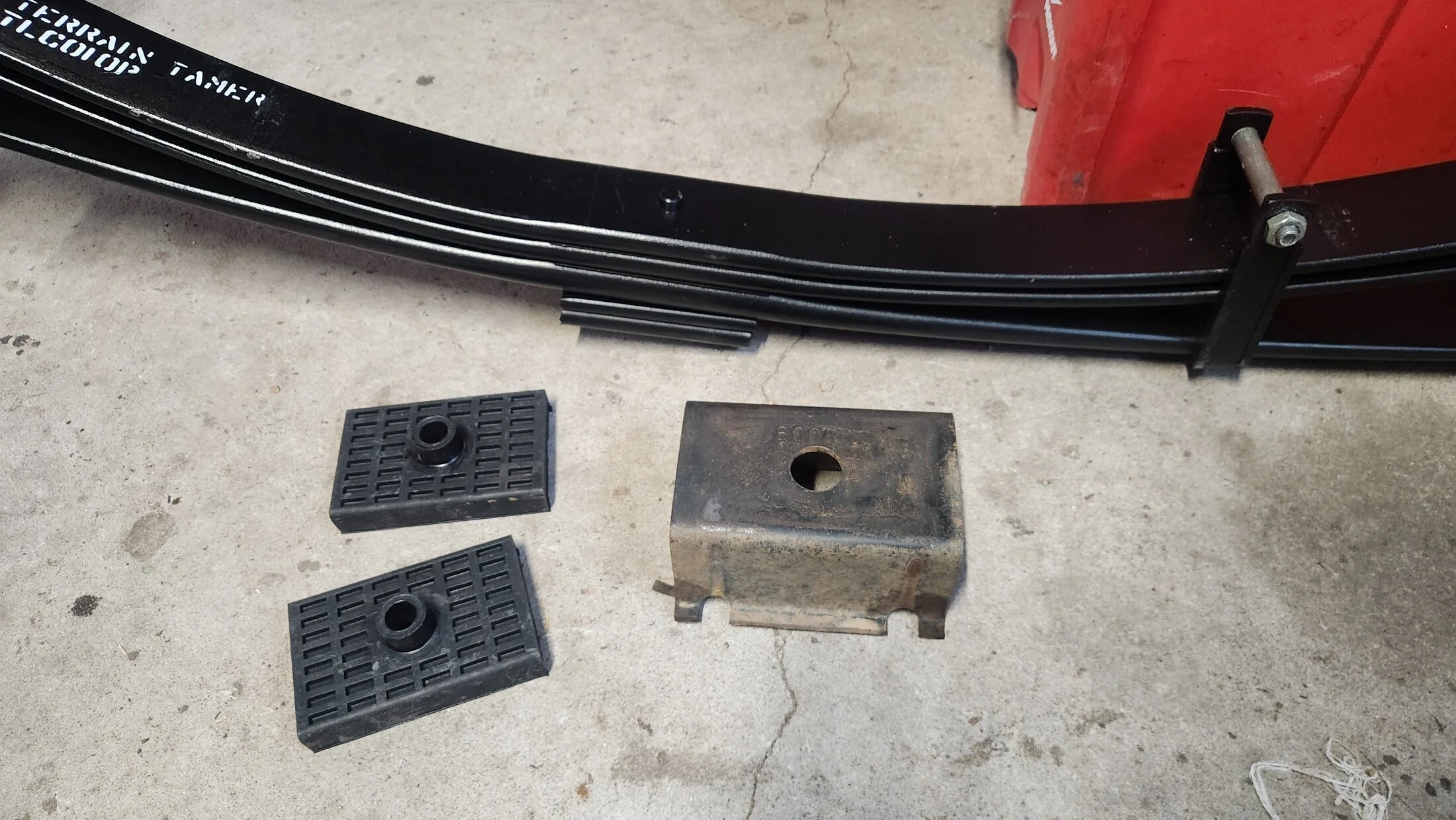

I'm not sure if it's just a HJ61/Sahara thing but my Landcruiser also has these rubber pads in the rear. I've never seen them before on any other Landcruiser and when I ordered some from my local mechanic/Terrain Tamer dealer said he hadn't seen or heard of them either. They are on the Terrain Tamer website.
I was still able to buy genuine ones. Maybe check to see if yours has them before ordering. It paused my install for a week because I didn't want to put it all back together just to have to pull it apart again to put these in.
