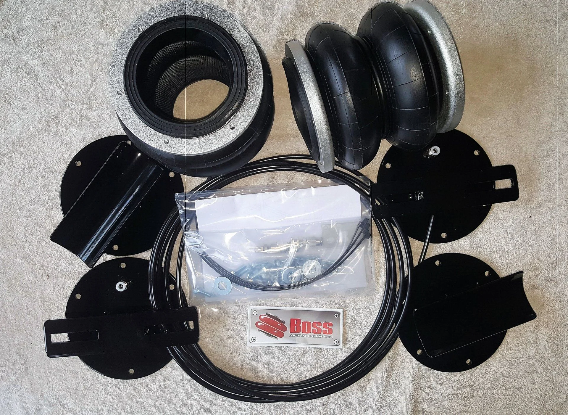

60 Series Air Bags and Brackets Build
These are still working great on my truck. They made a huge difference in fixing the rear sag and help stabilize the vehicle when I’m all loaded up. I haven’t noticed any issues with articulation either.
The Airlift bags themselves still look new and I haven’t had any leaking. It’s a quality setup.
On my last trip I ran them at 18psi, which is higher than I normally run them. I was loaded up more than usual, but the ride felt really good.
If I’m just cruising around and have the RTT mounted on top, I run them in the 10-12psi range.
