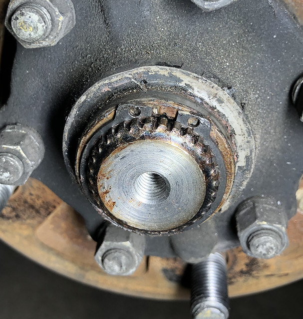

Found some other fun though!!
Passenger side..
Dust cap literally just pulled off by hand. This is what inside looked like. Didn't feel like metal shards thankfully.
Untitled by Greg Fisicaro, on Flickr
But you could tell that it had been in contact with the elements for quite some time. Gotta love the work that 4WheelParts did on this.
C-clip was in OK shape, pretty chewed up on a couple edges from someone smacking it with a chisel but fit the gap. Measured at 2.15MM and was able to slip a .018mm feeler gauge once installed. I regreased everything and called it good until I replace the hub flanges, axles etc.

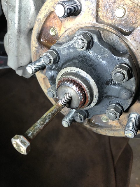

But wait looks like new outer TREs are in my future... Didn't get a pick of passenger side, but this is drivers. Can actually see metal there.
Oh and almost forgot... found this FUN from that asshat that did the install on the drivers side axle. Ears on the clip were actually ground down so it would fit the dust cap, bit of maring on the inside of the dust cap too...
Cleaned up around the hub flange and looks like the person actually black RTV'd the flange on... so YEAH for that...
