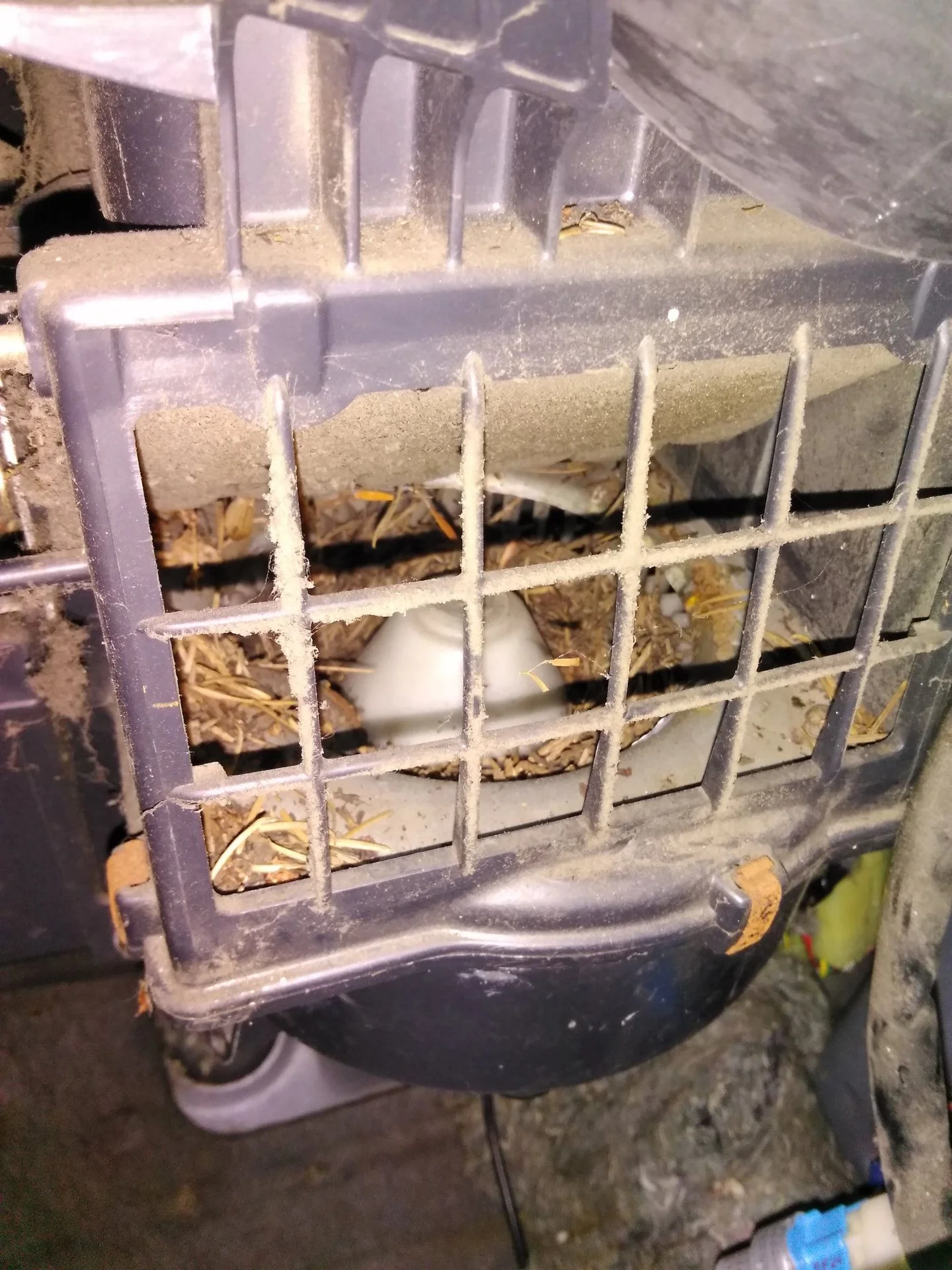

I would be very surprised if anything is blocking the fins. Both my heater cores were perfectly clean/clear, even though the rest of the system was plugged. See the attached picture of one of my fans.

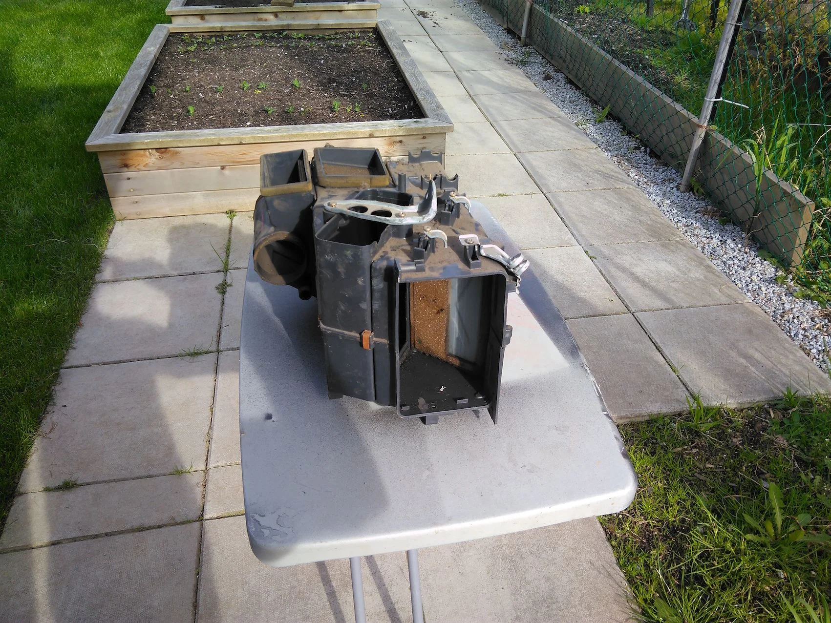

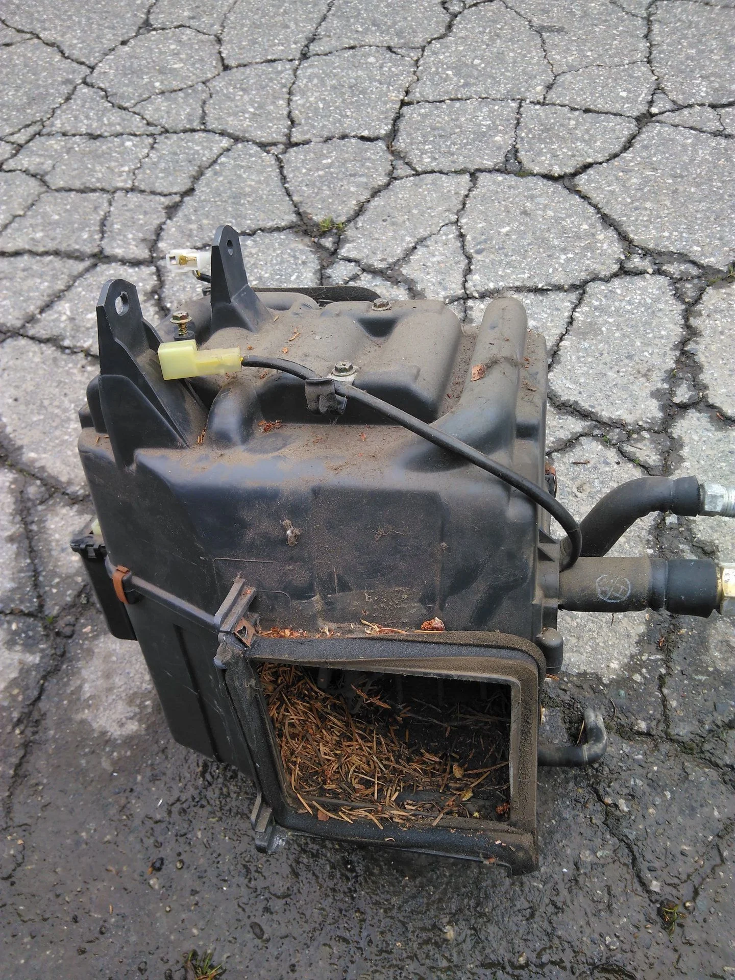

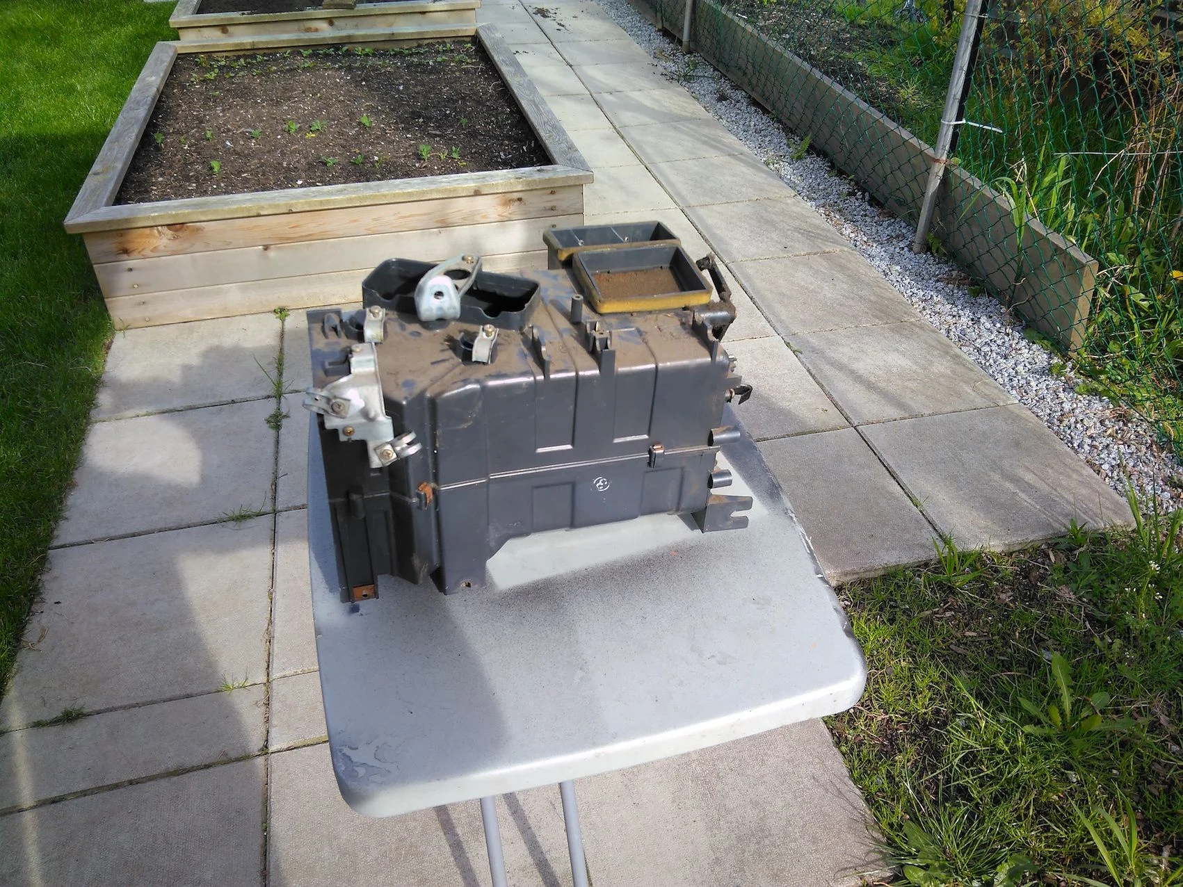

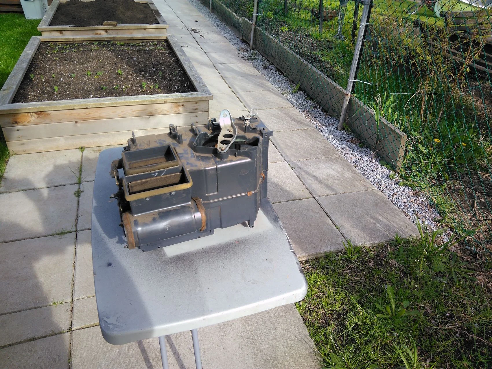

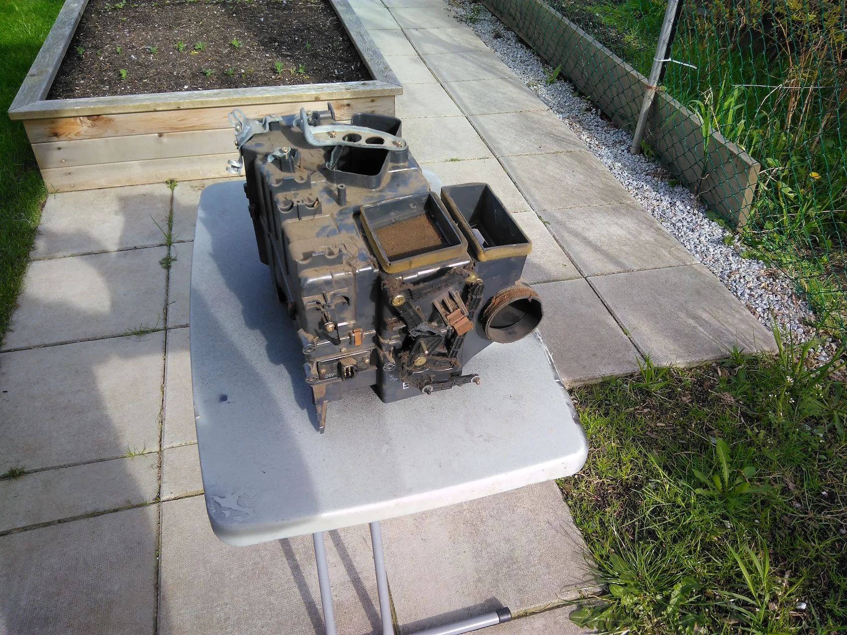

Most of the junk gets caught either in the fan itself, or the AC evaporator. Maybe check the function of the flap doors to make sure air is being directed over the heater core. I attached some pictures of the heater core box too.
