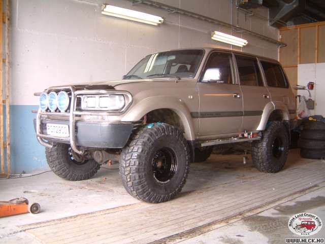

neowulf said:
37/13,5-15 pro-comp x-terrain,works great
works great.

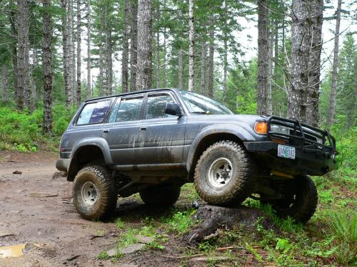

Sitting in Driveway
Poser shot

I live in kirkenes and i get most of my oil from russia (1/4 of the price it would be in norway)
(Diesel are now at 1,5$/liitre in norway)
Oh and it's a slee lift , i have searched the internett and caled and mailed arond the world for some time before setteling on the slee kit and for those of you that want a bolt-on kit this is probably the best lift you will find.
:cheers:
