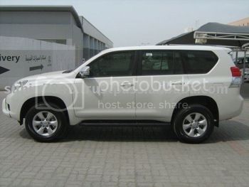

Too bad Lexus doesn't sell the Prado rocker panels domestically for even quicker parts swaps for slider additions... color matched a bonus.
