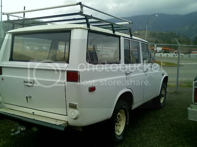

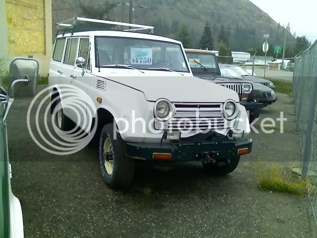

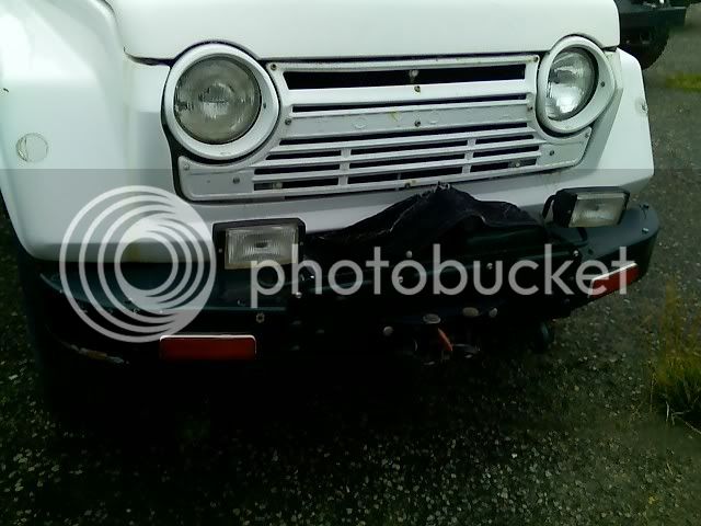

OK...so went back and had a closer look. Floors look clean. Only found one bit of bondo (rear drivers panel- behind fuel filler). Interior is pretty much clean with the exception of the cheesy front buckets someone put in. The Steering box is shot for sure and needs a new battery and/or have the charging system checked.(wouldn't start- so no test drive). Got a couple picks for those that asked. Can anyone tell me if that roof carrier and those bumpers are original? oh yeah....it has a winch as well
Roofrack and bumpers are definitely not factory. Nor are the grill hold-down screws. Is that a manual rear window? More pics please.
x2 station21...........looks a lot better than the frightful thing I bought:frown:, it shows some TLC; also.......... that is a nice looking front bumper + winch:D.........do you know the history?; you might check underneath and look at the frame to body supports......examine the roof line and gutters well.agree with Pighead.......that looks like a manual rear tailgate......out of OZ?? ghetto made?; it does not have the license plate depression of a US spec vehicle that I am familiar with............ was the depression for the license covered over? would be nice to open the rear tailgate inspection plate and see what is there?; any comments from OZ members or anyone with first hand knowledge of manual tailgates:cheers:

I'm thinking that I will probably buy it, but I'm trying to track down some parts and info first. The underside and frame are super clean. The roof gutters and roof look pretty decent as well. Don't have much info on the rig, and as it is at a used car lot I doubt I'll get much more. As for the tailgate, I'm not sure. Were the US spec trucks different than the Canadian ones? This one has Toyota stamped into the metal right between the lights so I'm thinking its factory. There is actually a bracket and light for the license plate on the rear bumper just above the tow hitch.
