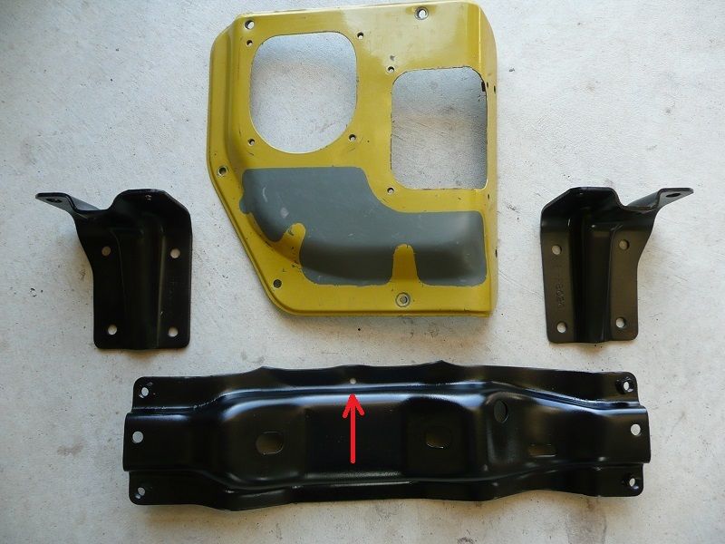

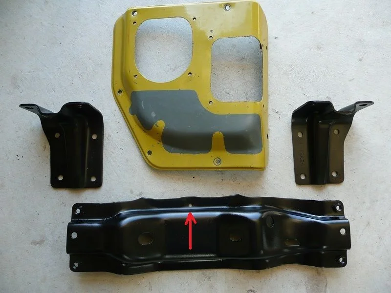

I'd be interested to know what gear box crossmember the BJ45 use?...If your existing crossmember has the drain hole on the front edge as indicated by the red arrow in the pic below you have a 5 speed compatible crossmember.

I'd be interested to know what gear box crossmember the BJ45 uses?...If your existing crossmember has the drain hole on the front edge as indicated by the red arrow in the pic below you have a 5 speed compatible crossmember.
My guess the L brackets will be the same as the FJ45. Would have to double check but pretty sure my FJ45 L brackets have the FB stamped in them just like the short/mid wheel base does. For what ever reason the HJ47 has a different one.
