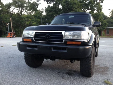

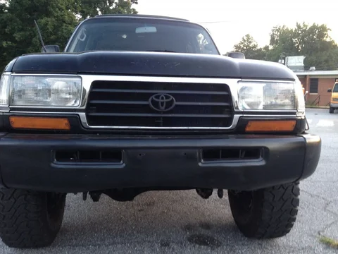

I decided to change the grill look. The Satoshi grill is a little too much for my taste so I went with a mellower look. I cut out the smaller "slats" and then fiberglassed the holes and put some metal screen behind it. I am happy with the result.

Changed the grill and added a 60 series Toyota emblem. Wasn't sure if I liked it at first but its growing on me.

Can you provide a "how-to" on that grill? Looks good man.
