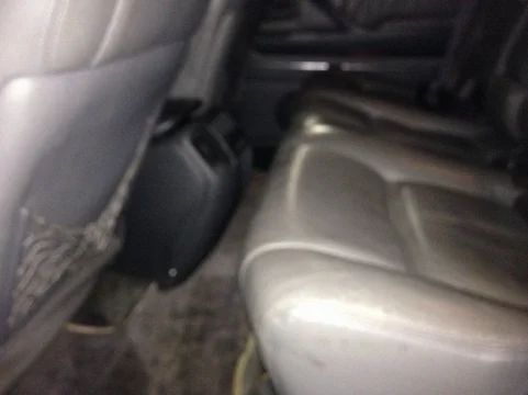

Look's like you've found what I' been looking for! Could you post some pics of it from the 2nd row? I have tall kids and can't afford to lose much leg room.
Here are the pictures from the 2nd row. It almost makes the middle seating in the 2nd row unusable. So it won't work for people that need all 3 spots.
Probably won't work for me. But, it does look pretty good. Thanks for the pics.
