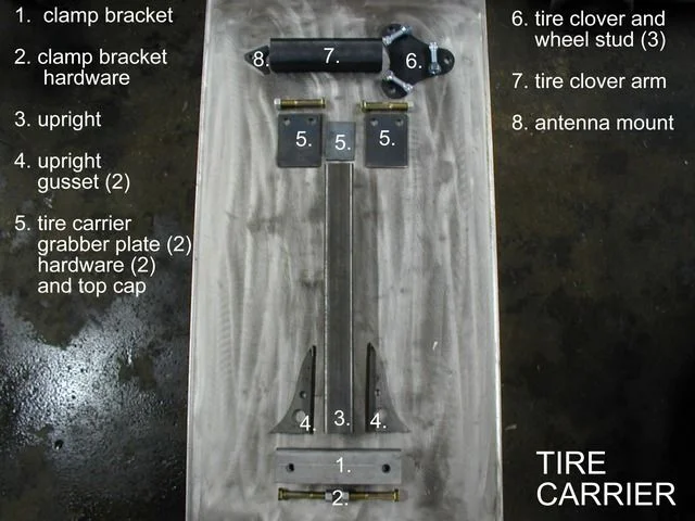

pretty sweet instructions Luke. Thanks.
So I guess I didn't need to add in those 2 pieces of rebar. I thought those gussetts were a part of the carrier. I'll add them in and integrate them with the rebar pieces.

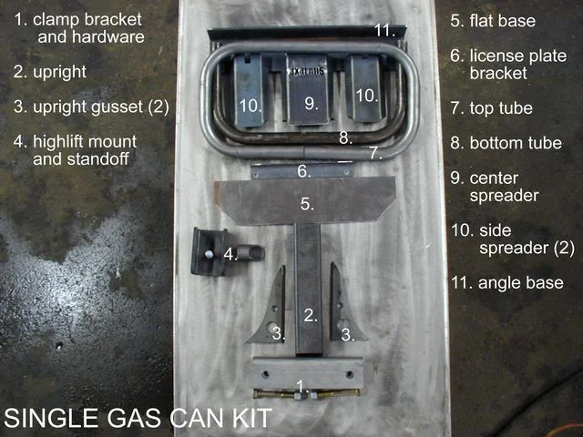

Alvin and I finished 85% of his bumper today. All we have left is to finish the gas can carrier and tire carrier. The shell, spindles and arms are on there.
For those of you who haven't started, I have only one real suggestion. It might me easier to drill and tap the holes for the gas strut mounts prior to welding in the spindle. It is no big deal to wait, but with the spindle in place you will have to use a crescent wrench or the like to tap as the spindle will be in the way.
We are thinking that it will take us about 4 full days to complete mine including the rattle can.

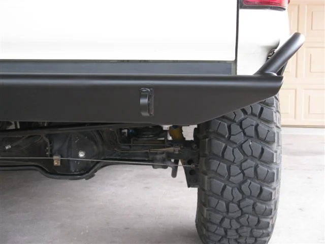

Hey guys from australia, im making a copy of a 4x4 labs bar coz unfortionatly thier cost prohibitive to import and dont sell them here.
the other factor is due to legal issues i cant realy cut out the rear cross member.
so basicly ive done a bit of a no no and cut 4 inches of the rear rails and moved the factory cross member back, ill just hope it dosnt get picked up on lol.
so basicly my designs differnt but simmilar, slightly less angle on the rear of the bar.
what i basicly want to know is some mesurements of the lenth across the back of the bar from center of the hitch reciever to the outter most point of the back frame.
so far ive done it all off pictures i can find and its provong to be a bit of a headache but im gtting there, before i cut the angles these mesurements would be fantastic help.
