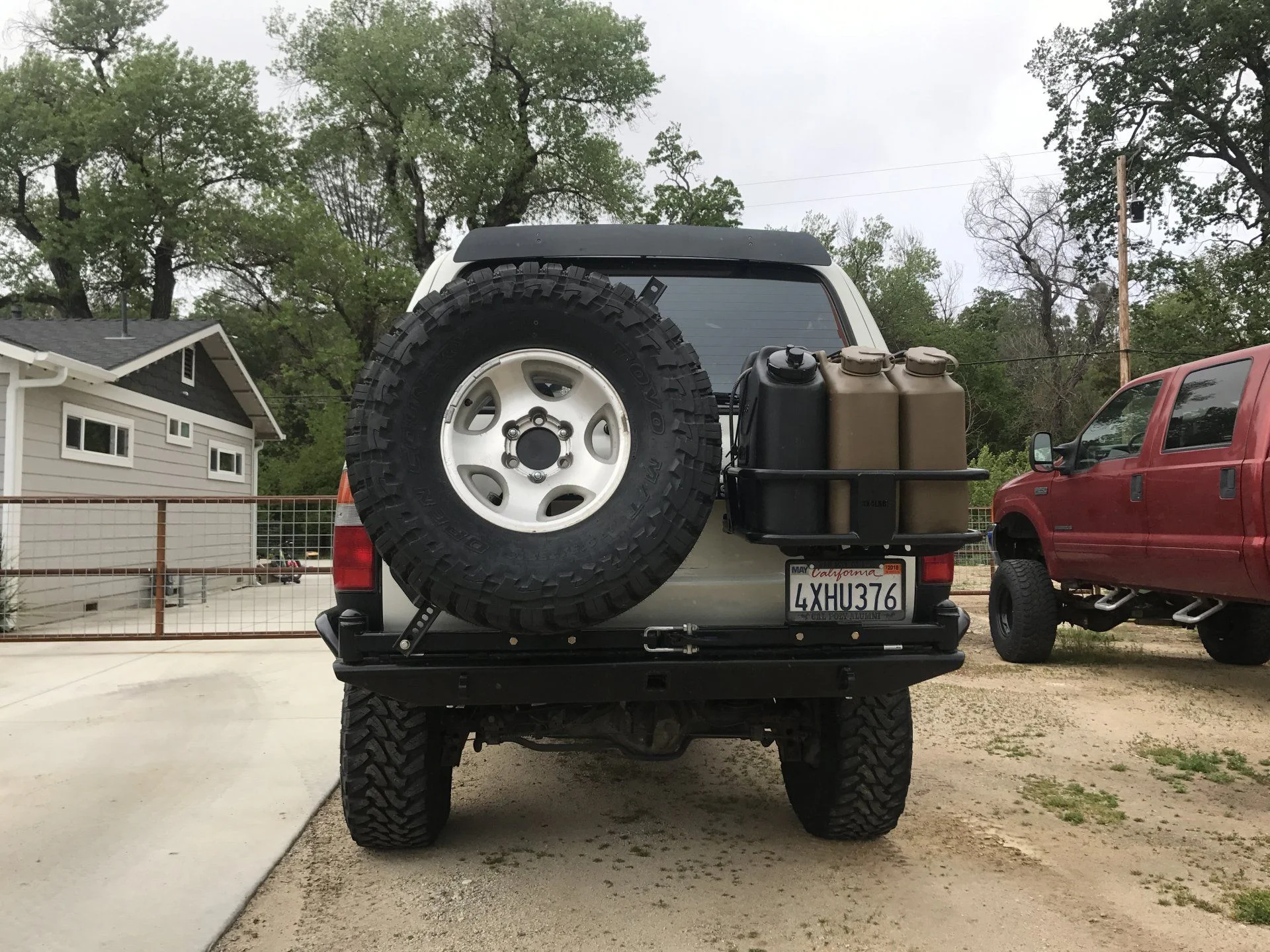

I have this exact setup as shown in the above photo on my '97 80... All in all I have to say it works well, but the spare tire gets into a sympathetic resonance vibration at highway speeds on concrete road with seams and gets the tire mount wiggling front to back about half an inch or more. It makes the ride pretty uncomfortable when it happens and depending on traffic speeding up or down isn't always feasible or safe. It doesn't happen on smooth asphalt highways, and offroad who cares, any vibration is lost in the noise... I have called and spoken with HD @ 4x4Labs about the vibration and he says it's the first he's heard of it. Nevertheless the vibration has been a topic of discussion on other forums here in mud. Ted has the CBI bumper on his 4runner which is more stout and a better design in my opinion with fold out table options, but alas CBI doesn't appear to make a bumper for the 80 series.
That is interesting regarding the vibes. I have that bumper but without the can carrier and have zero issues with vibes. I carry my bike on the spare tire quite often. How tight are the latch clamps? Mine are very tight. I use my foot to latch it.
Frank
Frank
My latch is very tight; same as you, I use my foot to latch it and it's damn hard to unlatch by hand. I have had the latch stops coated with several layers of duct tape to prevent rattling on rough roads. 'HD' at 4x4Labs recommended against metal on metal here and using a piece of thick rubber glued to the bumper stop (he said he used a piece of sidewall cut out of a tire and glued it on with PL500). I cleaned off all the tape muck and added a 1/16" piece of silicone rubber glued on with E6000, but nothing really sticks to the silicone so it's not really stuck and I'll update that soon.
That almost sounds like a manufacturing tolerance issue. For example, that tab to which the gates rest when latch isn't in the right place so that the gates are pressing tightly against it when latched. Maybe one of these days we can measure our bumpers and see if there is a difference.
Well, good feedback either way.
Frank
An additional link on the topic - Like others have mentioned, I do like my 4x4Labs bumper and believe it to be among the best out there, but there is room for improvement or modification.
I wonder if something like this would help. McMaster-Carr
I was going to install some on mine.
Frank
I think the vibrations can largely be attributed to the fact that the swing arm and tire “post” have no real trussing to the point of creating a great enough degree of triangulation. A square tube welded to a square tube just allows for flex. On the concrete sections of highway, ours experiences front to rear vibration, but I don’t feel as if there’s anything noticeable side to side.
Ours has no rattles though. I keep the stops greased to avoid squeaks, but that’s about it.
I don't have any side to side vibration either and agree with regard to the lack of trussing or reinforcement on the tire mount being the root of the problem. It's interesting that some people experience it and others seem not to. Basically you've got a 100+ pound mass at the end of a 2 foot arm attached at a right angle to an unsupported 3 foot arm and held only by the swing bearing at the far end. My guess is the 200 foot-pound torque on the 3 foot long 2" square tubing is sufficient to cause the 1/2" tire deflection once the resonance is triggered. I can wallop the tire with my fist and get it going by hand. I suspect adding something wedged between the tire and the truck body (hatch or tailgate) to dampen the vibration and prevent the resonance will be sufficient to mitigate the problem, but it'll take some experimentation.
