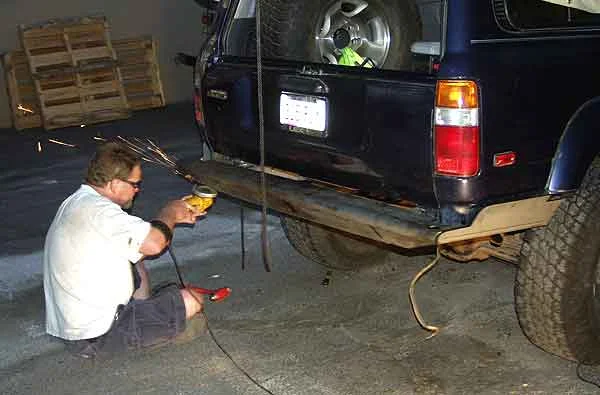

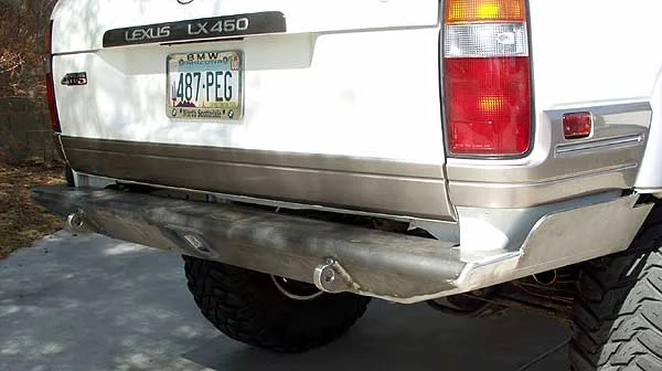

Didn't get out of there till 1AM, didn't shoot pix, so here are a few daylight ones. Big thanks to Phil for stopping by to help.:cool: All of the structure on mine is done, just needs the side tubes. Rob got a late start, his wings and crossbar are welded and ground, we are going to try to get the receiver and recovery parts in one night this week and the swing next Sat.

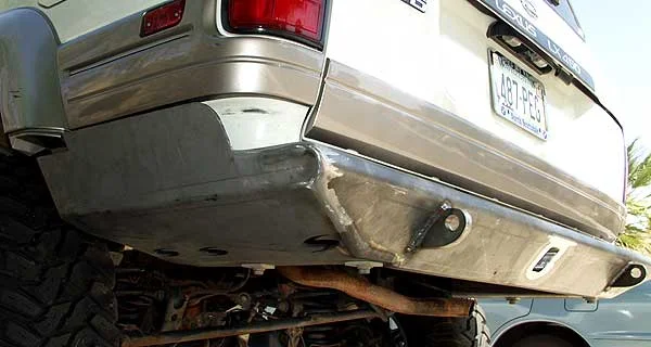

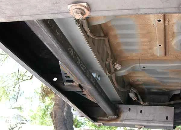

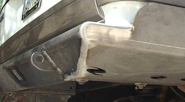

On mine the frame rails were a little narrow, had to move the recovery points slightly closer together and shorten the receiver support tube. Very happy with the kit, very little grinding, fitting needed to make the parts fit and the resulting bumper is way :cool:! What a great project, lots of work, but very rewarding, Thanks Luke!:cheers:

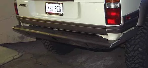

Mine is the poverty pack, plain bar, so there is a gap between the bumper and bottom of the tailgate, allowing a view of the trucks underwear. With a swing it wouldn't be noticeable, looking at putting a filler panel to clean it up.
Also looking at putting some mount tabs on the front of the wings to hold mud flaps and possibly trim the stock plastic panels to fit, cleaning up the fender wells and reducing the mud and debris that get into the wing area.

Finished the welding on our bumpers Saturday. There still naked, may go to Moab that way.:eek: Rob's swing out went together well, looks good, but the single swing arm is long!:D

The powder coat looks good and the license plate light is all wired up and working.
