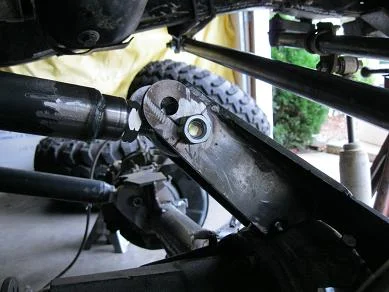

Even though the numbers I posted looked good, there was still soem room for improvement. After discussing it with Brian, we decided to drill a new hole in the axle side upper link bracket to lower the upper link an inch and get more straight double stuff. I also cut about 3/16" off the bottom of the frame side upper link mount and lowered it to the furthest front and inboarded point...Results are:
1) Ground to hub on double stuff = 22 1/4 (1 1/4" gain)
2) Bump pad to frame = 2" ( 1" gain)
I think I have now squezed every last inch out of this thing...
.....drill a new hole in the axle side upper link bracket to lower the upper link an inch and get more straight double stuff. I also cut about 3/16" off the bottom of the frame side upper link mount and lowered it to the furthest front and inboarded point...Results are:
I'm curious - what does your pinion angle looks like now after drilling the axle side upper link bracket?
attachment.php
Exactly like Oreo's! Surprised it took so long for someone to point it out.:)
