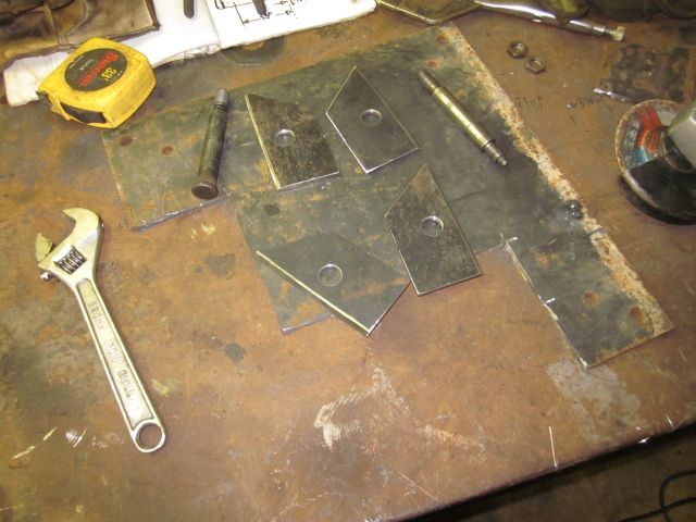

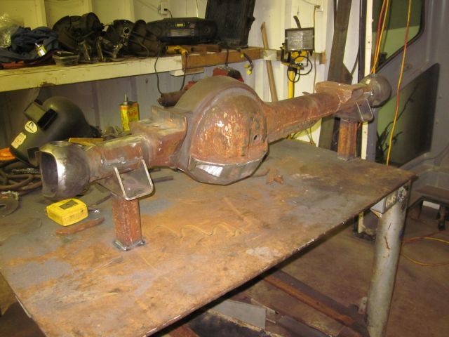

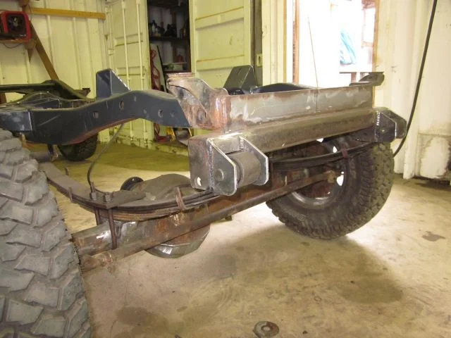

New rear spring perches tacked into place with hybrid packs. Dropped the frame height another 3 inches, about what i wanted. Woohoo!! Once weight is back on i'll plate the frame and find a rear hanger location. Wheelbase and wheelwells will be moved back about 8-9 inches, never did like the rear overhang on Runners!

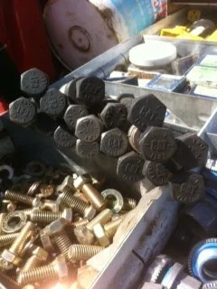

Needed some proper diameter bolts for the spring eyes, so my heavy duty mechanic buddy on this shovel i'm working on filled my hands with 4,5, and 6" bolts. Gotta love free "CAT" bolts of any sort!!!

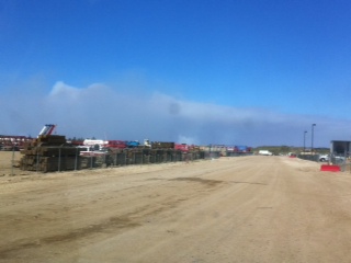

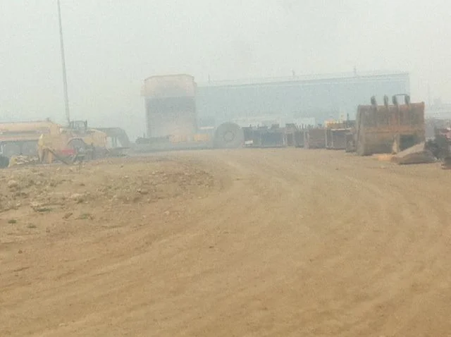

Also got called out for a service call north of Ft.Mac, only to see some of the devastating fires burning right now!!

Re-drilled a couple springs in the packs to better flatten them on the perches. Looks like it'll give me about a 7-8 inch wheelbase increase. I never was much of a fan of the bobbed mini-truck/4runners losing the interior length, chopping the top to fit. Less drag in the rear also. It only means bodywork and moving the wheelwells back. Cam, i've got a job for you!:grinpimp:

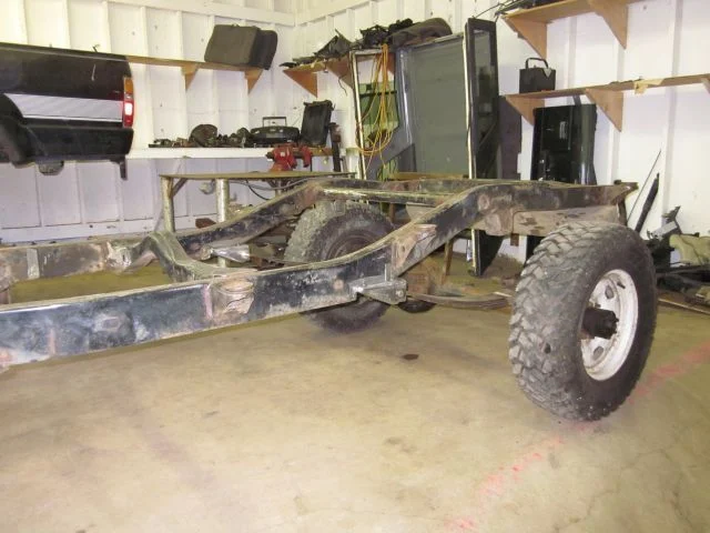

Kind of quiet around here these days, so i guess i'll put up some pics. Put a few hours in at the shop, decided to make some changes to the front hanger and keep the existing mounts for comparison.
Cut out the old ones, made some new mounts and tacked em' in.

your portside front body mount made me do a double take there...:lol:
Looking good tho, that the use you were thinking of for those ruffstuff ones of mine?
Impressive progress all things considered, I figgered all your spare time would be spent getting fitted for leg irons and manacles....:flipoff2:
Yeah it's deceiving in that photo, was from the original "IFS be-gone" chopping.
Yeah pretty much, I forgot to get em from you that day...
Lol, I chose to forgo the manacles in exchange for credit card and bank account access! Oh well!!!

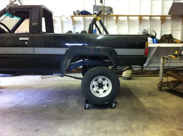

Threw the body back on today to see where the cut and paste wheelwells were going to be. Got almost 8" towards the back, trying to keep interior cargo space, lessen the overhang and the typical rear chop. Looks like a job for "slowandsteady" and his mad body work skills! LOL:hillbilly:
