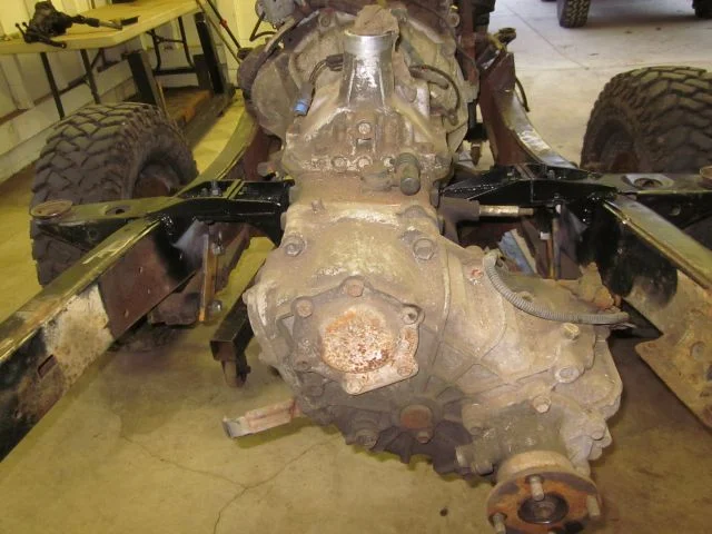

Got this x-member tacked today, had to go up and over to clear the driveshaft, shackles were in the way, t-case linkage needed room, exhaust etc... Got captive nuts so it'll drop straight out and bolt horizontally from the top as well, leaving room to pull the complete trans out with the motor if needed without interference.
Intersting design for the cross member, how will the tranny be dropped if you need to pull it?

Here's why you can't use a stock cruiser x-member and the stock Runner/minitruck is about a foot and a half back. Shackles in the way, t-case linkage and driveshaft leave little room between the rails. Next pic shows how it drops out, bolts vertically and horizontally across.
