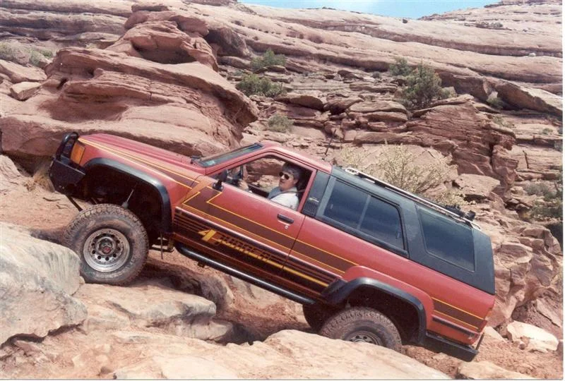

attachment.php
Here are my extend a fenders. They still look great and I've been running them for 4 years now. They use self tapping screws to install. Just remove the wheels and have a helper hold them in place while you operate the drill.
Brian
Thanks. That's a great looking 4Runner. I'm going with the OME lift and 31" BFG MT's, so mine won't be quite as tall. I'm guessing you have 3 or 4 inches under yours.
The photo helped. If you happen to be around your rig with a camera I would love to see a close up of where you trimmed the rock guard. I assume you just put the flare up in place and traced a line on the rock guard and then cut it?
Thanks Kevin. Doesn't look like there's much, if any, gap where the extend-a-fender overlaps the rock guard. Maybe I'll try them.

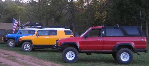

Here's my "before pic". The after pics are scheduled for August!
