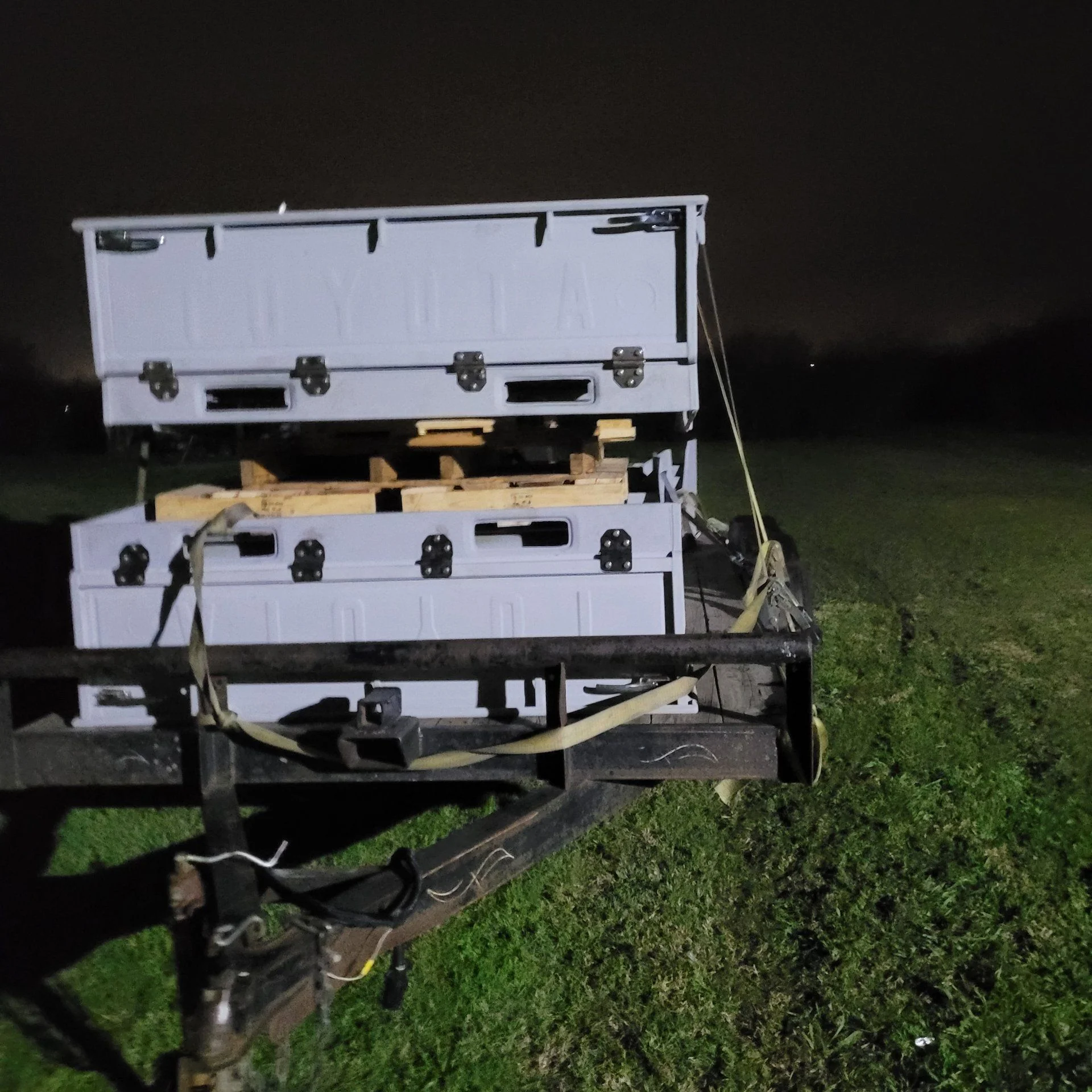

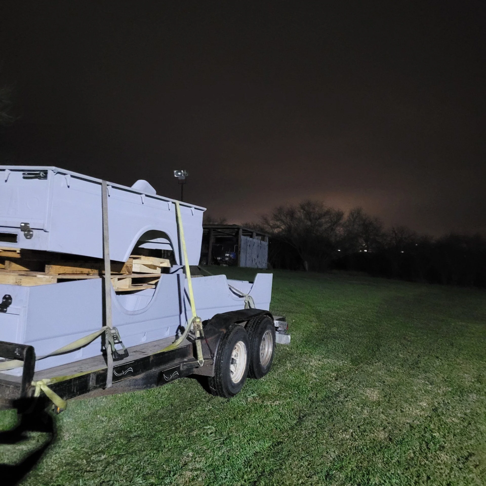

Christmas came early this year. Thanks a bunch
love the “dead of night” pics - adds to the drama 😂
