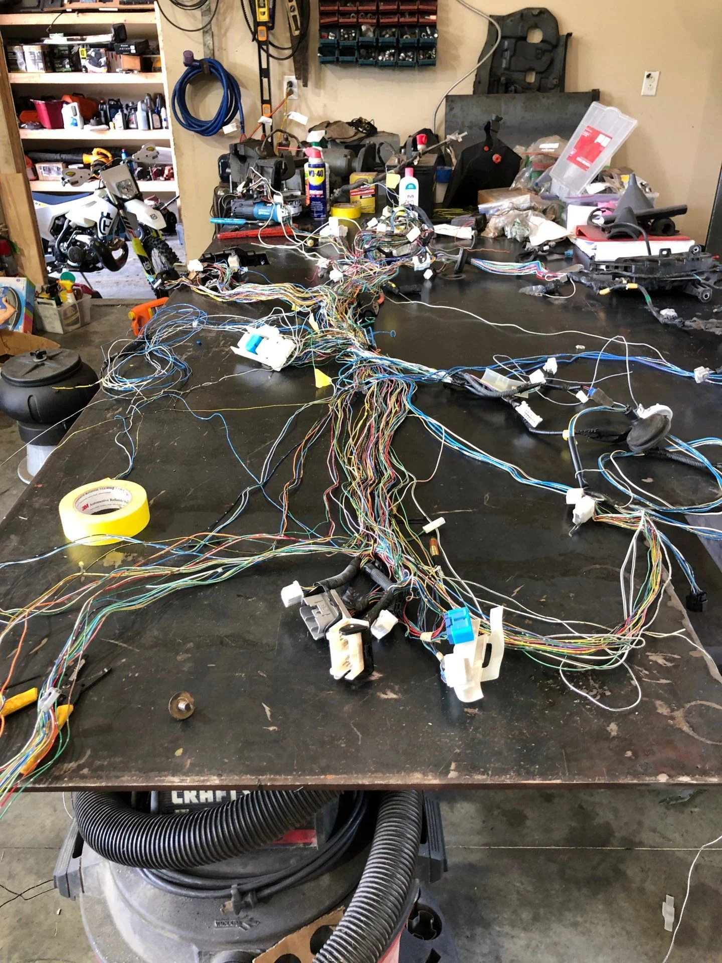

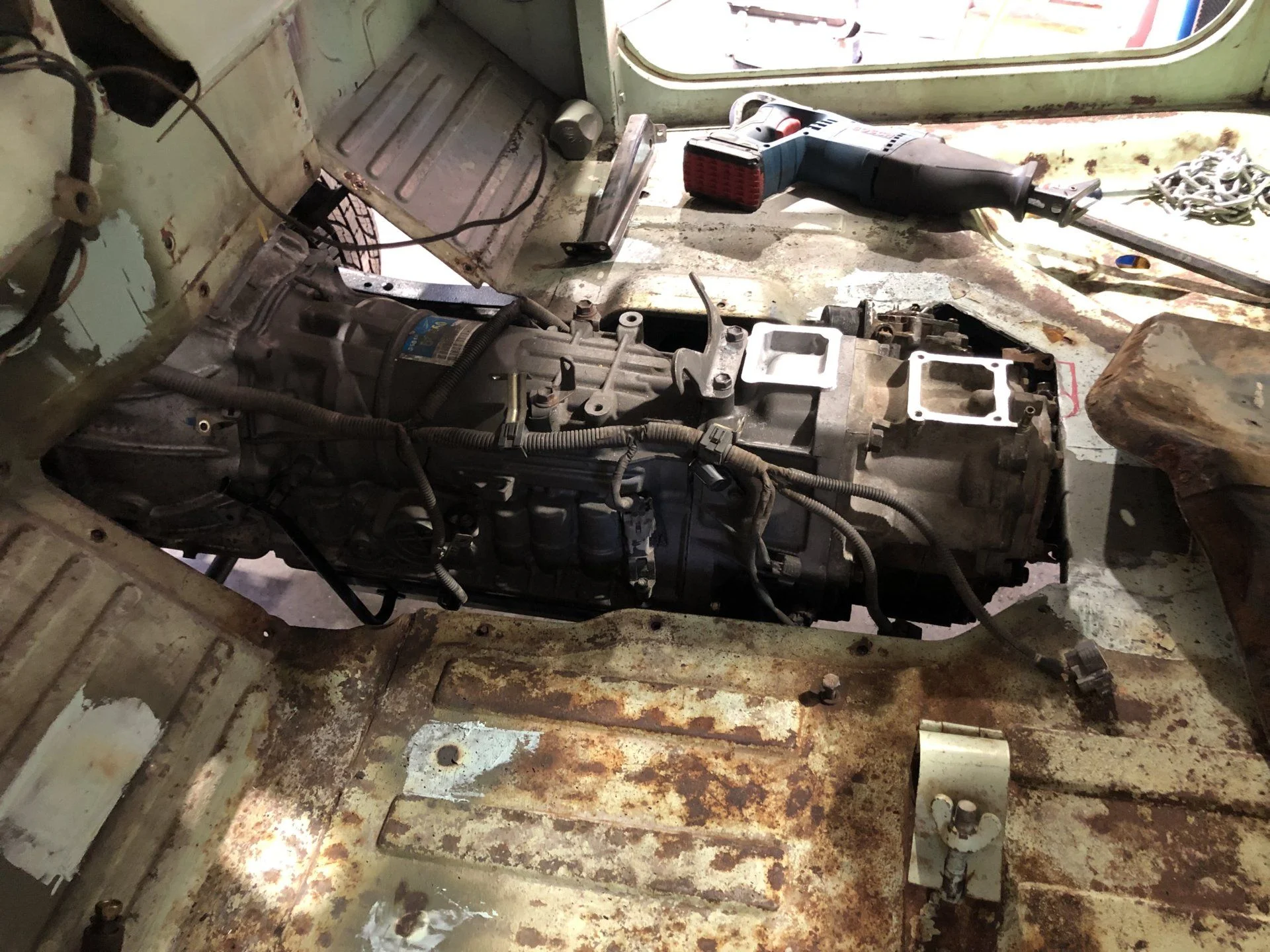

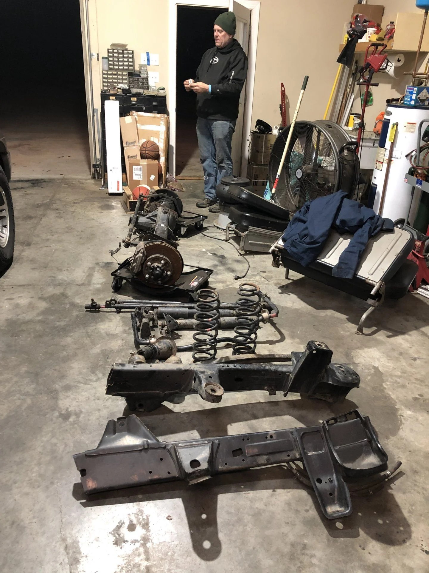

So slight change of plans, @dogfishlake showed up last night with this
1914809

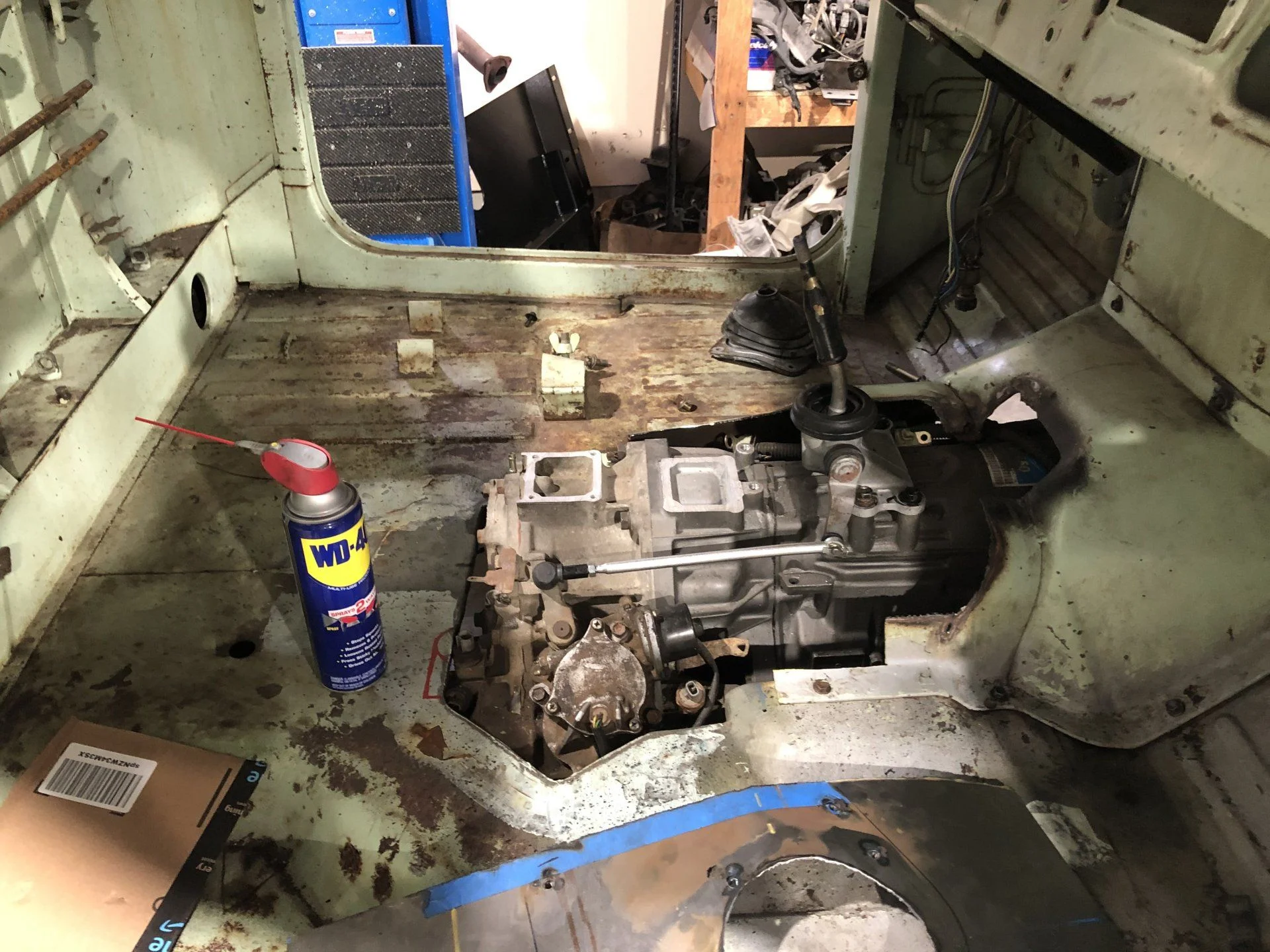

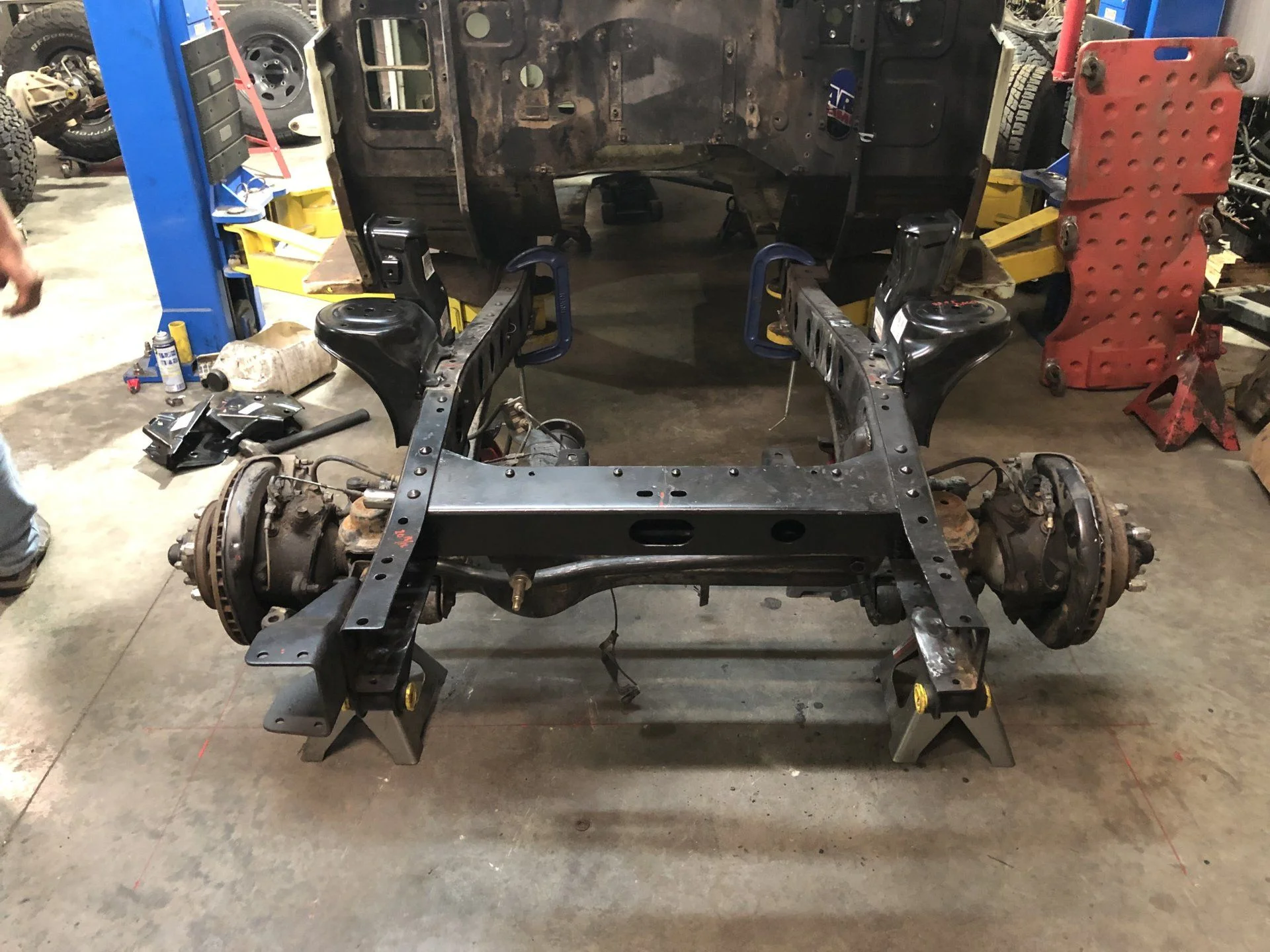

So I have decided to go back with the 2uz awd set now that I have a 70 series front coil end. I know it will be a bit more work but I think it will be a nice driver

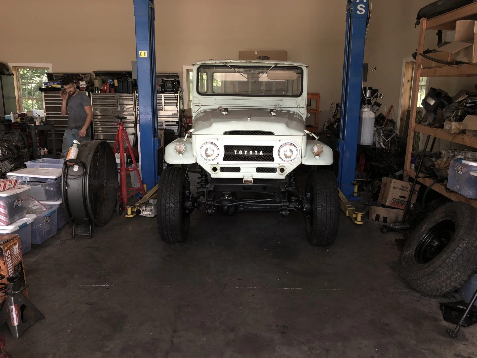

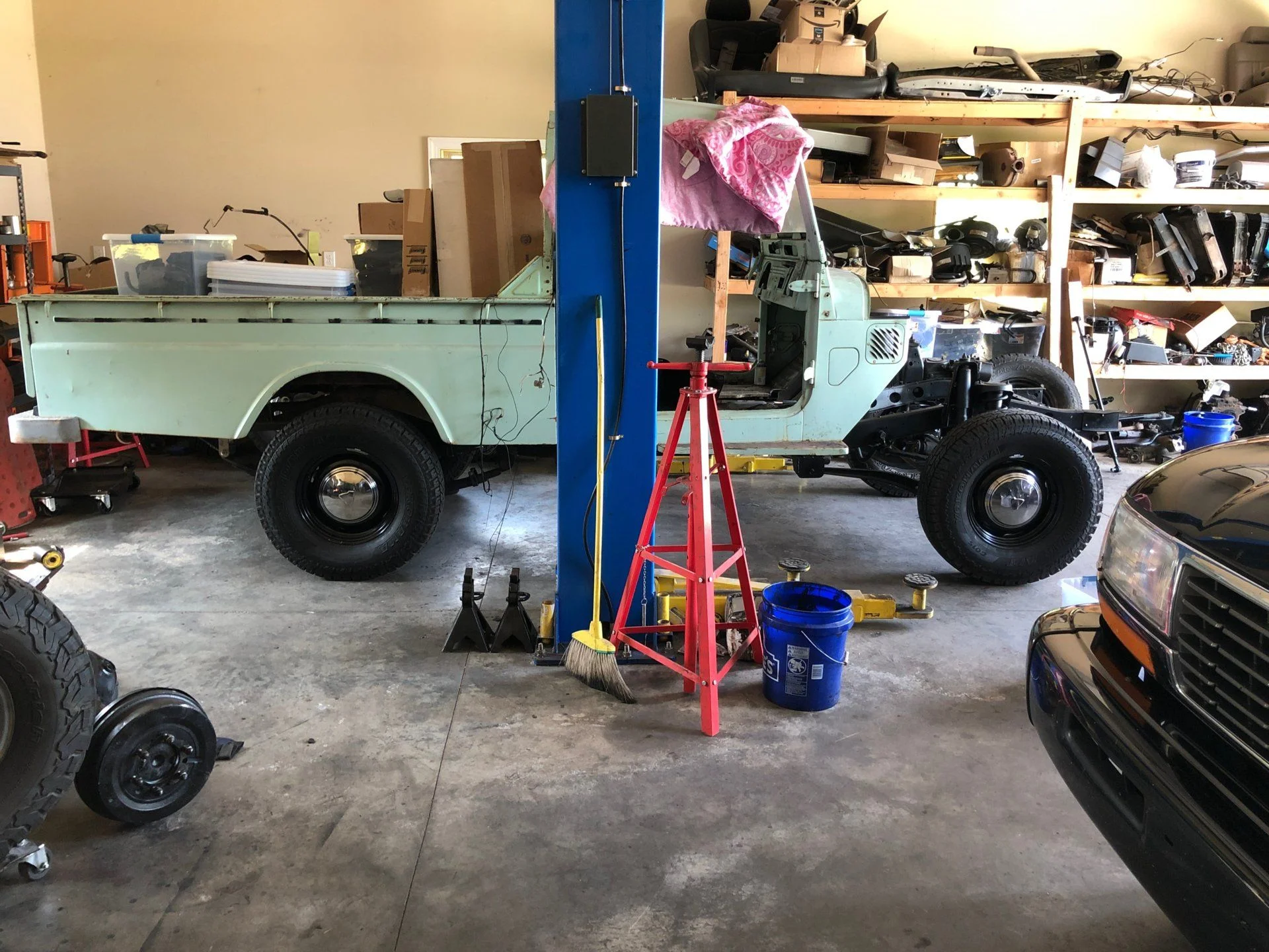

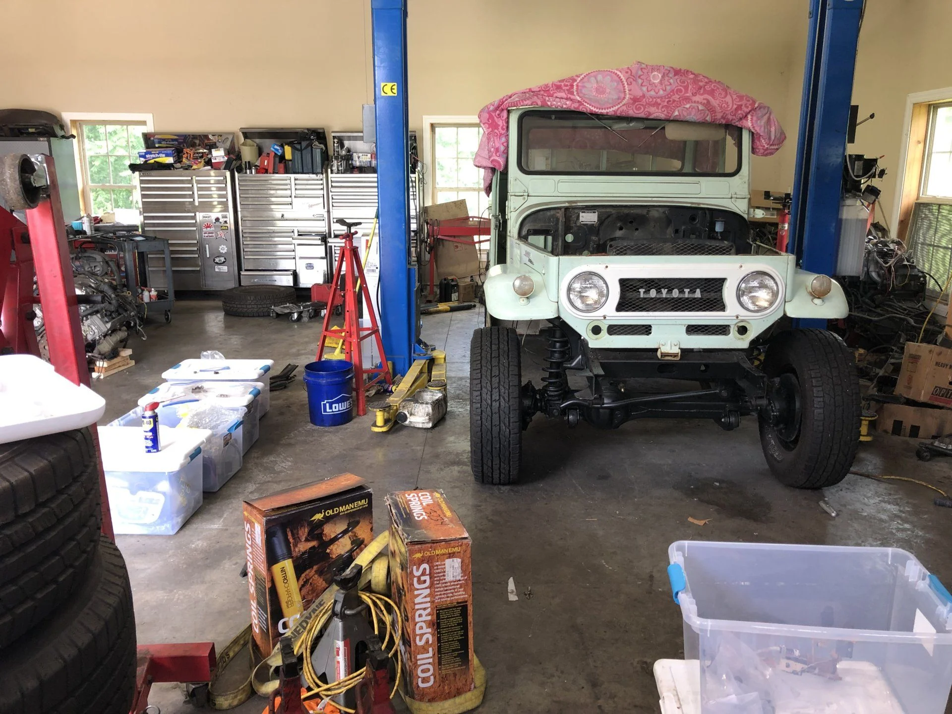

Finishing up the 81 40 1hz forty. Then I will get the front axel mounted and engine set. Then it will be transported to @ddelong6767 to finish. The hope is to get it into sema.

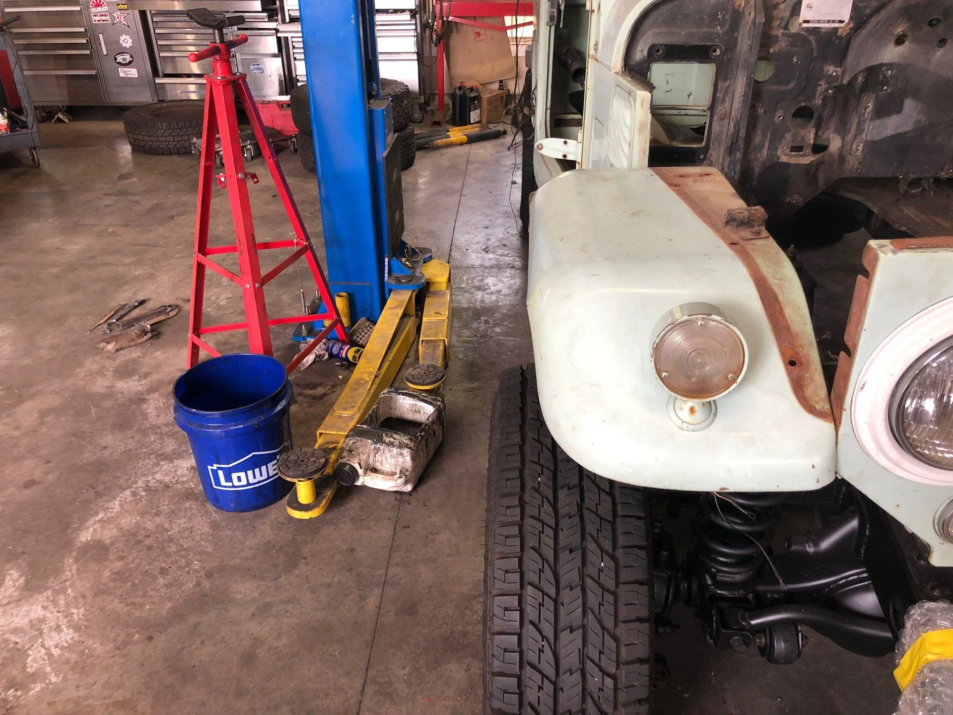

I really like how it’s sits, I think the front will stick out past the fenders a bit, but I like these city racer wheels so I think I will roll with it.
Like the tie-die hippie canopy! Awesome job!!!

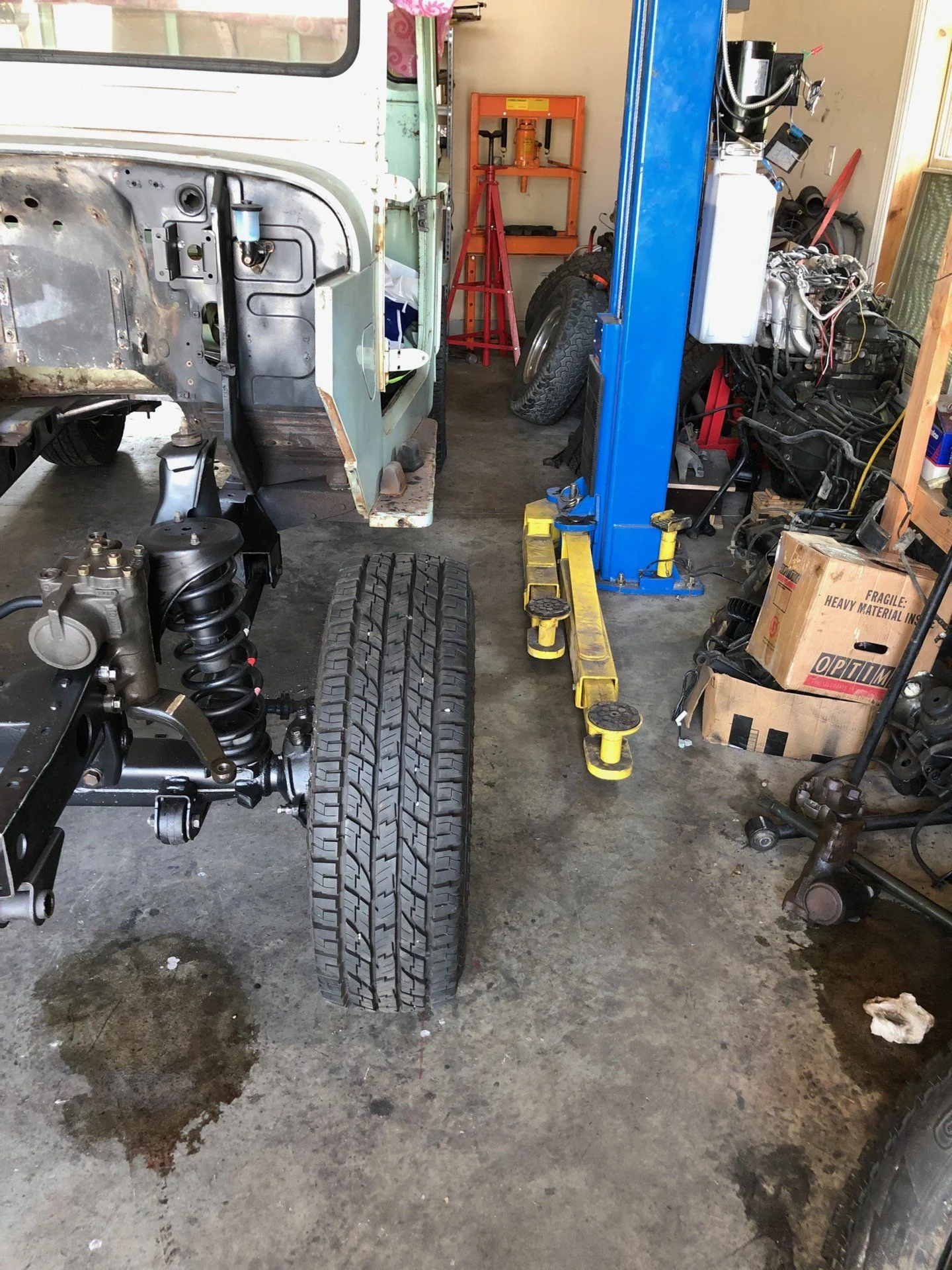

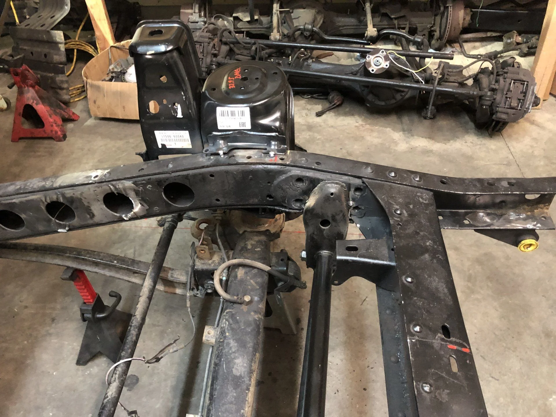

The 70 series front axle you used has the same suspension as an 80 series but narrower? Any differences between the two? What is the wms of the 70 series axle?
I plans to do the same thing on my 45 but I was going to narrow and 80 from axle.
Nice work!
I’m using a 70 series front 61” and 62 rear 58”, 80 series are 63.5” front and 62” rear. Those are wheel wheel to wheel mounting surfaces.

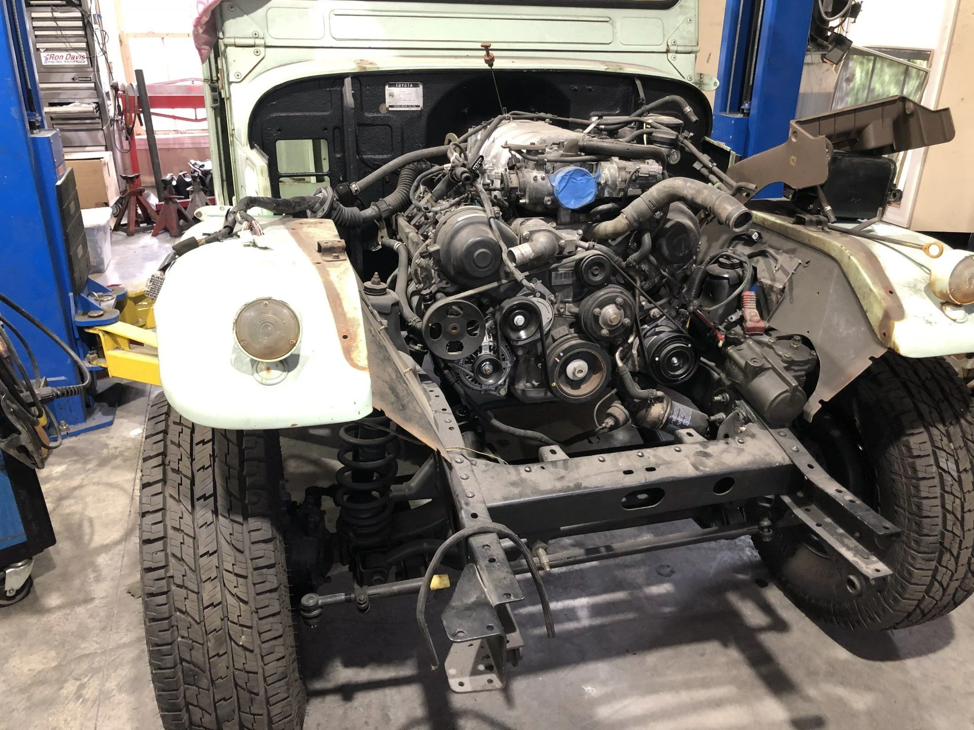

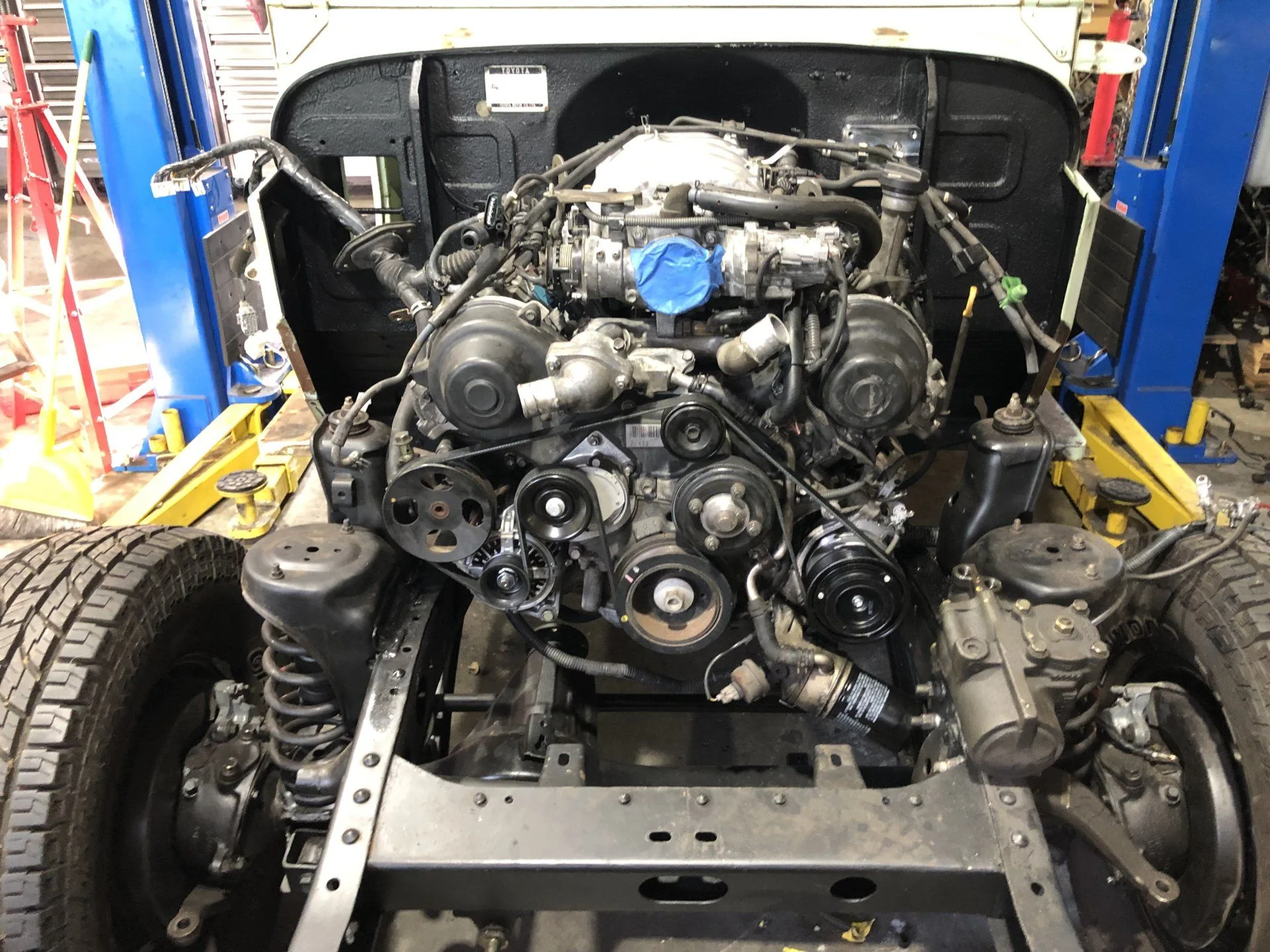

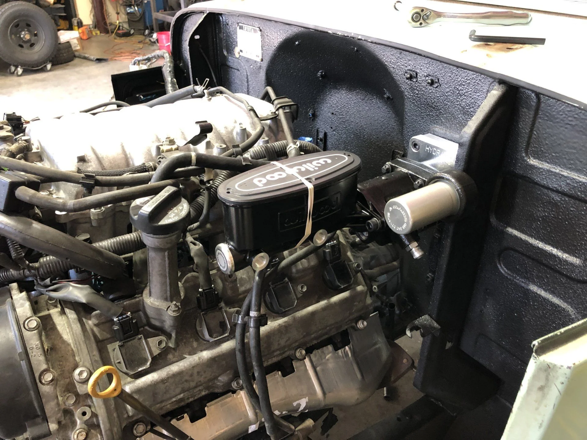

Hydroboost for the win. Can that oil filter be relocated? It looks pretty inconvenient where it is. Do you have engine mounts done yet?
I have been thinking through this same issue with fuel filter. I have been considering using the Ford oil filter racing adapter. It redirects the filter 90 degrees, so I think you could aim the oil filter back under the compressor.
Are the front spring bucket mounts any different that the 80 series mounts? Do they hold the spring out farther from the frame?
Thank you for paving the way for my build :D
Did you convert the front axle to 6 stud?

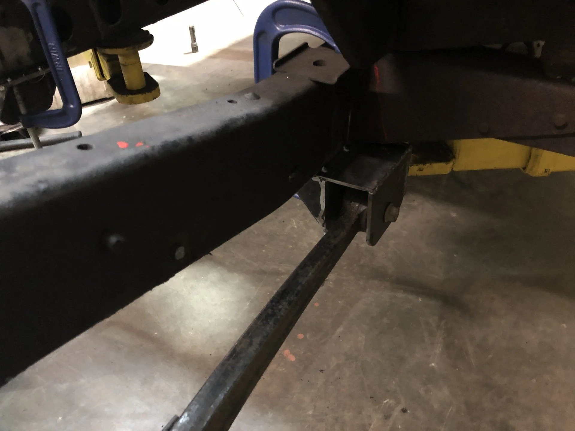

Is there any interference between the steering box [looks to be 60 series?] and the panhard rod?
Lastly, do you think there would be any issue with flipping the panhard rod left to right and installing it 'backwards' for a RHD rig?

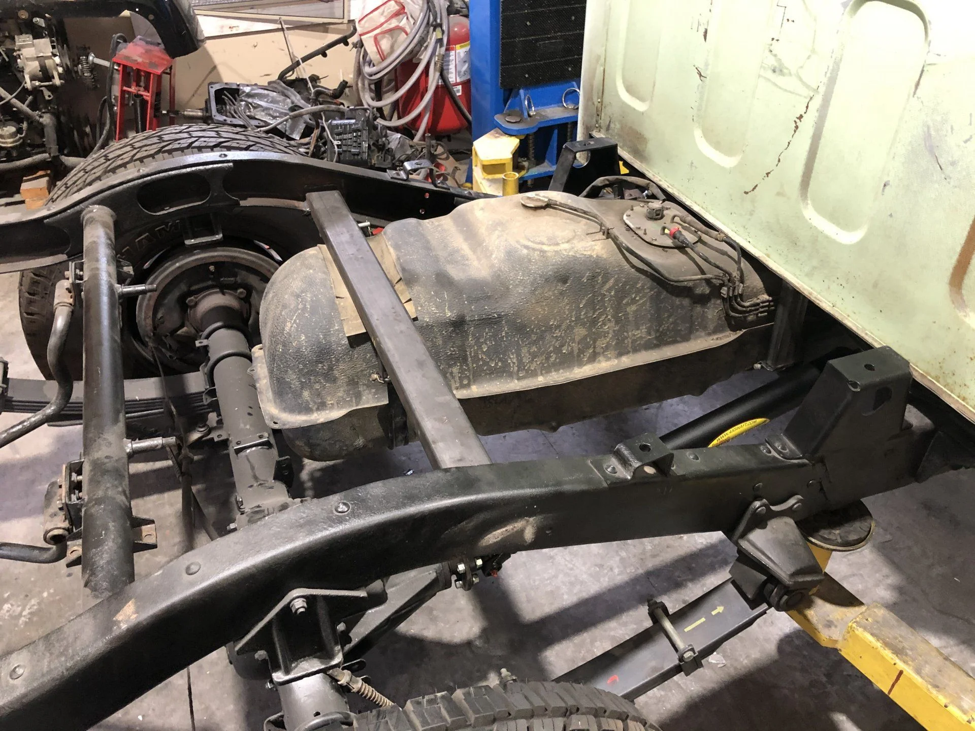

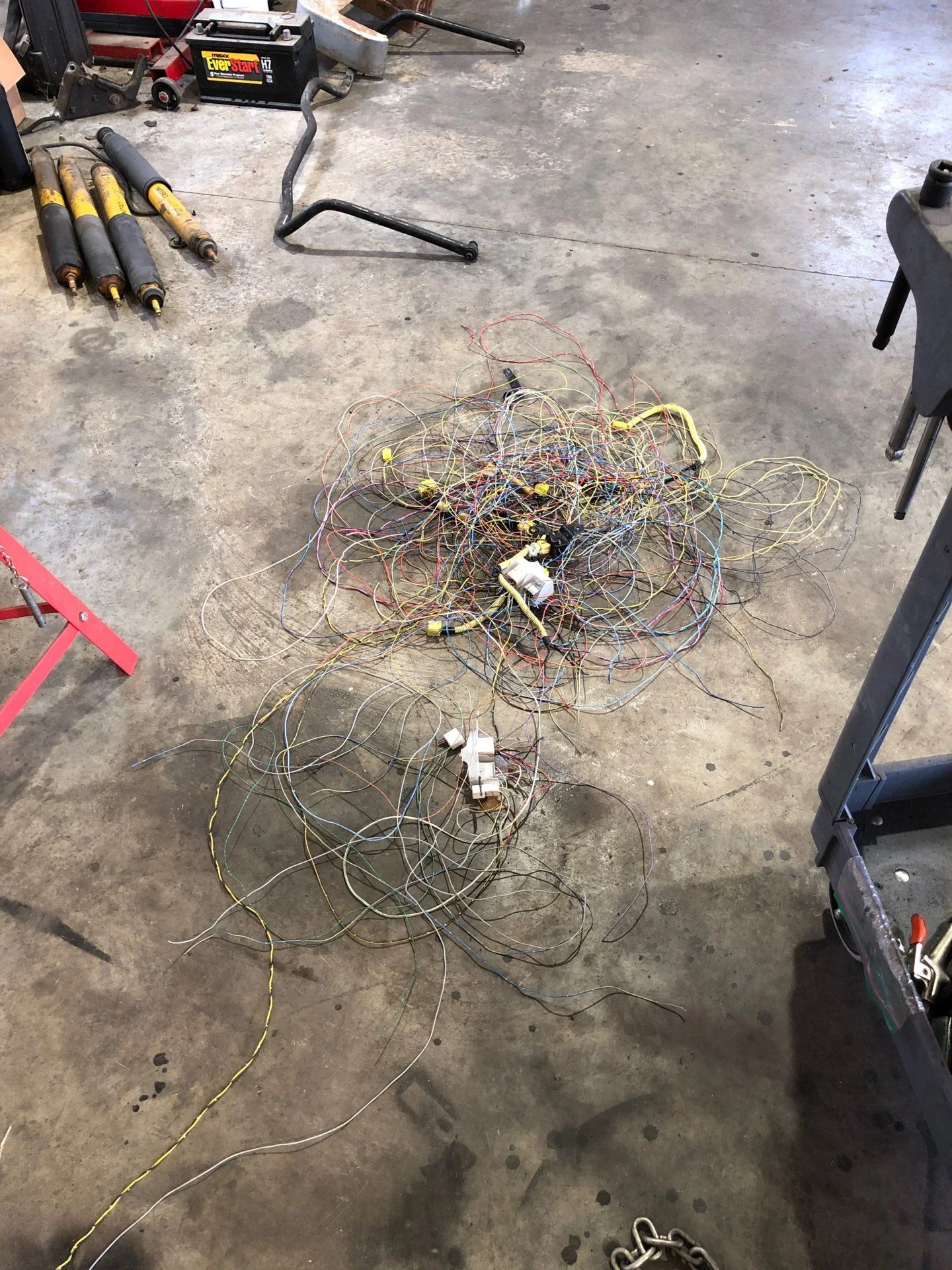

Back at it last one to be finished in shop, hope to be driving in a month or so. Tundra tank mounted and working finishing center console
