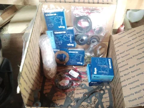

Transfer case rebuild!!!!
You seem more excited about it than I am...
