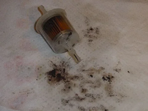

Hey guys, went out and purchased a clear filter like Rudi posted up. I unhooked the old filter and I could not believe the junk that came out of it. Put the clear filter on and we are up and running past 40-45mph without the sputtering, hesitation and stalling. So now comes the task of draining and cleaning the gas tank. Thanks for all your input. Steve
Hi Steve,

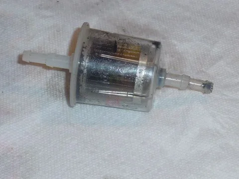

Do you have a pic of the dirt that came out?
Here is one of mine. It's not only dirt and rust from the tank. It's also dirt from the gas station and water from filling up in the rain.
