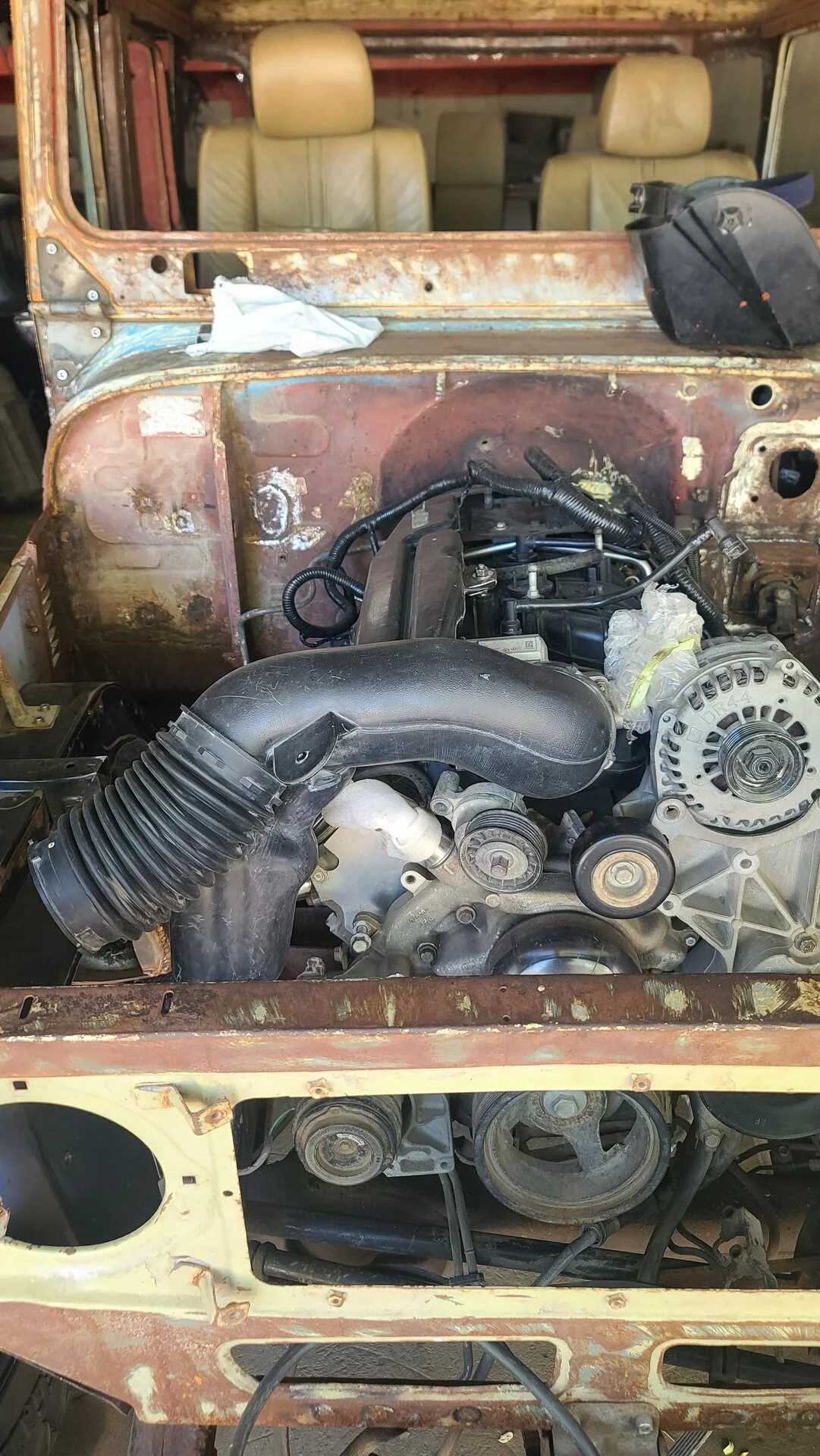

Guys, i have a question for the Ls gurus here. I had my harness reworked by this guy who owns a company called : Lsxharnesses.com.
Thing came back much smaller than it originally was. Looks ok . Other than the fact that the alternator wire is a tad too short and have found no plug for the a/c compressor. Shouldn't i also find a plug for my gas pedal ? The donor truck is a 2009 Suburban 6.liter and is fly by wire. Heck.... i found a plug for the throttle body.
I also have 2 black outside / purple inside plugs.
Only found a spot for one around the crank pulie, which tells me that this might be the crank position sensor bit i can't find wher the other one shoud go for the life of me. I sure am glad that i tried this thing on now. Also wondering whether i should also have a plug for the shifter since the 6l90e is electronically controlled.
Thanks in advance for any help and advice.

Here are some pics of the oil cooler, the oe air intake and of the truck as it looks today.

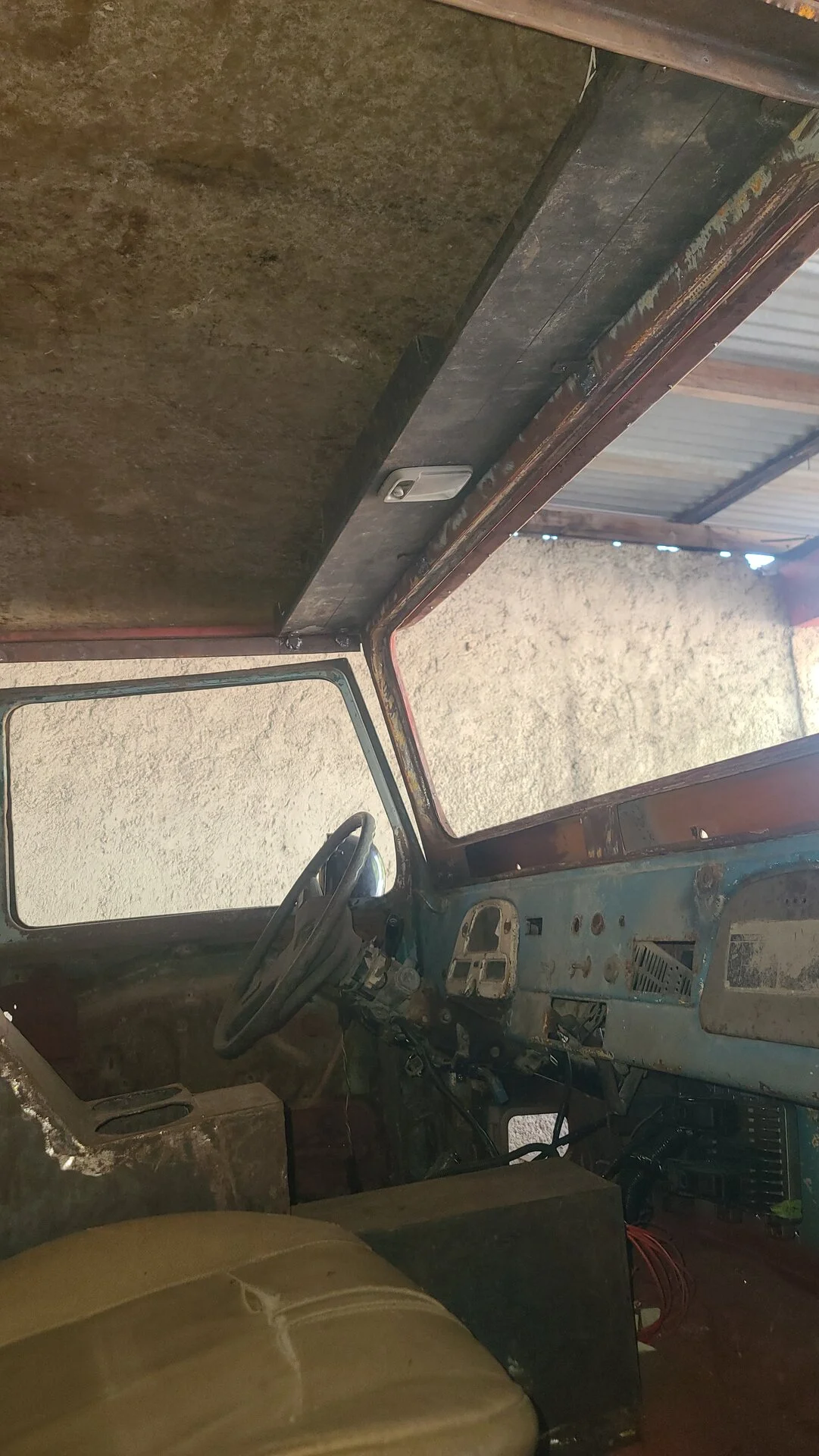

We decided to install an overhead shelf . Built that fast . Again , in this build , space is no problem and this will be huge for keeping things well organized.
Sun visors and rear vew mirror will still be usable in their original spots

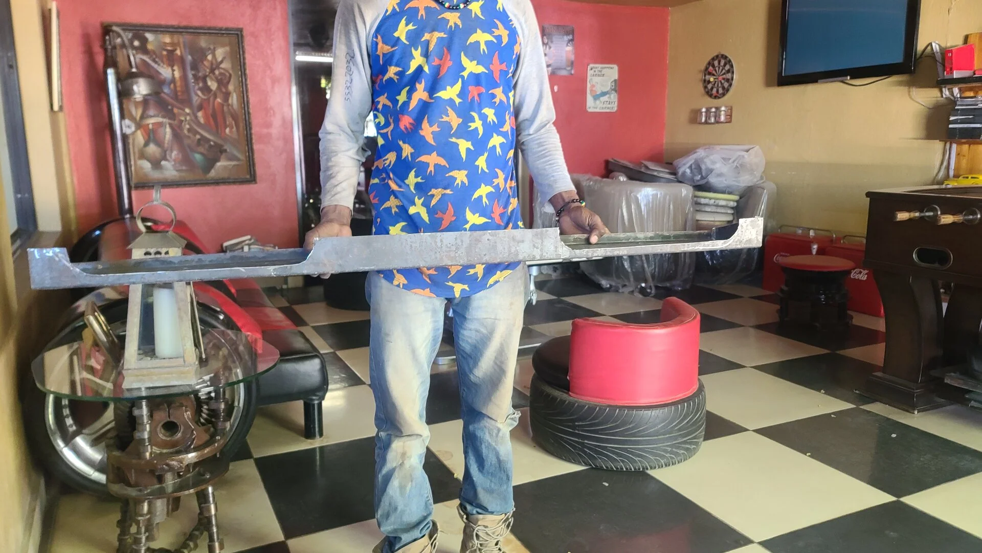

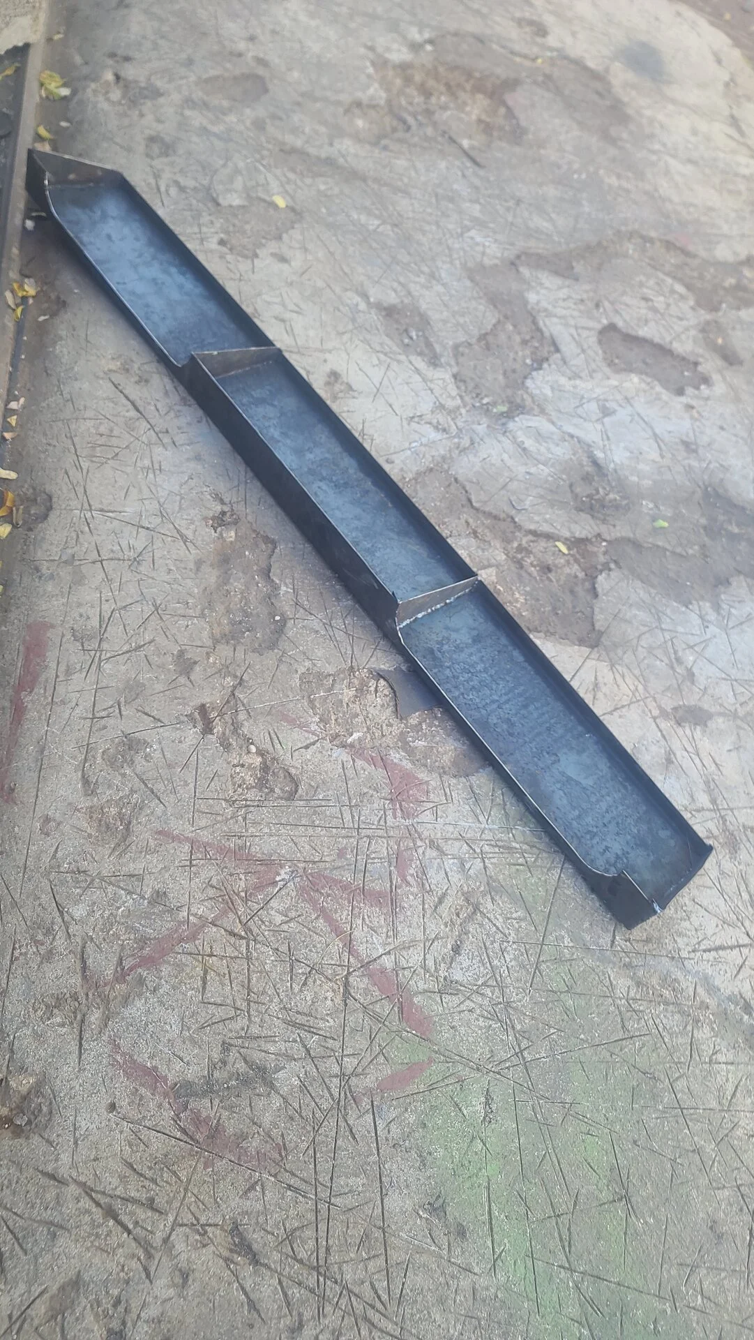

Built out of 16 gauge sheetmetal. It features separate storage compartments for the driver and the passeger. The space in the center can acomodate a cb unit, a stereo or anything else.
I will line the bottom of it with rubber to prevent objects from sliding from one side to the other, or from falling on me while driving.

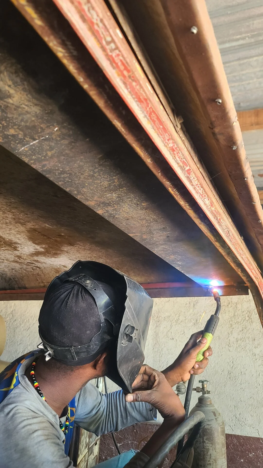

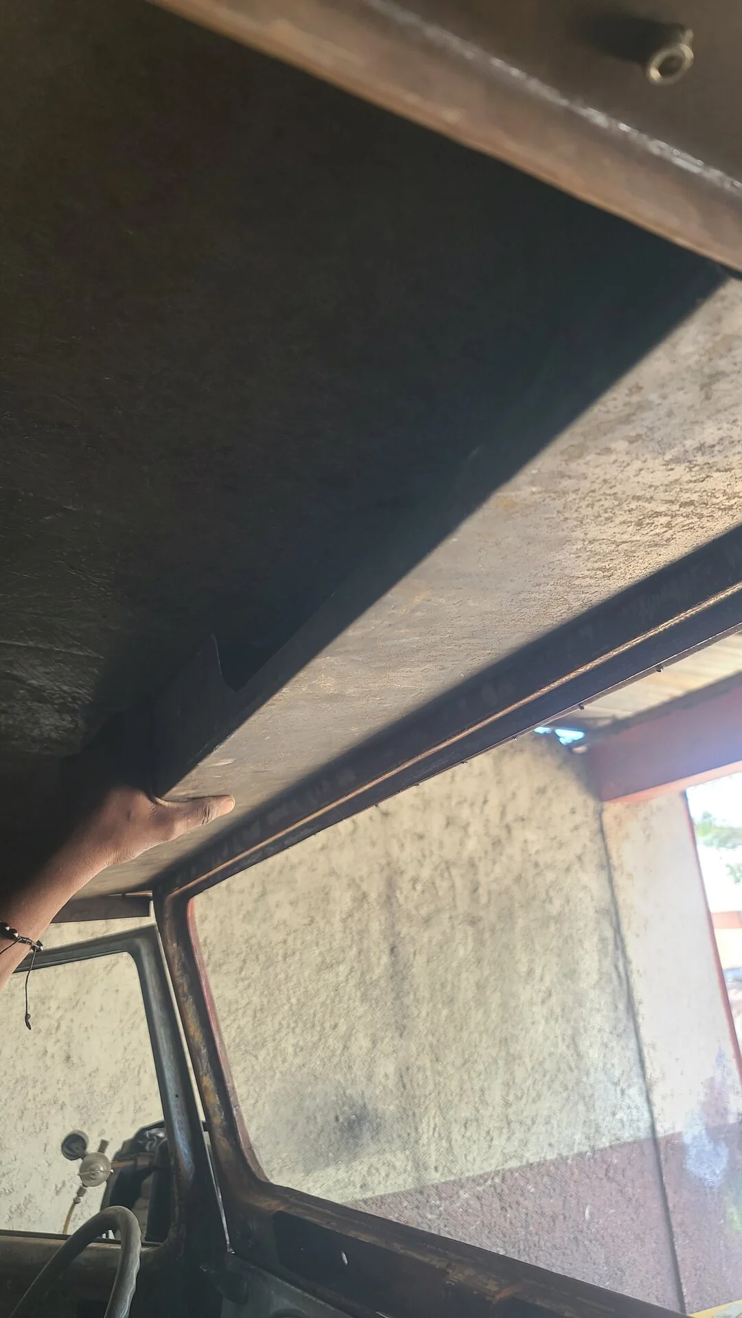

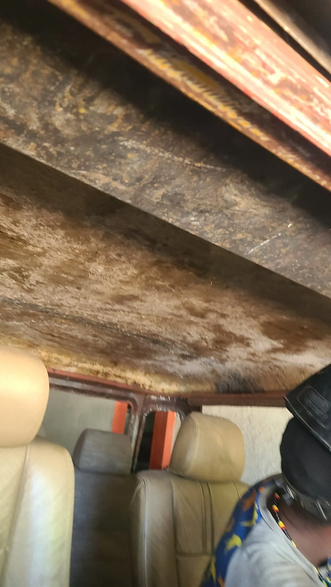

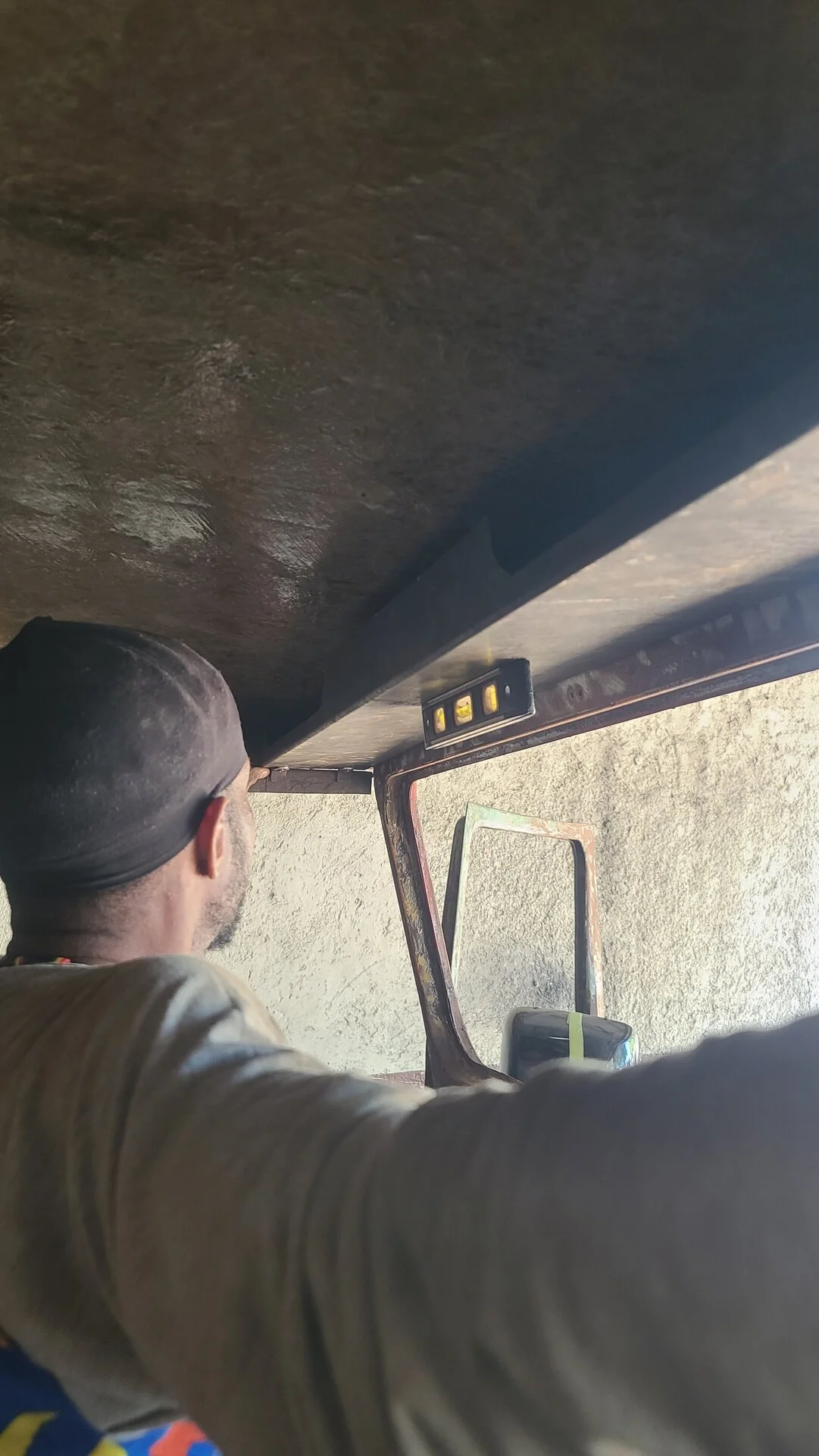

Ok. The overhead shelf is pretty much done . Mounting tabs are installed. Two on the passenger side, two on the driver's . Two more are welded on the inner side of the windshield frame.
I only need to decide whether i 'll paint it or have it covered with the same material we'll use to line the roof liner.

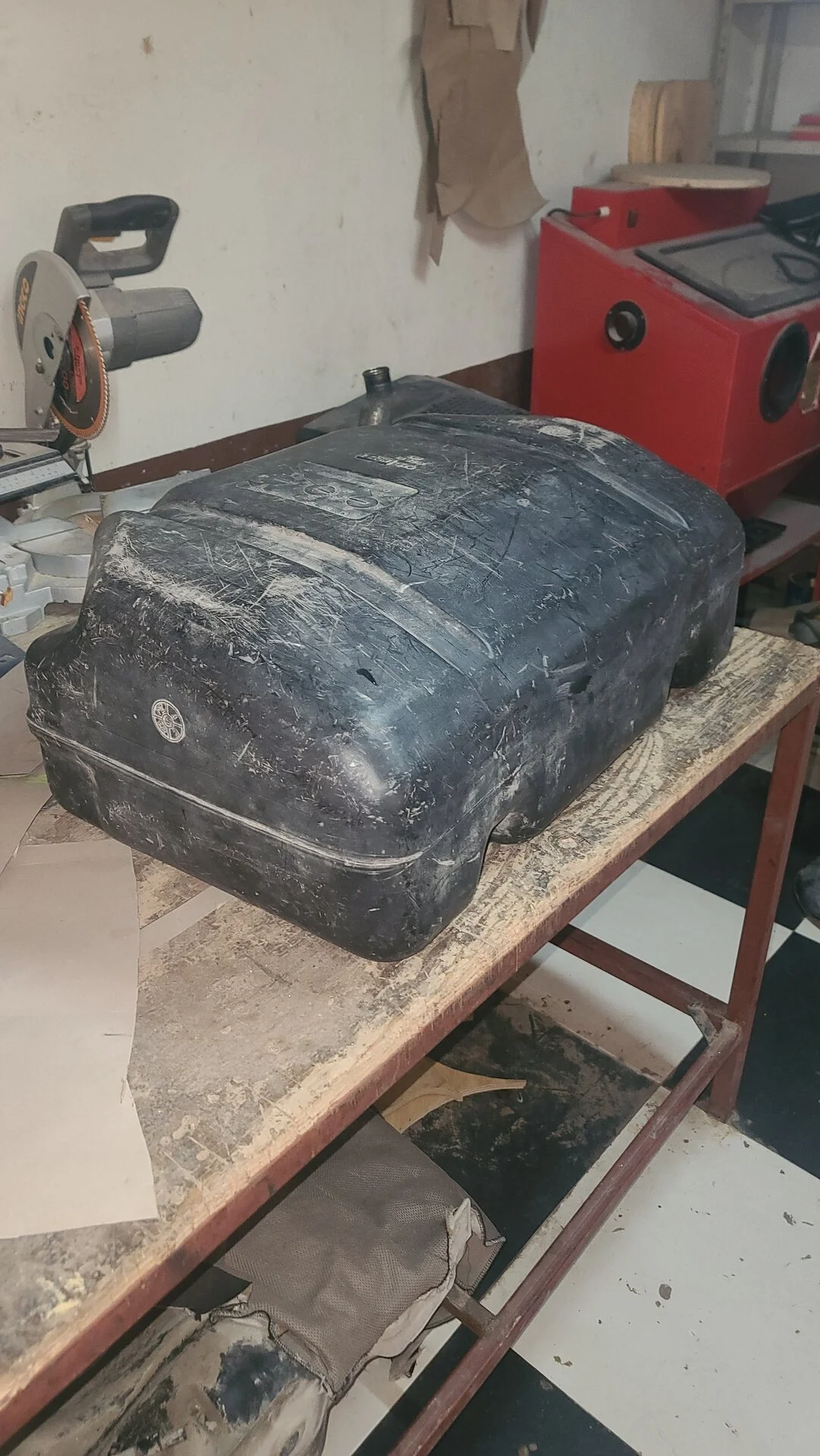

Today we got to work on the fuel tank. I had mentioned way back that i was considering using a Range Rover plastic tank as a primary and a '93 Corvette' s tank as a secondary.

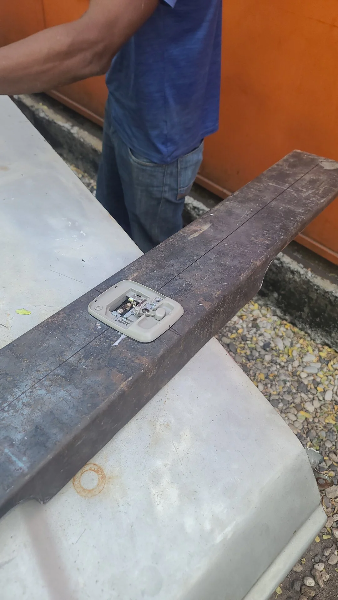

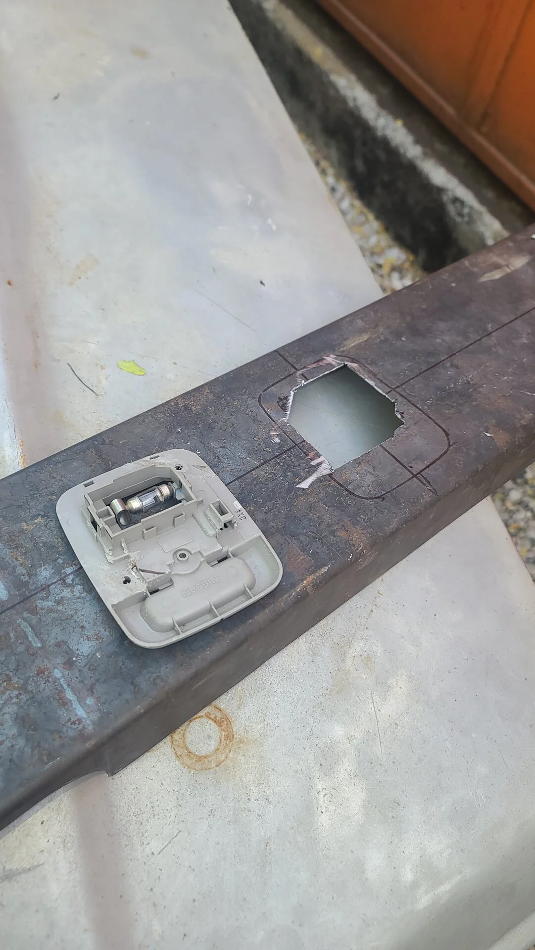

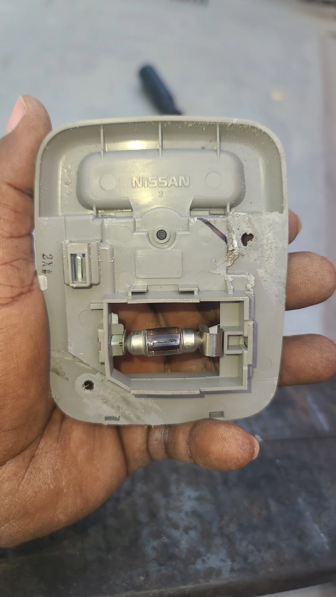

We also installed a dome light in the overhead shelf. Came out of a Nissan Patrol.

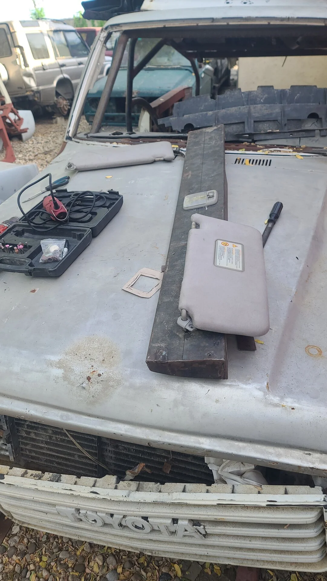

Since i was out scavanging parts out of the patrol, i realized that i could also use the sun visors and mount them onto the shelf instead of on the winshield frame . They are a bit too big in relation to the size of the windshield but i have a solution for that 😁
Found some toyota visors on line for the 40 series but those things are listed for over $160.00.
At this point , i could use the money on something more important. Here ate some pictures.

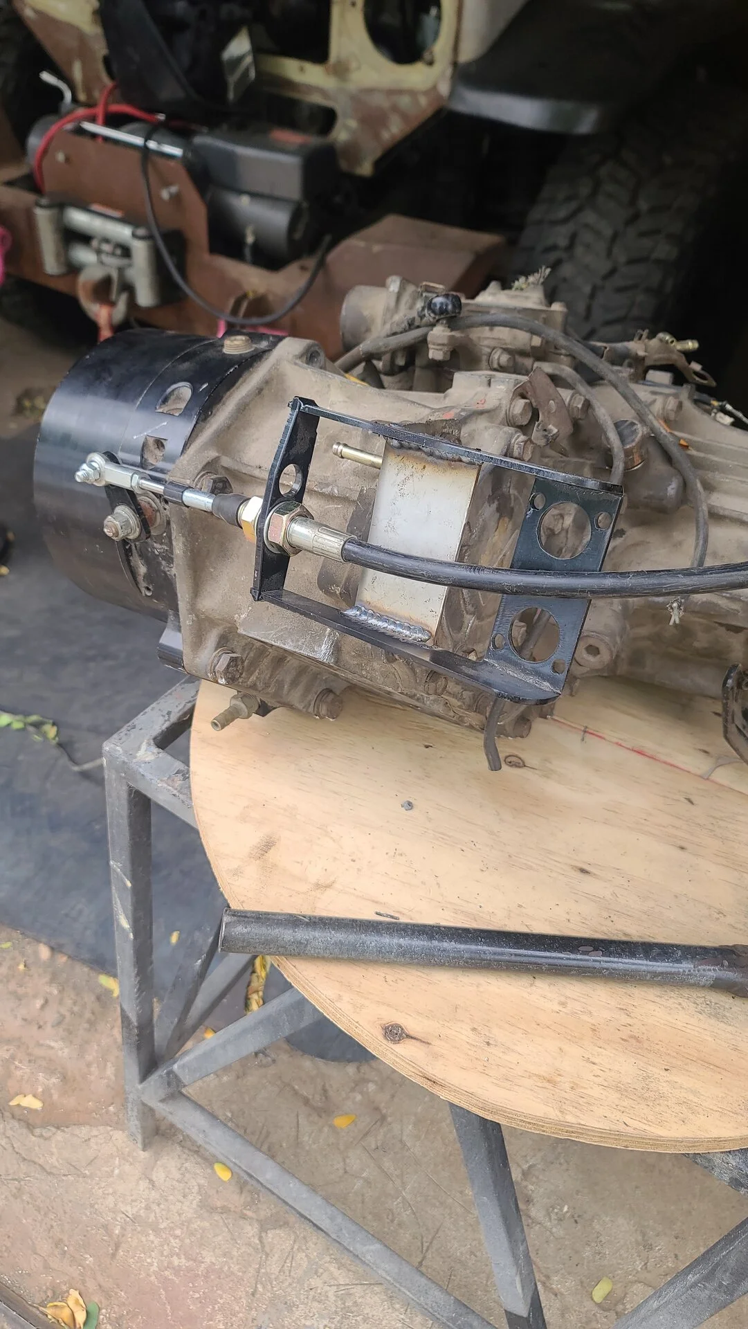

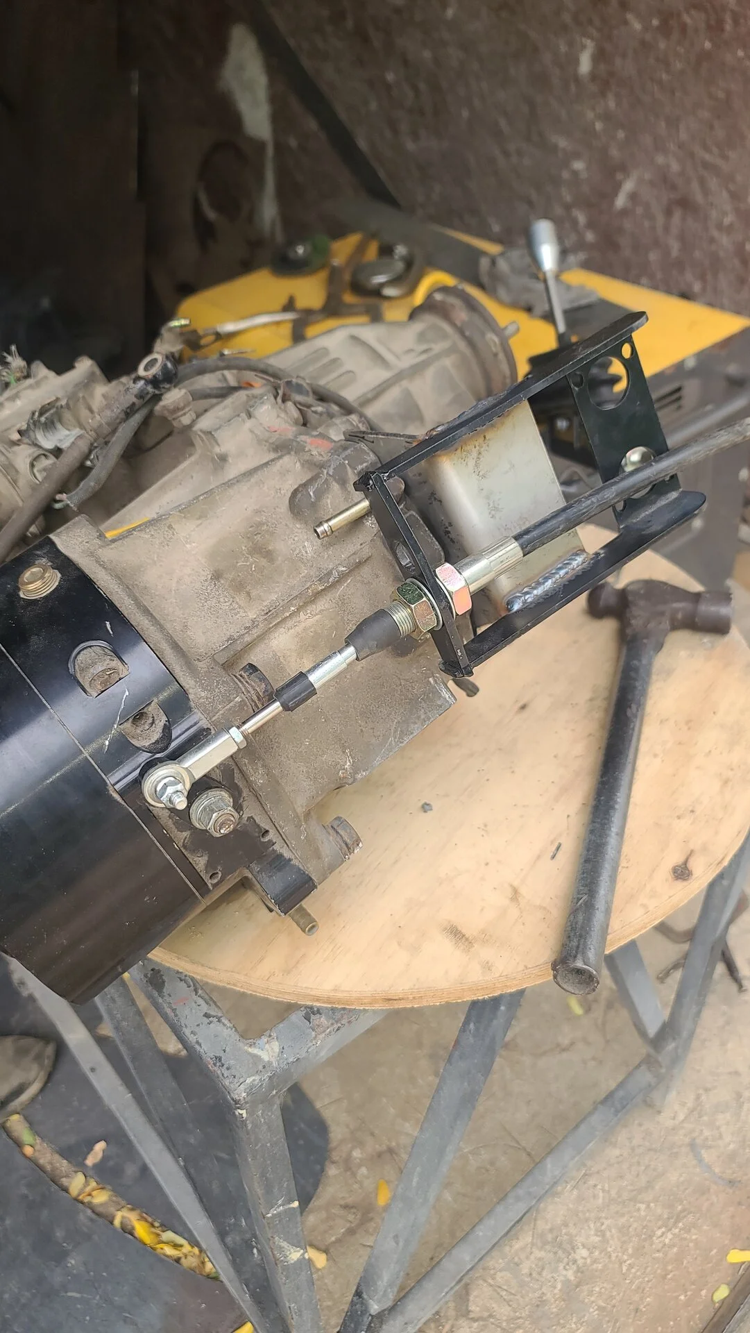

Yesterday, we pulled the transfer case and the black box to finally address s***er cable bracketry and installation . I think i got it figured out. I had some 3/16 stainless plate scraps laying around that i decided to use to make those.
When we last had the transfer caseout of the truck, we realized that there was a damaged pressure spring and the steel ball that goes under it was missing all together. I jad ordered them months ago from a dealrship in Florida and was waiting for the right occasion to put them in.
We did that and the t-case shifts from high to neutral to low pretty smoothly and seems to stay in the selected gear, thanks to those damaged and missing parts being replaced.
I checked on line but found no explanation of the use of that electric motor on top of the T-case. I am assuming that it must be to electrically engage 4x4 low and high gears. I have no idea whether it works or not but i like the idea of shifting it manually anyway.

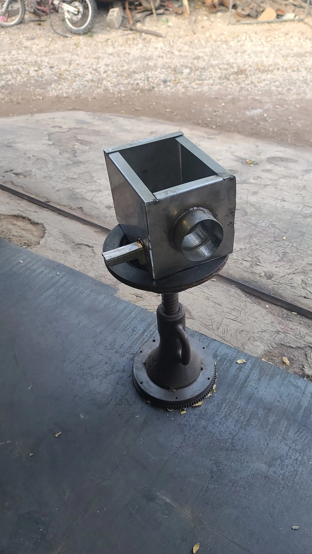

The air box also got some attention. 16 gauge stainless steel , plexyglass , 4" pipes and a K&N washable pod make up the list of ingredients for this simple recepe . I'll post pics of it later today.
