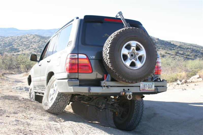

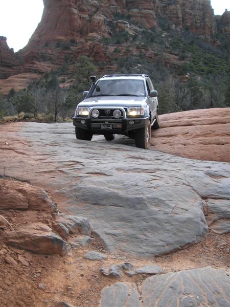

Wes is there something specific you want photos of or just spressomon's ride in general? I have a bunch of photos of his 100 from when we got together, it is a very comfortable and capable ride and I really dug all of the "Nevada pinstriping" on a late model luxo-ute.

The fridge/freeze is my favorite accessory; the FRB's are too mundane (but necessary) to be in the favorite anything (until I need to use 'em that is :D )
Thanks for taking the "pic" monkey off my back...your pics gotta be lightyears better than anything I have!!!
Thanks Harry...can't even see all the pinstriping...good job :D
