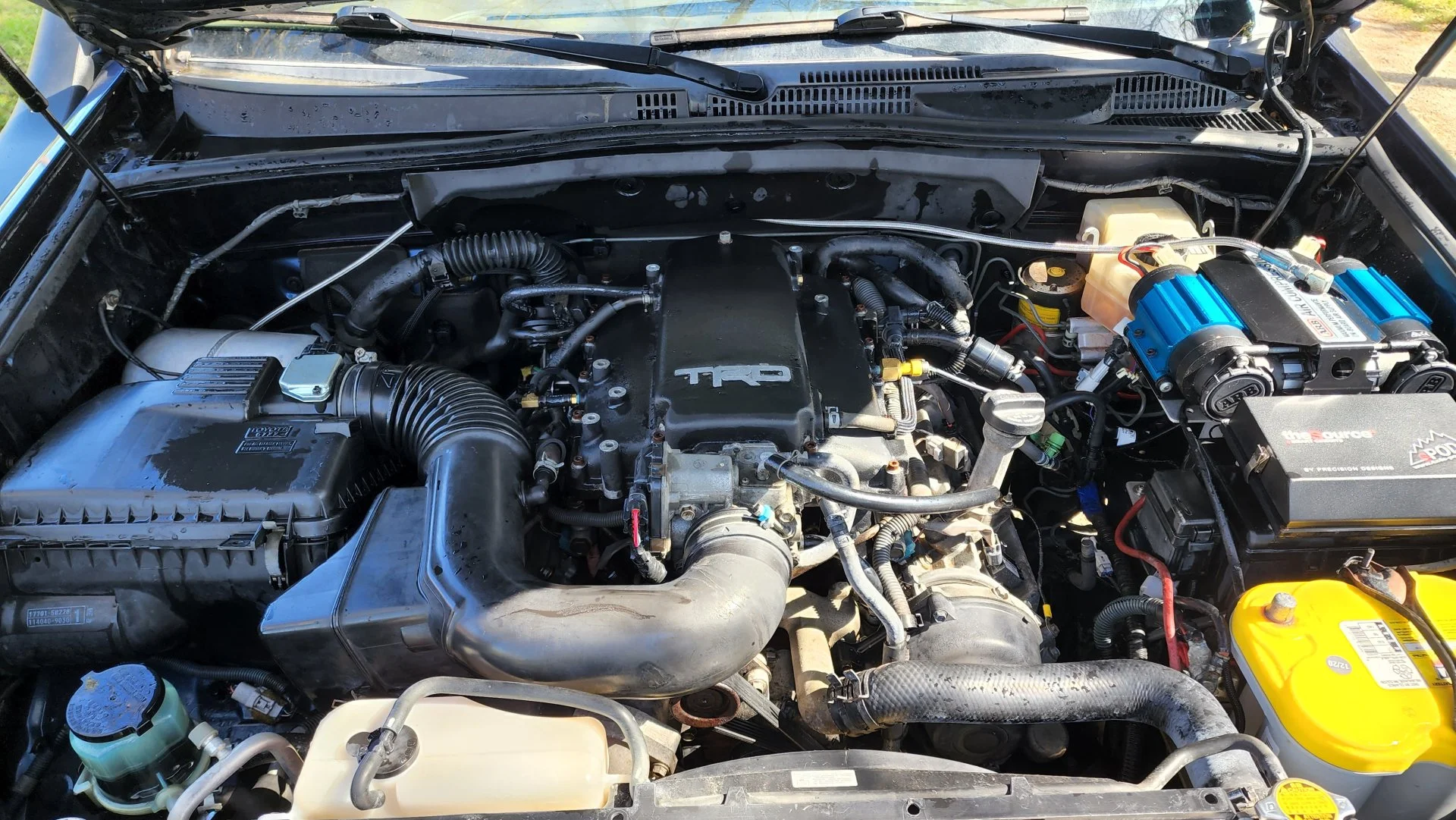

I've had mine done for a little over a year now. Did tons of research here and over on tundrasolutions. Learned a lot. I've got the 9/10th injector version off an 04 Sequoia.
Had to do some trial and error with belt lengths due to having to replace the tensioner and pulley on my 04 (the stock OE version from the factory on the GX for some reason uses a larger pulley that causes issues). I've got long tube headers, no cats for a free flowing exhaust (less boost by about 1 to 2 psi, 6 vs 7-8, but makes same or more power and less stress on the rods), upgraded Nomad HD valve body and TC lockup from WAT for much tighter shifts, and running the Unichip piggyback they specifically released for the TRD kit they developed by working with James over on tundrasolutions. The GX is on an 8.2 with 4.56 gearing and skinny 35s.
I got back all the performance, and then some, I lost with all the mods and weight (there is a long mods list). Low end tq is amazing. Towing is soooooo much better. Operating at higher elevation is better as well and still makes 3 psi or so up in the thinner air and helps a lot vs before being NA and feeling totally gutless.

Piecing it together bit by bit would be super difficult. Some parts, like the brackets for the additional pulley, can be purchased by aftermarket maker (that was a nice surprise, although my kit had them, they were rusty and I wanted the warm and fuzzy feeling you get from using new parts). The custom fuel lines and banjo is not something you'll likely find on their own. Same for the thermostat housing which has a built in riser for a bolt that bolts the supercharger snout support bracket to.
Mine was an intact take-off of an 04 Sequoia. Im running the DT LT headers as described in my earlier post. But using the URD Y pipe because the recessed crush gasket is a much better solution here than a flat flange to flat flange (asked how I know). Custom exhaust from there onward because "custom".
