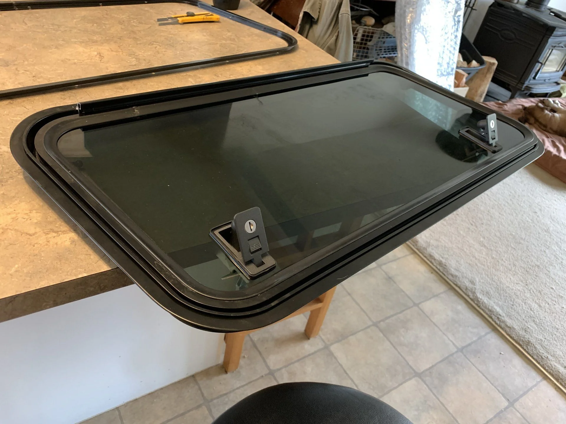

So they finally arrived. I had a set of SOR sliders, they leaked and didn't do much for me. I ordered a set of factory sliders from that guy in Austin. Paid a fortune, told me they were
ready to install. They literally fell apart, completely deteriorated junk, broken missing latches. I won't mention the name of the guy in Austin, but pretty poor.
So after a few years I came across a set of 3xm windows on a guys truck in Duncan. I liked them. $800 pair/ $1020 shipped and finally decided now was the time as I don't sleep
on the roof anymore. It's the cold weather that has me slowed down installing them, as much as I don't want to ruin the factory rubber mouldings as burn 1/2 cord of wood heating the
shop. Here are some pics. They are cool.

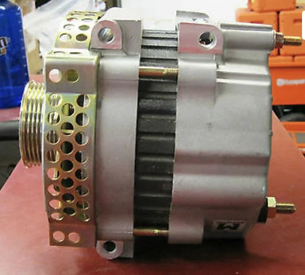

Mitsubishi does...
32 Lbs
215 Amp continuous
up to 300 Amps peak when cold.
Ambulance alternator

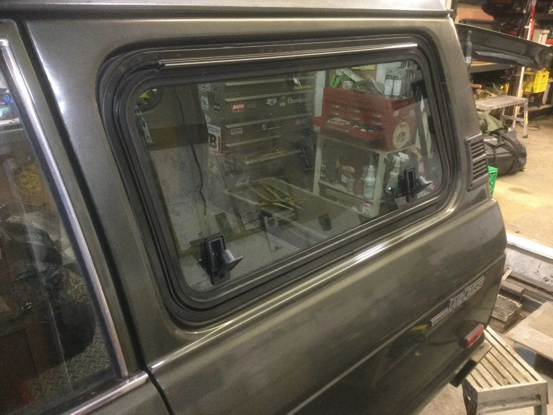

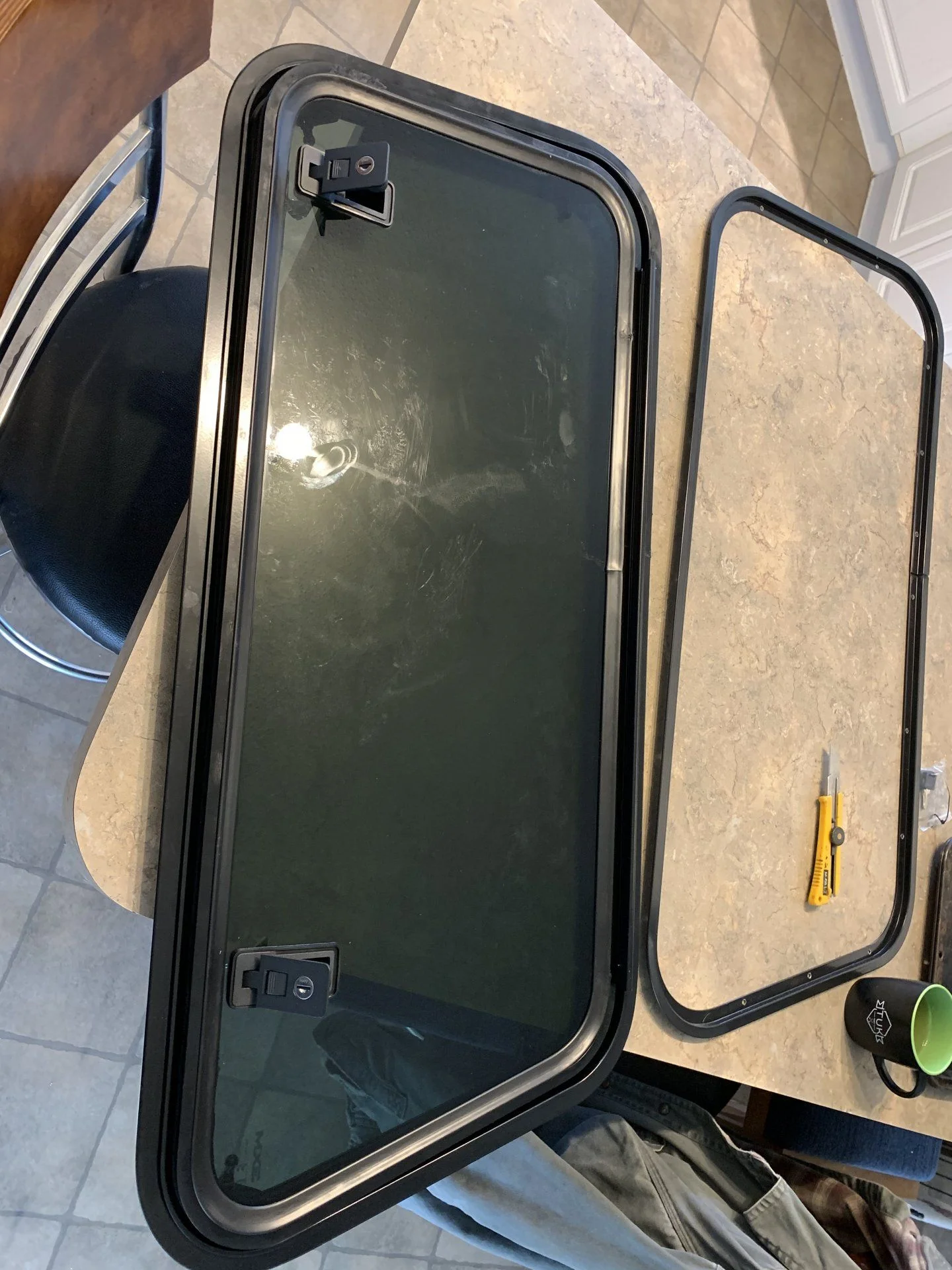

Ok got em in. Bit frustrating at first but fairly intuitive. They have an inner ring that clamps
the outer shell in. They are a decent attempt at mimicking the actual opening. Supplied with
really decent proper automotive bubble rubber seal so I’m as confident as I can be they
will fit dry even being flat.
Left side. iPad takes poor pics.

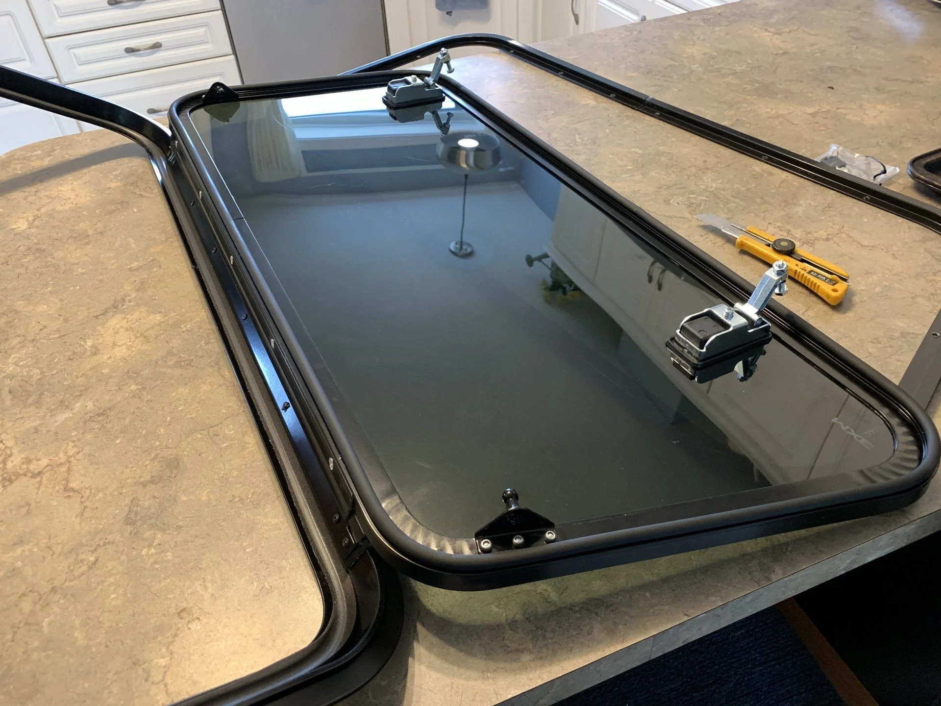

Rh side. The hinge is basically riveted RV hinge. Not fancy. They rivet together. One of the stoppers
fell off when the rivet failed. Nice to know that it sits inside the window frame so it’s impossible for
the window to fall off should the stoppers fail in flight. It just can’t slide all off.
Its a simple design, using very excellent high quality rubber seal on all the applications. I’m quite
impressed with the quality.

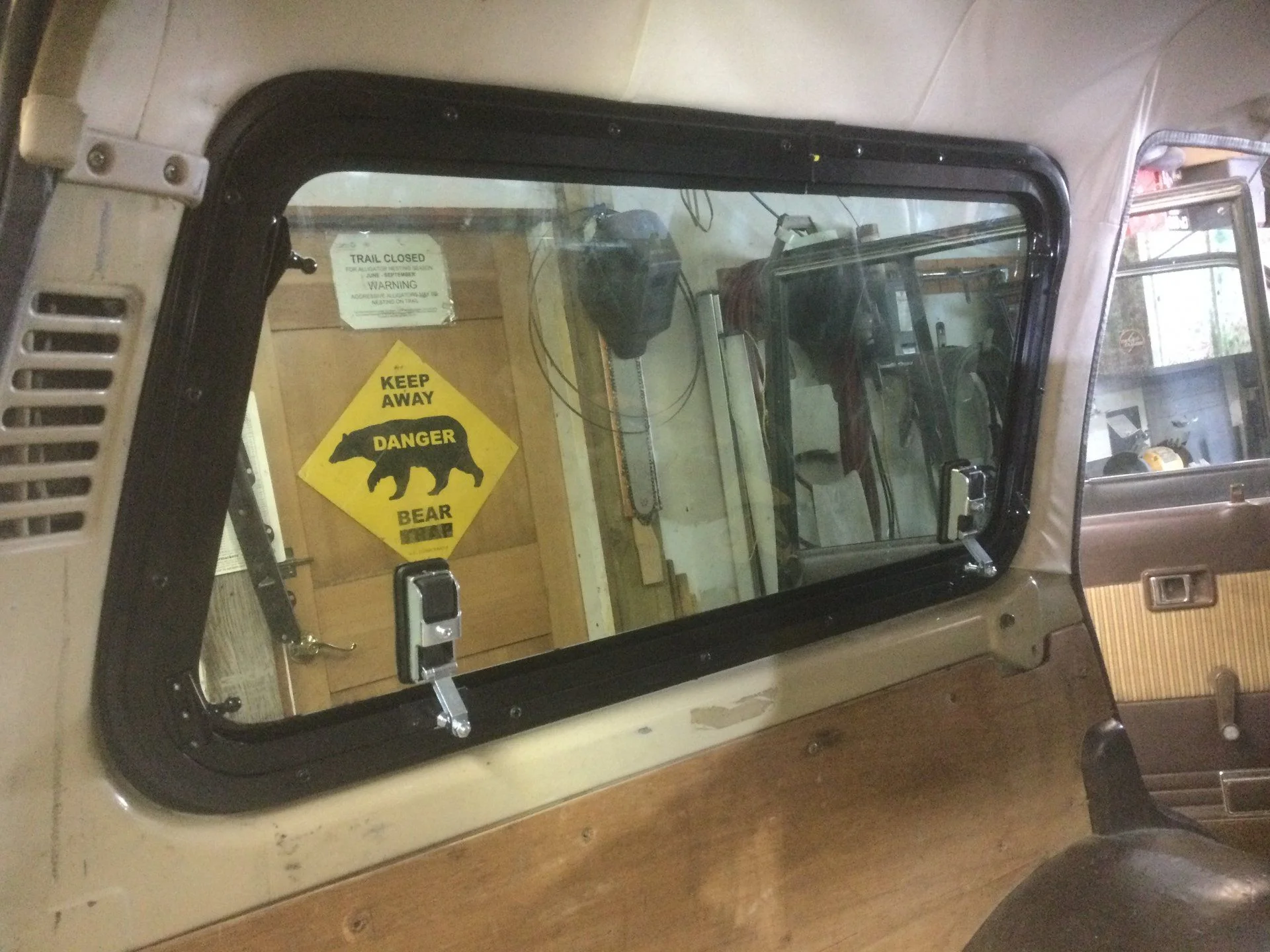

The latches are cool, I’m very happy that I can open the hatches latches but the window will not
just pop open it requires initiation to come up. It would piss me off if it could unlatch
and then just pop open. I find the struts too long. I’ll source a set that only open the windows to level.
I‘d prefer it to be open and able to have light rain fall without it dribbling right down the window and inside.
The corners are round so if it’s raining heavy it will come in the ends of the windows. But as I discussed
with Matt, I’ll figure out a small tarp or canvas cover just to add a bit of coverage. Ultimately
I’d like to sleep with them open so I’ll rig up no-see-um netting and rain shield.
lastly, the latches are super high quality. There was no scrimping on these. Overall full marks!
Oooohhhhh, aaaahhhhh!!! I like!

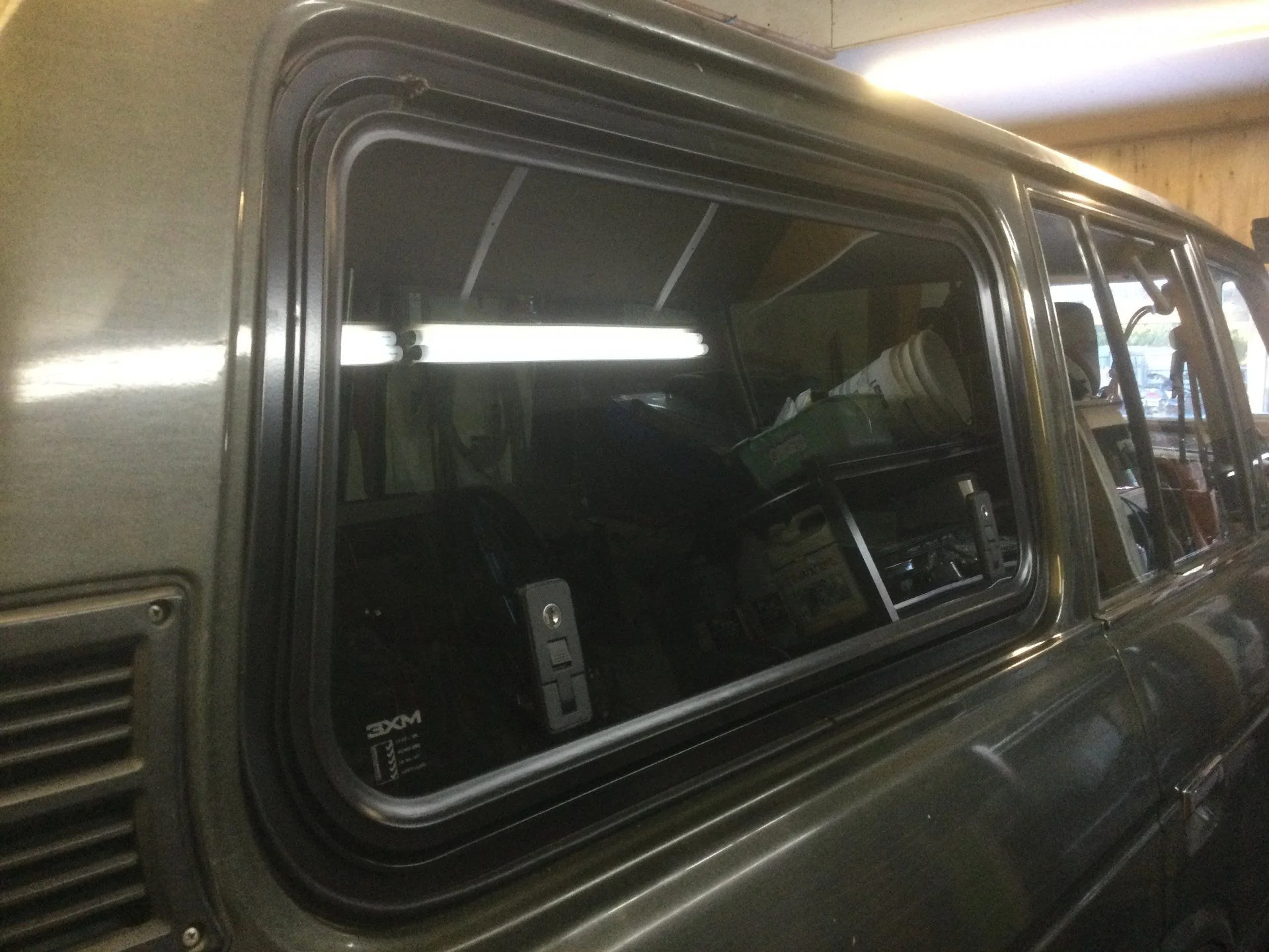

So I ran it through high pressure car wash today. There were a couple of spots below one corner inside.
Not sure how they came to be. I did realize that the foam seal tape they used isn’t closed cell like we use
here in Canada. Probably cause rain in Australia isn’t like rain in Canada. So I’ll peel it off and replace
with something a bit better. Overall they sealed perfectly well. 🤙

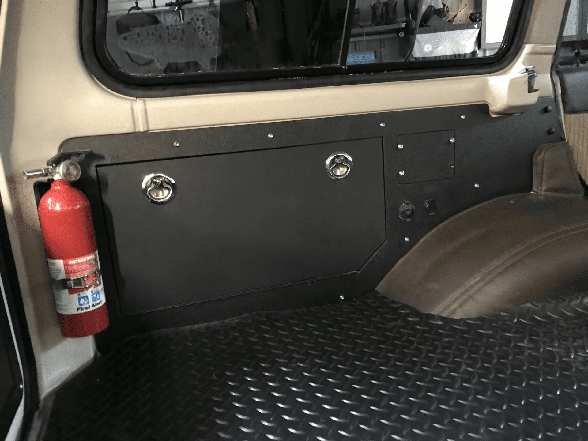

Thanks for the offer. I need to rebuild those, but I’ve got to drill out the cheap aluminum
Princess auto nutserts first. That has been a frustrating experience. When I get to it I’ll
redo in wood I think. Black plastic seems too dark for an interior
