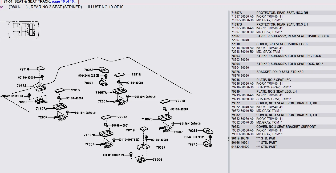

I’m trying to find replacements for the 3rd row seat plugs but I haven’t had any luck. By seat plugs I’m referring to the plastic things that go on the floor to cover up the folding seat mounts. Any recommendations would be greatly appreciated. Thanks
More than once someone here hasn't realized that the covers are snapped to the bottoms of the 3rd row seats. But if yours are completely missing:
