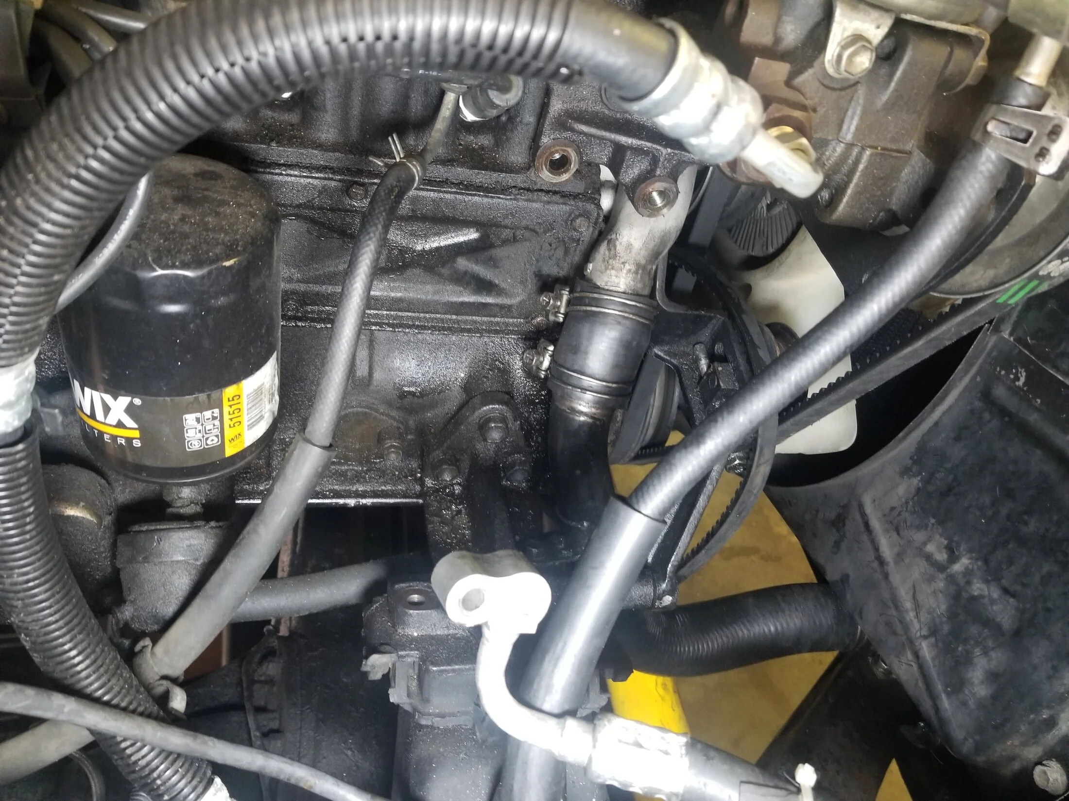

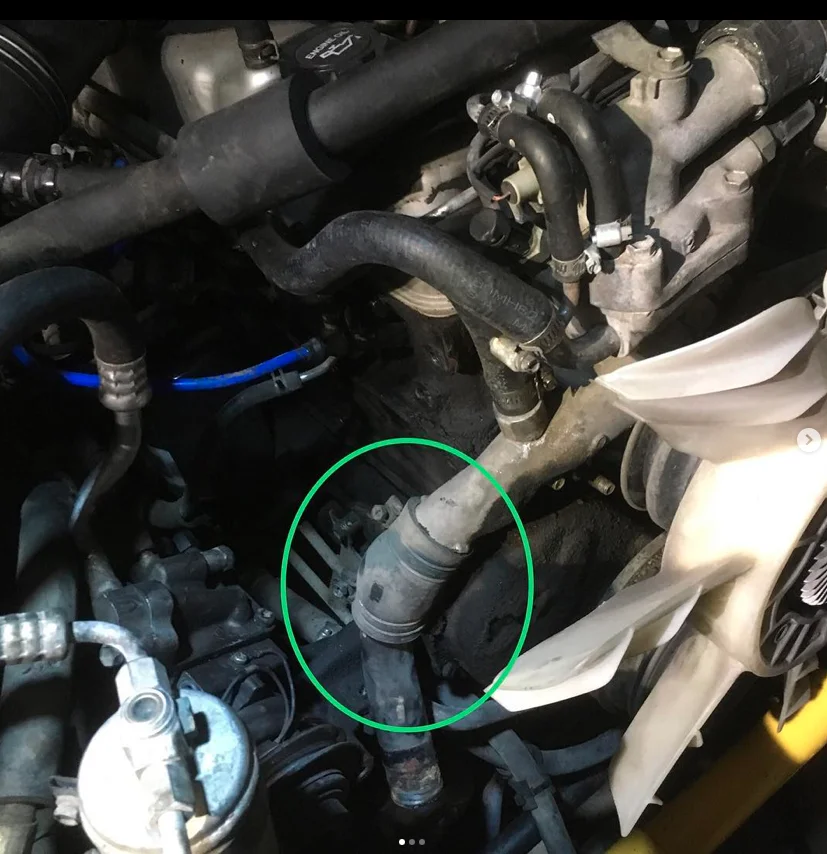

This one yes? This is mine after I pulled the PS and AC to replace it.
Yep. That's the one.
That's so crazy to think about all the sh*t you have to pull out of there to get to it. I guess I'll set aside a weekend and get to it.

There is a bit of a trick to replacing it out without removing the power steering pump and A/C compressor, but the lower hose and section of hard tube that's bolted to the underside of the block have to be removed.
First get the lower hose removed completely, then unbolt the tube. You'll have to go by feel here, and it is a royal pain in the arse, but loosen the UPPER hose clamp as much as possible. Do NOT loosen the lower clamp. With the upper clamp loosened, grab the hard tube from underneath and wriggle it as best you can until the hose separates from the water pump inlet.
Mark the tube where the old hose ends and also so you can identify the position of either the inner or outer bend of the hose. Install the new hose to the tube and secure it with a spring clamp (same P/N as the upper radiator hose clamps). Now slide a new wire style hose clamp over the hose and fit the hose/tube assembly back onto the water pump inlet, then secure the tube back to the block. Now you can position the new clamp so that the bolt head faces back and get a small ratchet with 10mm socket (or whatever size it was. I think it was 10mm) onto it to snug it down. Once that's done the lower hose can be reinstalled and secured with spring clamps as well. I prefer the spring clamps above all others, but in the case of the top clamp on the upper hose, releasing a spring clamp would be impossible without removing the compressor and PS pump, so the wire style clamp is necessary.
