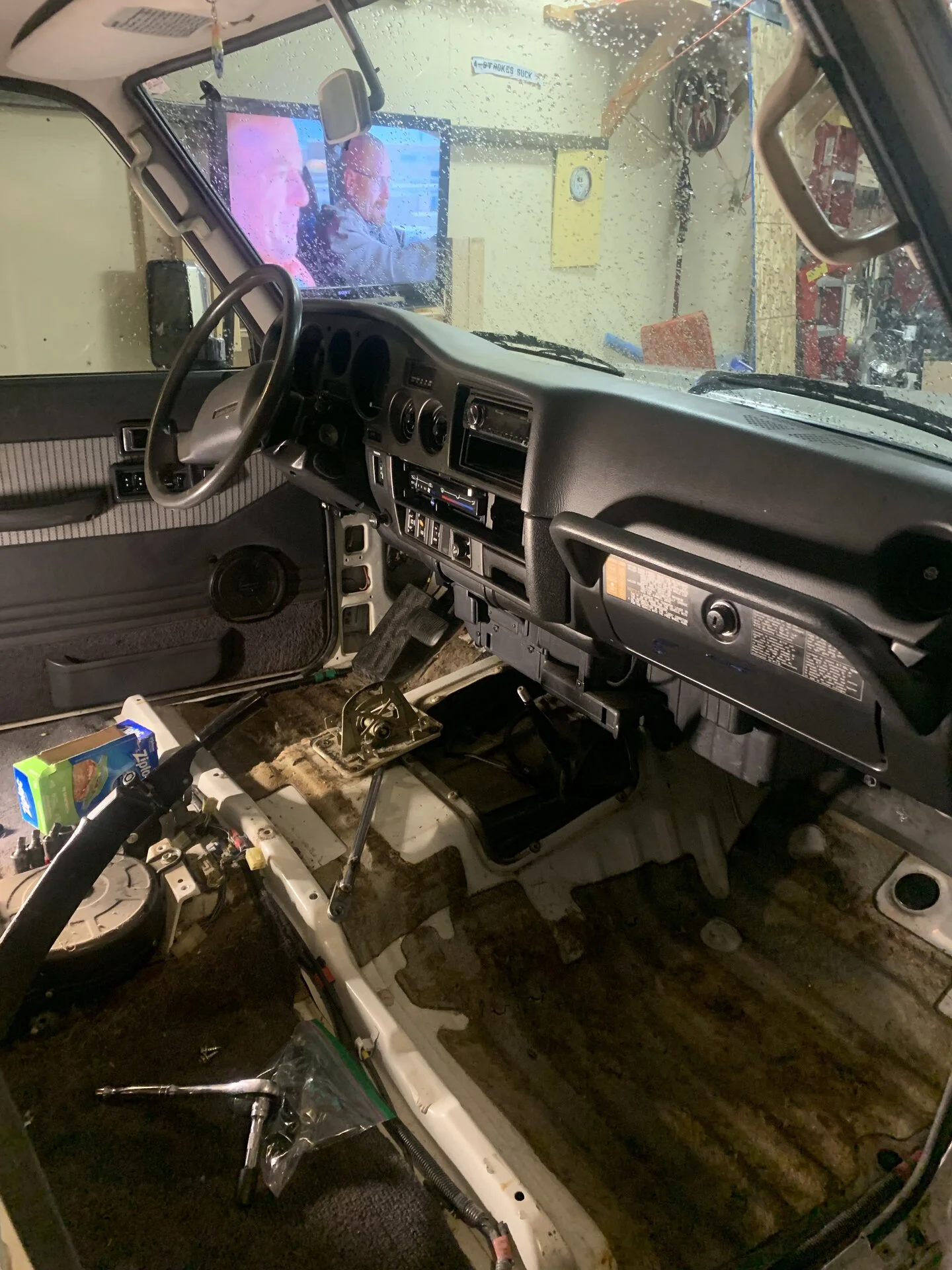

Any recommendations for removing the top few bolts from the bell housing? The two at the top and the one on the upper left side directly behind the intake manifold?
Is it an access problem? in the past I've dropped the transmission crossmember and lowered the trans a few inches on a jack to get better access to bell housing bolts.
it looks like that's going to be the solution, don't want to damage the heat shields or anything else in this process.
If you remove the carpet, (not hard) you can remove the transmission hump.
Accessing the top bolts become a breeze.
I HIGHLY recommend doing it this way.
