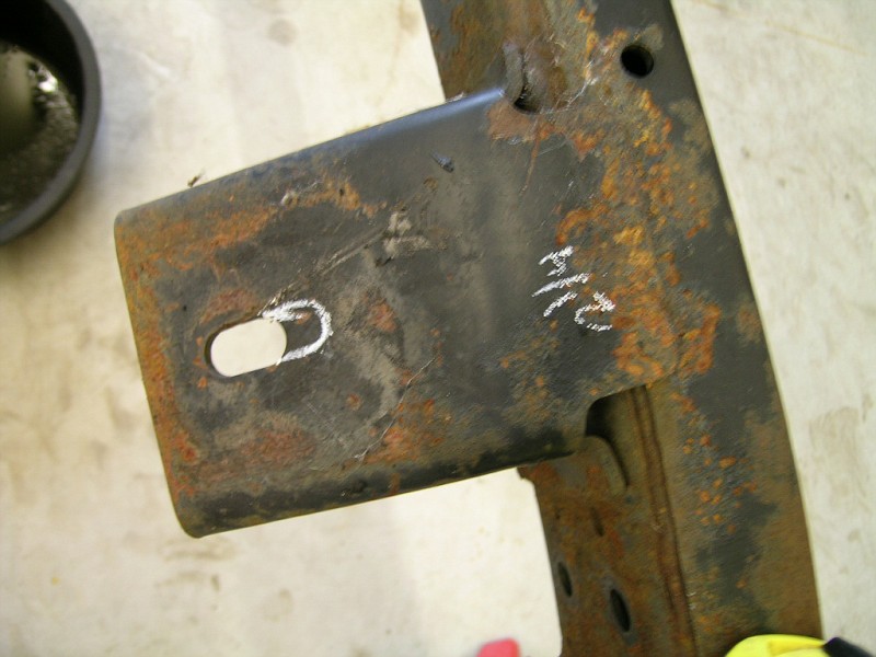

I'm having some motor mount trouble, I picked up the correct mount for the right side on my way home, but the mounts are still way off the frame rail. The mounts are from an FJ60, look perfectly the same as the 3FE ones, I can compare to my truck parked outside (Lili). I grabbed both the 3FE mounts that were there, even though the 2F ones look the same. Looks like I might have to elongate the oval hole to make this work, anybody had problems dropping a 3fe onto 2f mounts?
The motor is pretty happy where it is, might have to drop down a smidgen??
I should have said I grabbed the isolators from the donour 3fe, plus the right side mount, the isolator is at the end of the travel, looks like it needs to go another 3/4", something doesn't seem right. I'm sure the isolators are on the right way, seem they only really fit one way.
I was recently told that the 80's are a significantly narrower frame. Stands to reason that both the frame mounts and the engine brackets might be narrower too. I'll venture that replacing the engine brackets with 62 parts will cure the problem.
I went and grabbed the left side mount as well, turns out it's the same as the 80 series, so no lovin' there. It has to be the 2F frame mount is different, anybody got a 62 frame sitting around without a motor in it, that could snap me a picture or two. I really would like to know how close the opening (where you bolt the isolator, elongated hole) is to end of the mount, closest to the motor. looks like if I extend the opening 3/4" on both frame mounts, these might work.
Phil, I just pulled my 3fe from the 62 and the mount is different than what you have posted.
The oval on the engine bolt side of the mount is 1 3/8" to center of the oval hole, 3 3/4" to the bend towards the frame, and frame to engine side of the mount is 5 3/4"
I'm talking passenger side engine mount, in case I am confused.

Thanks Kim, I'll post a picture of the right side mount tomorrow, perhaps you could measure across the frame, oval to oval. I'm sure I've read that the 3fe/ 2f mount is the same, I don't understand why there is such a gap from frame mount to frame :bang:

Thank you, thank you Joe_E, I thought I was loosing my mind. So, just to clarify for others, the mounts are NOT the same between a 2F and 3FE. Very close but not a drop in.

Whoo Hoo!!! Success, I stopped by Kim's and relieved him of his 62 frame mounts, go figure, they work perfectly. I'll burn them in tomorrow, hopefully the rest of the parts show up, otherwise I'll be spending quality time in the parts washer.
