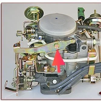

I may have cracked this nut, and hope someone else may too after reading this. Here is some pics of the original spring and the heavier one i replaced it with:

Some of the linkages are pretty loose where they attach with the little C-clip, is that normal or okay? I think the one attaching to the choke breaker is the loosest. Can't see how that relates to the issue though.
