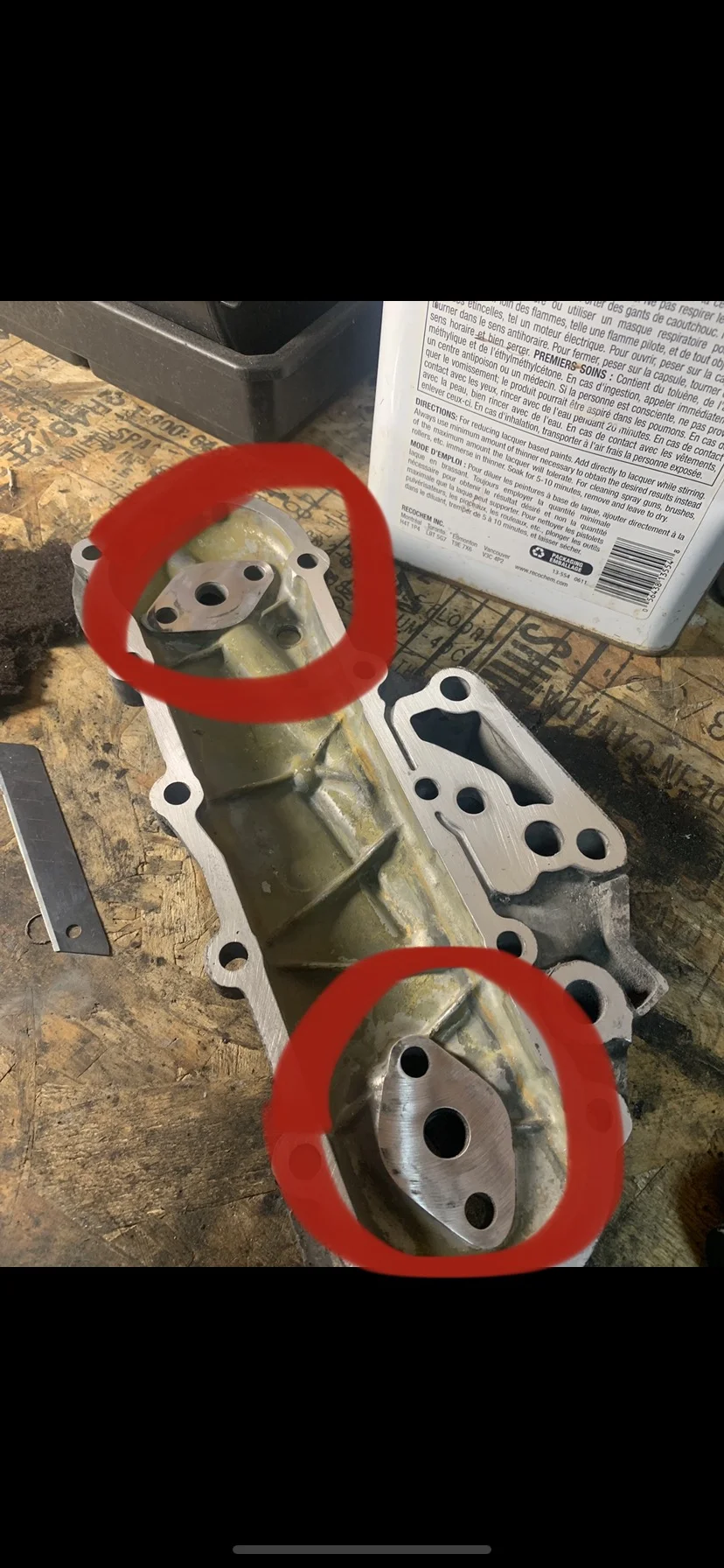

It’s probably your oil cooler.
The oil cooler is in a aluminum housing that fills with coolant, then oil passes through a tube that connects in the area that’s circled in red.
Basically oil and coolant come in VERY close contact - if the seal/O-ring go bad, you can have the two fluids mixing- good gaskets are crucial.

If you buy a gasket set for the whole engine, it most likely will. Mine did at least. It’s nice having every gasket even if you don’t need it.

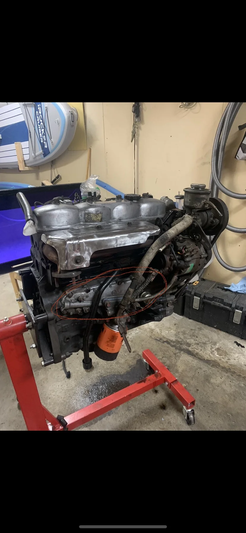

looks like your blowby tube coming off of the pushrod cover, could be excessive blowby from bad cylinder rings (potential engine rebuild)
could be head gasket
could be the seal around the pushrod cover needs resealing

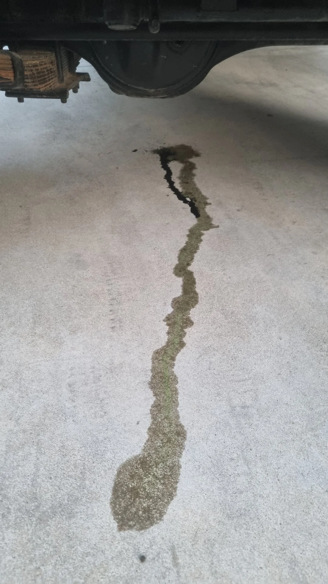

I have a 1980 BJ40 with a "rebuilt" 3B diesel. I ve had it for 1 1/2 years with about 5600kms on it. I have fixed a parking brake transfer case oil leak and looks like the rear crank oil seal is also leaking. I have done a compression check with 500-600 psi readings. Blow back looks normal but my mechanic has filled the lubrication system over the "full" line by about an inch. I think he did this because of the rear crank seal leak because he doesn't want to drop the transmission/ transfer case to replace the seal. I have what looks like an oil substance on the side walls of the coolant expansion tank but don't see any oil slicks on the coolant when I open the radiator cap. I do have a few oil leaks underneath the truck. I'm wondering if I should flush the cooling system with a degreaser solution and fill with new coolant to see if I still get this grit on the walls of the expansion tank.

Thanks. I'll try the flush. If I had a leaking head gasket wouldn't the compression be low?
hard to say,
it could be the oil cooler i guess too
hard to say,
I heated the engine up and detached the hose from the expansion tank ( that runs from the radiator cap) and inserted the end of the hose into a bottle of water to see if I got any bubbles or discharge and didn't. Given this and the compression test results I don't think I have a leaking head gasket. I'll try the flush and see what happens. Thanks/ Chuck
