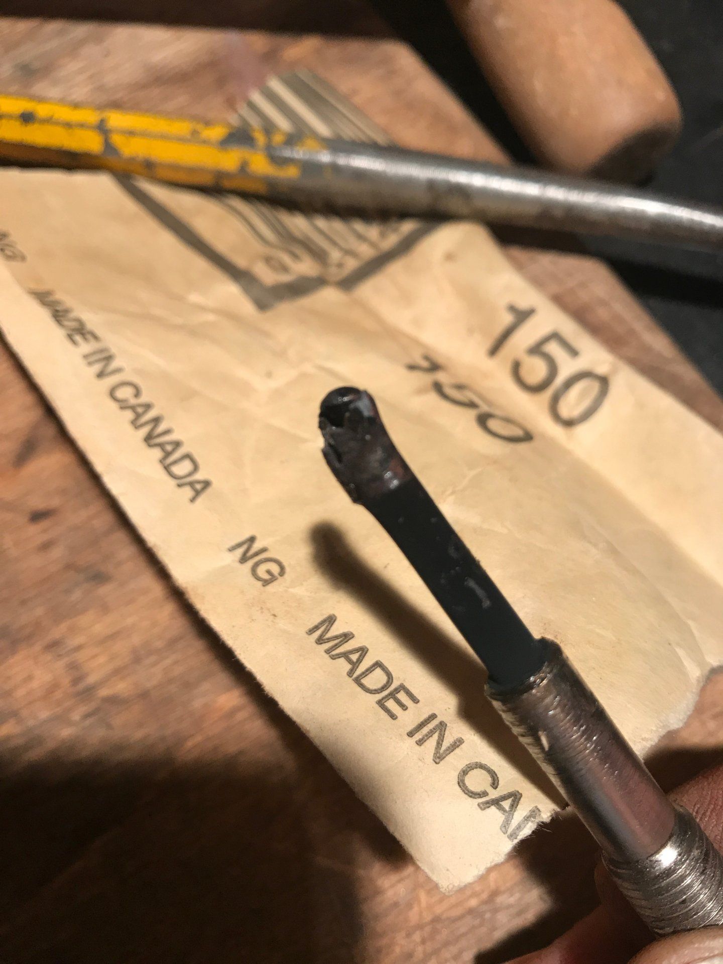

At least they didn't look like this!
Danggggggggg😳
