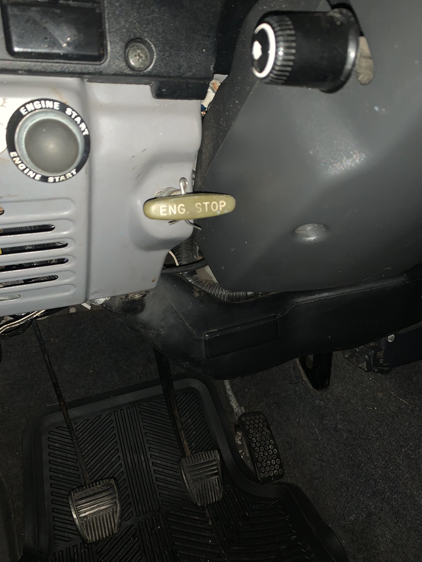

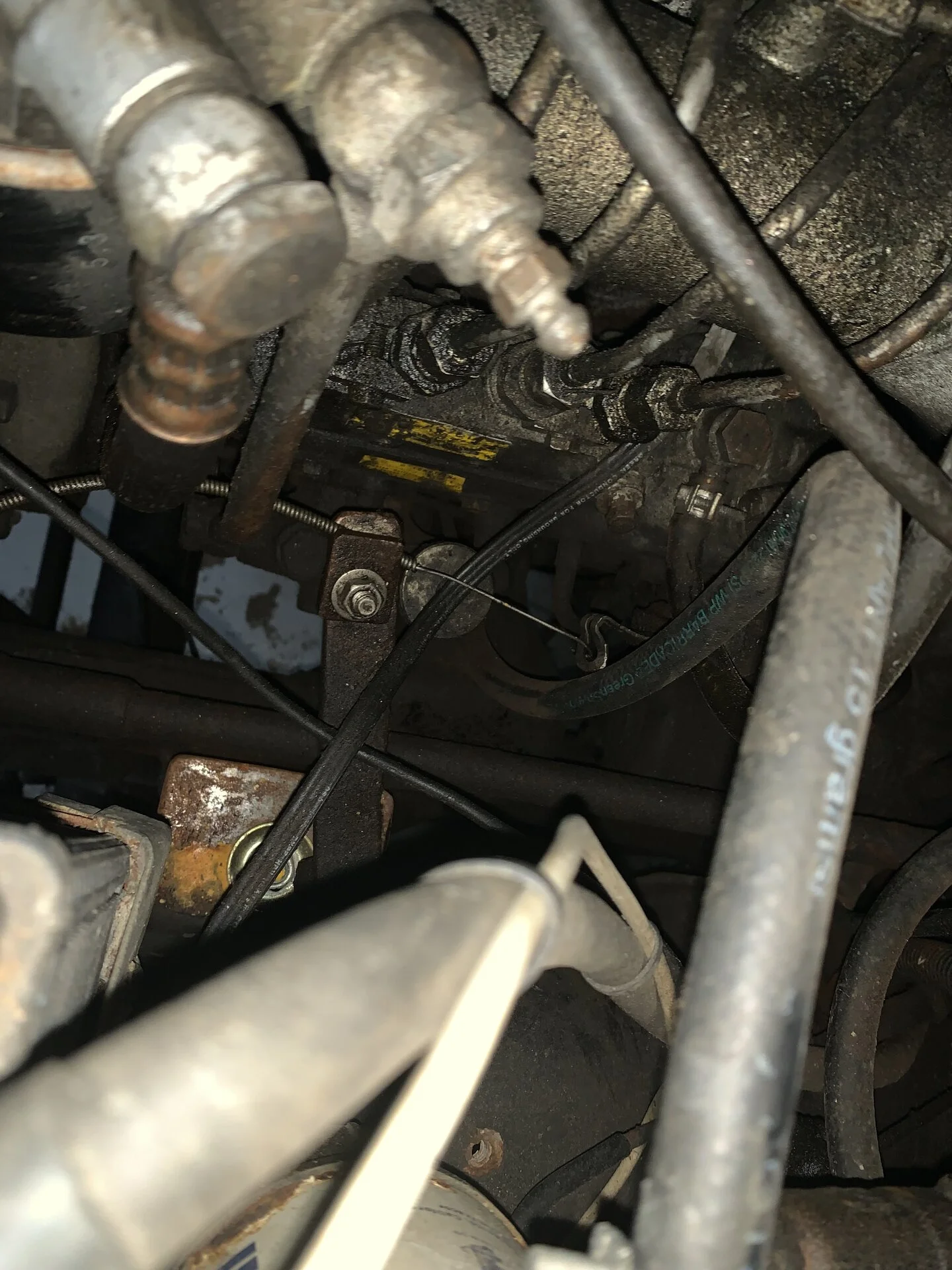

I also have a 3b and a spare that I’m gonna rebuild. You have details on the mechanical kill? The military pull cable? One has a bad edic and the other is good (want to try to repair the bad one) but love the mechanical aspect.
The exact one I have is green, but this may actually be a bit better then mine, if I come across the exact one I got I will post. I just looped it around
As far as the install I tried to get a couple pictures for you, I just bent up a piece of metal with a bolt to pinch the outer sheathing of the cable then just looped it around to the lever on the injection pump. Simple but functional.
