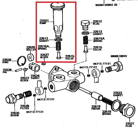

Thanks for the response. I checked multiple years and models of Landys with 3Bs. 22501-77021 is the part number on all of them. I assume I need the gasket spring and valve as well. Gasket at least?
Spring and valve normally just stay in the body, I think the gasket is just an o-ring, all you need is the primer bit that ends up leaking like a sieve. On John Deeres too. Not intimate with how a 3b return system works, I've worked on Bs, 2bs and currently a 13b, theres a steel line connecting all 4 injectors, does this return to the gas tank or back to the filter housing? If yours goes back to the filter this can make priming a longer exercise. If it goes to the tank the Bs, or anything with the inline Bosch normally prime really easy. Don't think you'll be able to suck thru an injector line but don't mind if you prove me wrong.
