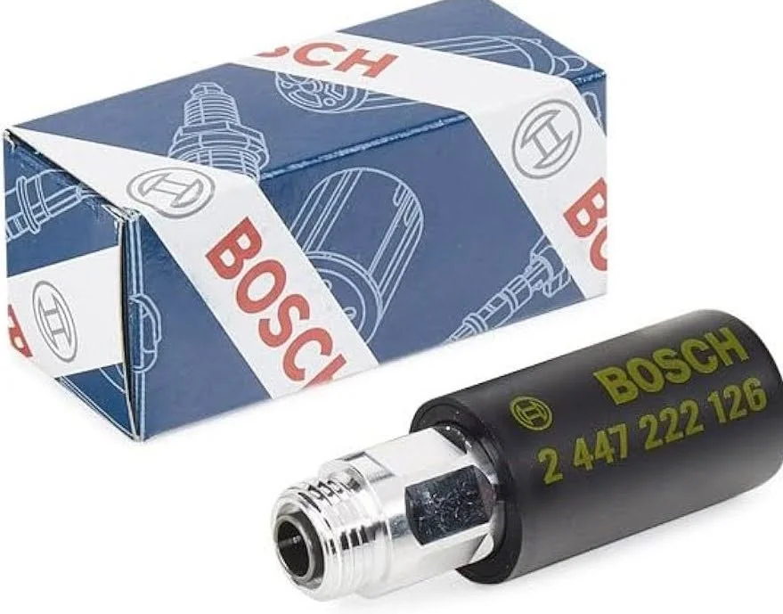

With regards to the primer pump.. get the bosch unit.. its superb. Readily available from any good diesel place.. Part number 2 447 222 126
