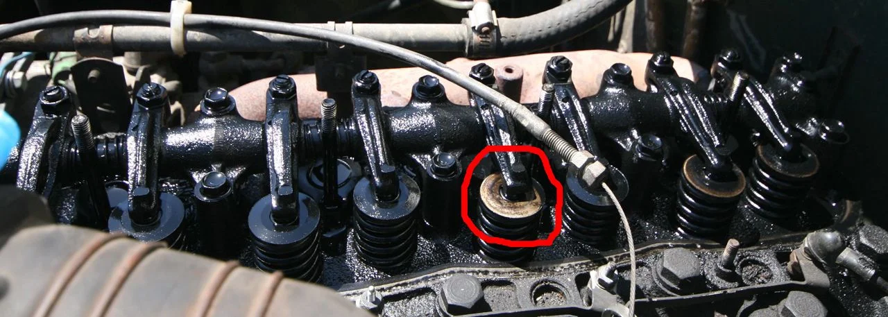

He's most likely assuming the freeze plugs are the tops of the pre-combustion chambers. You can't inspect them without pulling the head.

Seems now that the illustration is a bottom view of the head, post removal. So in that case I don't know what exactly I was looking at near the valve rocker assembly.
Thanks, Rufus. I was under the impression that the freeze plugs were situated on the side of the block (by where block heater plugs in).

A few of the visible head freeze plugs circled in red.
