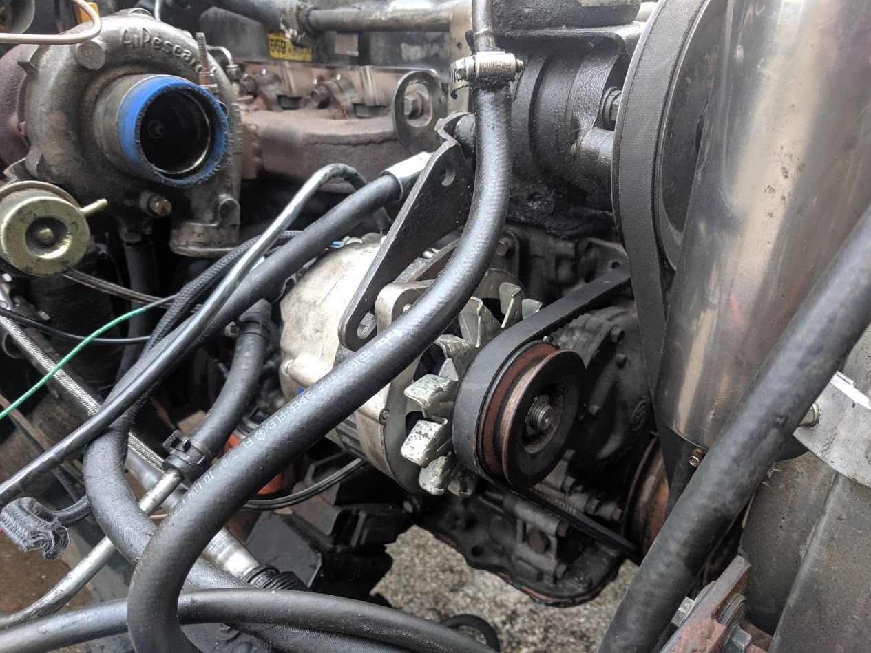

I ended up getting one of the ebay specials and installed it on my custom L diesel engine ....long story. Well it worked for almost a year and then left me stranded. Stopped charging. I was on the road and ordered a replacement from NAPA (Canada) and a higher end one came in and cost me over $170 (without the vacuum pump). That one works awesome. I changed over the vacuum pump (which still works) and all was good. Since everything in my engine setup was custom I can't say how it would work on a 3B.

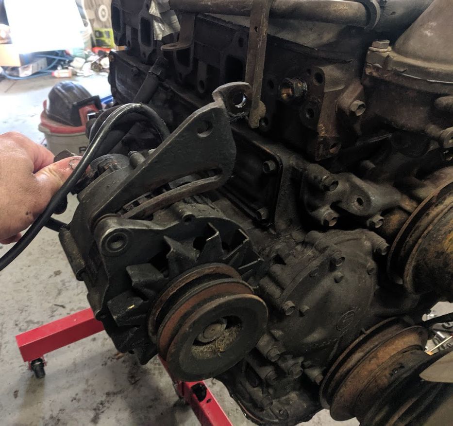

Anybody have an update, photos, parts list for getting the npr alternator on a 3b or another alternative that is a direct replacement?
I am wondering if I even need the vacuum booster on my alternator.....is it only for the brakes?

Yes, it's a rebuilt NPR unit from Wilson. Wilson part number 90-25-1089. It's the same thing as this item on Amazon. The one on Amazon comes with the vac pump installed. The Wilson unit does not.
Please note that these do not come with a 3B-compatible pulley. You will need to replace the pulley. The pulley from your old Toyota alternator is not compatible with the NPR shaft. There are posts elsewhere on Mud with part numbers and links to alternatorparts.com for the wiring pigtail and pulley.

also id like to add that i had the factory alternator custom rebuilt by a 70 year old gent just north of us...13.8 when we got it back.
and i purchased the hitachi conversion one as well just in case he couldnt
I will inquire if the rebuilder would like his name out there for you guys to use, and get back to this thread
What would be fantastic for somebody to build would just be a bracket to add another alternator for accessories or just an adapter bracket for the NPR with the higher amp output and the booster.
I went with this 12V 1-wire internally regulated alternator from cruiserparts for my 3B. It has the pump and works with the aftermarket wiring harness I am installing.

How have you liked this alternator ? I have a 1980 BJ41 with a 3B turbo diesel. Looking to move towards an internal regulated alternator 12v. Open to all wisdom on this.
My off-brand NPR alternator is still goin strong. The 13bt idles a little too low for it, so it sometimes stops charging when I'm at a light, but other than that it's been doin great. My build thread with part numbers and pics is here: Validating browser… - https://forum.ih8mud.com/threads/need-a-new-12v-alternator-for-my-13-bt.1300256/page-2#post-14793437
