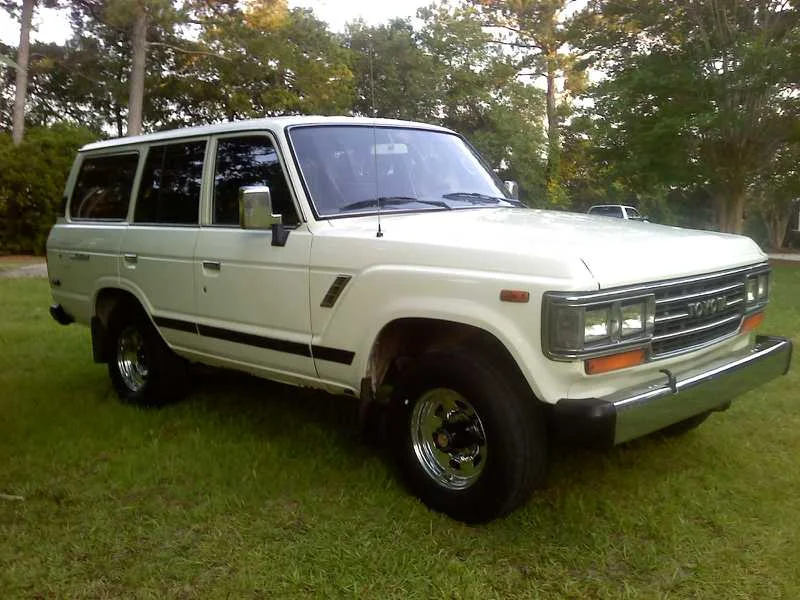

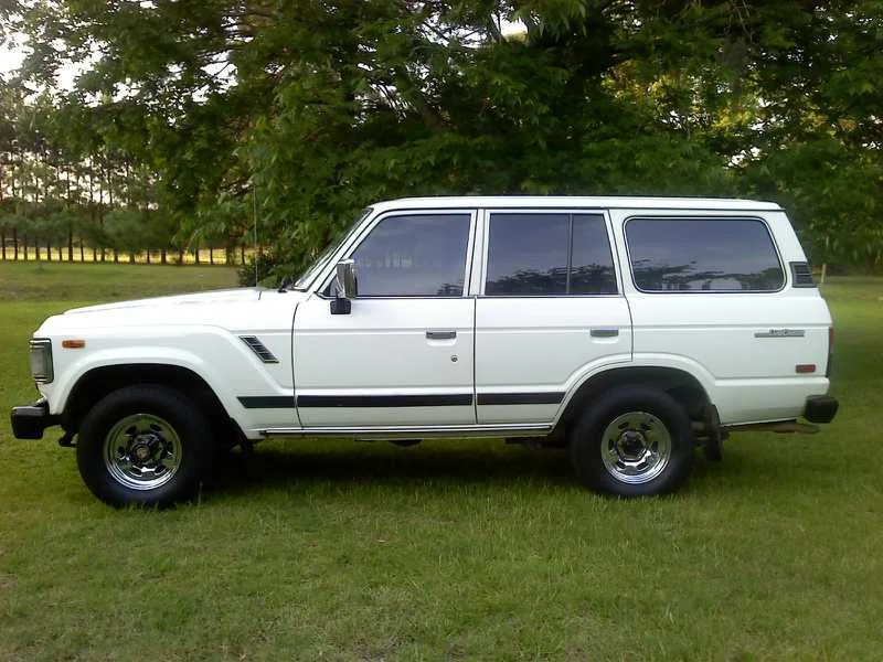

I am beginning the documentation of a 3B diesel swap on our 1989 FJ 62. We purchased our rig a few years ago and we had big plans to start accessorizing it. Our plans changed when the transmission gave out on us. After getting several quotes to rebuild it we made a decision to go all out and implant a diesel and manual transmission. We found a donor BJ 60 from a local mudder in The Charleston, SC area. It was originally a Canadian vehicle so it had plenty of rust. This is a project that my son and I are working on together, I guess you can call it "Male Bonding" or maybe a little bit of "Male Cussing"!
Here is the FJ 62 that is receiving the diesel.

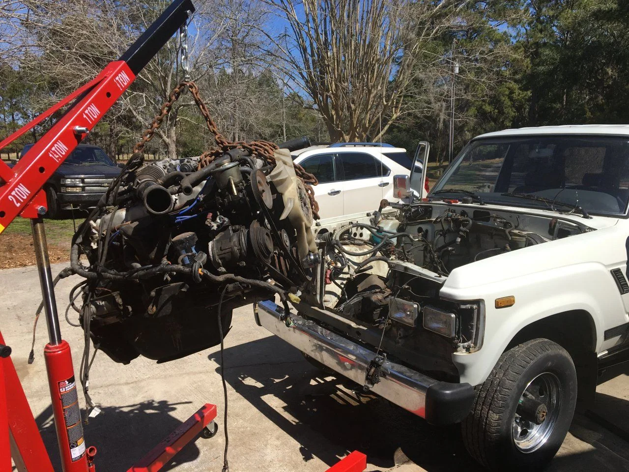

Yesterday we finished stripping all of the unnecessary parts under the hood that is not needed for the diesel, removed the gas tank and fuel lines, cut away the motor mounts and prepped for the new ones, removed the whole dash, removed the pedal buckets with the automatic, and pressure washed the engine compartment. I guess that was a full day in 100 degree heat!

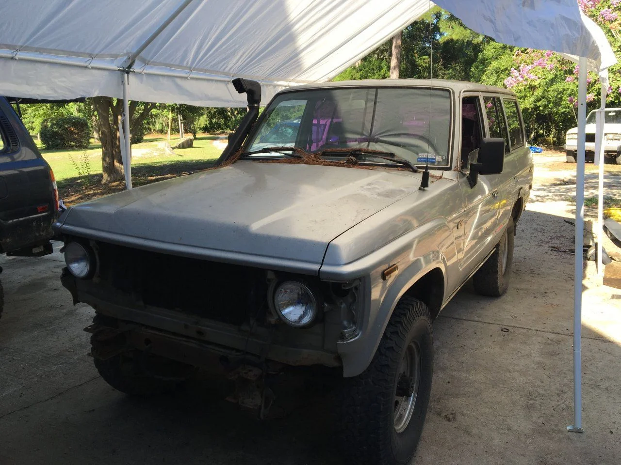

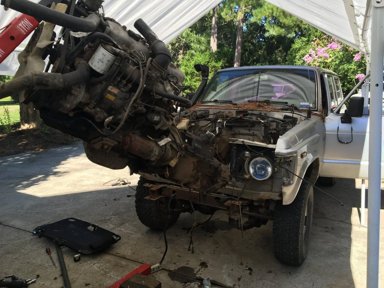

Today we were able to pull the 3B, transmission, and transfer case from the BJ 60. :clap: We were lucky that all of the bolts cooperated and did not give us a fight. Pretty awesome considering all of the rust that is under the rig.
I might need to swing over and say my goodbyes to the old Canuck
Yes indeed. It is quite depressing to see how much is has deteriorated in the last year. The rust just seems to be eating her away before our very eyes. Give me a call and swing over this week so that you can see what we have going on. I will be back to work on Monday so the progress will come to a halt until fall.

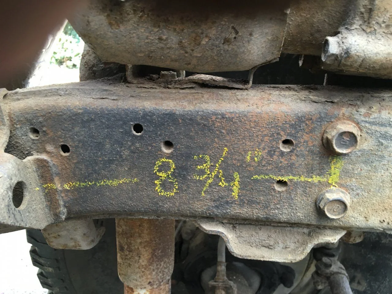

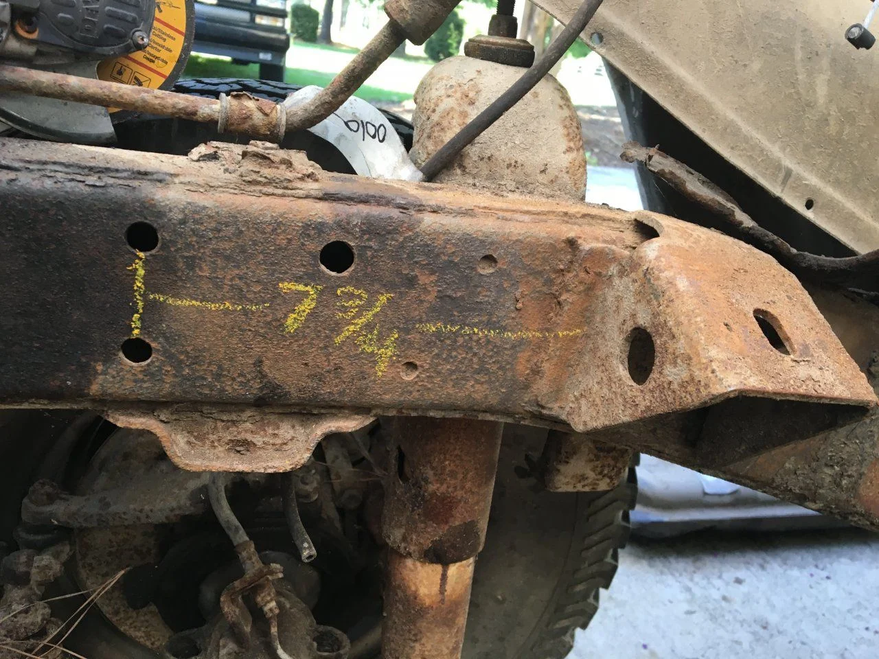

Today we were able to cut away the engine and transmission mounts out of the 60 without destroying them. It took three tools to finally get the job done. I started out with a 4.5" cutting wheel on my angle grinder to get most of the weld cut away, then I had to change to an air cut off tool to cut around the top of the bracket near the underside of the body, and finally I had to bring out the cutting torch to finish it off. The transmission mounts were the real PITA! We also transferred the measurements onto the 62 frame. We were able to drop the fuel tank from the diesel and take out the dash so that we can remove manual pedal buckets tomorrow.
