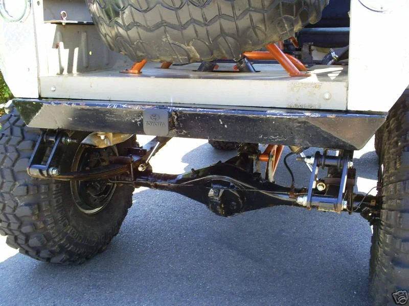

This was a couple weeks ago, I rubbed on my bib here,
Here's from the back, no rubbing there,

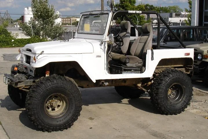

Side shot when I first got them,
38.5 SXs on 15x10 x 2"BS
SOA ft w/ flipped 40 springs
SOA rear w/ flipped fj60 rear springs minus 2 leafs

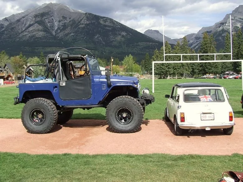

If you decide to run a 39.5" IROK, I would recommend going with a 17" wheel. The 39.5/15 has too tall of a side wall in my opinion. It lets the rig bounce more. I would also run a 8 or 9" wide wheel.
Both tires in the pics are 39.5 IROKs. In the first pic, the one on the left is 39.5/15 on a 10" wide beadlocked wheel. The one on the right is a 39.5/17 on an 8" wide beadlocked wheel.
In the secone pic the 39.5/17 is on the left and the 39.5/15 is on the right.
