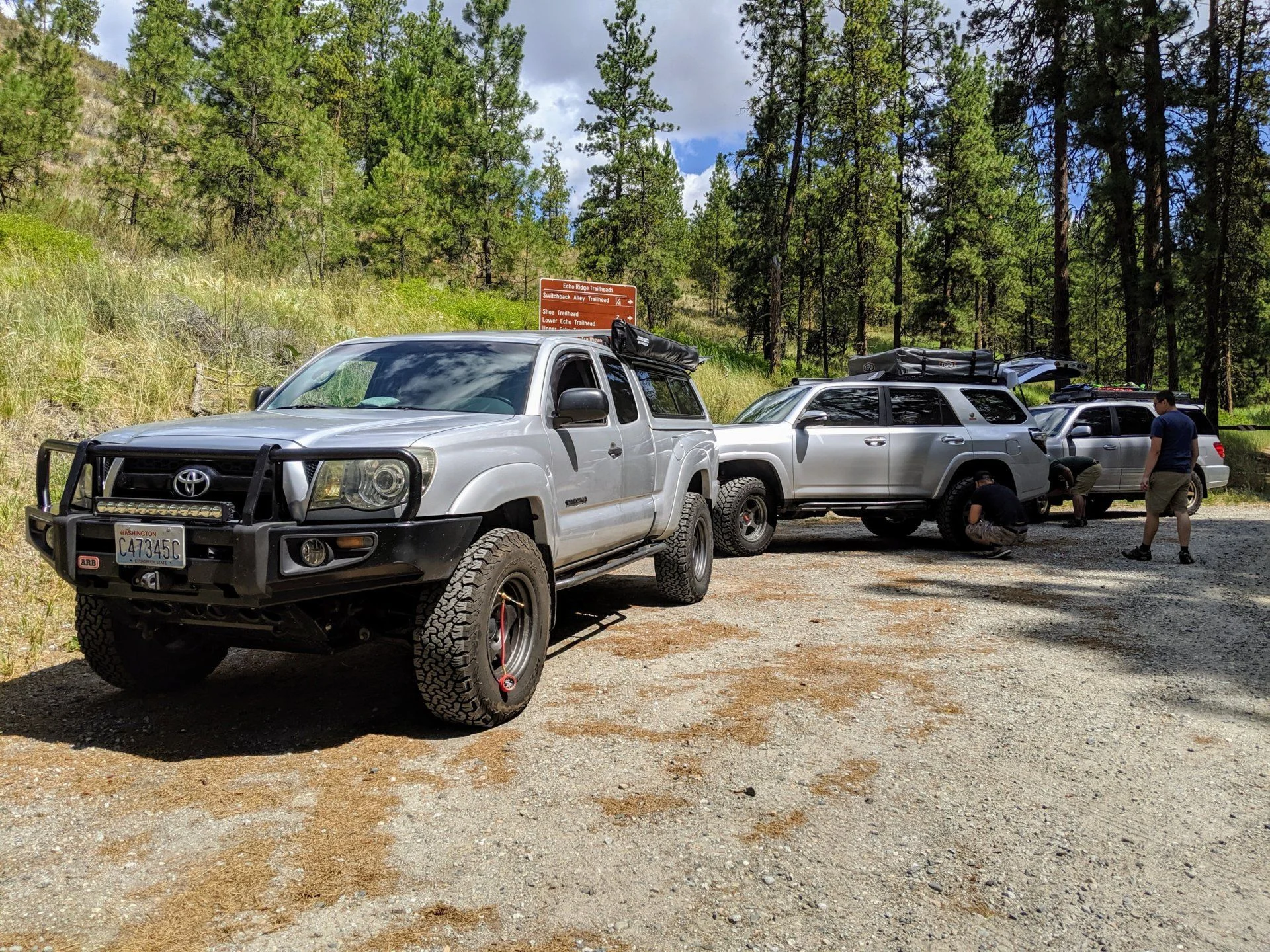

I have had them on my Tacoma for 2+ years. I like em for the profile and weight, but you will find that they are severly undersized for what you pay for. Over $300 a tire that barely measure 33.25" on an 8.5" wide wheel. Unless the price has changed I would stick with the 255/80/17 (Cooper ST Maxx, Nitto Ridge Grappler, Falken AT3W, and maybe a few others). If the BFGs were $250 each I would consider them again.
