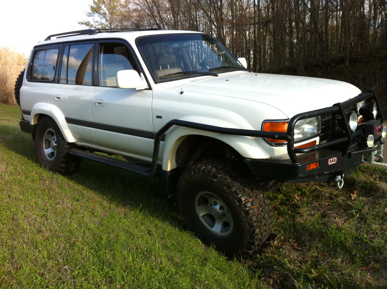

So I just got my new rubbers installed yesterday, and they fit absolutely perfectly!!! Just a very small amount of trimming in the front.
Set up:
-OME J's front and rear, 1" Slee spacer in the front
-Extended rear swaybar, no front swaybar
-Slee CC plates, NO BUMPSTOP drops.
-Bumpers, sliders, winch, duel batteries, drawers with a bunch of tools
~6500# and the lift has been on for about 1.5 years, so its settled a little.
-1" wheel spacers, with stock wheels.
They stuff perfectly!! I will get some flex shots later, I couldn't last night when we were at the shop, got too dark.
Also forgot to add that the 5.29's are a great match for them, they were a little too low for the 35" MTR's I had, but these are great!!!
37's+5.29=awesome (Nay has been saying this for a while, but I agree 100%)
Just hope they last longer than the MTR's (~18K miles)

What exactly did you have to trim in front? And where are your 1" wheel spacers from?
Every where I look they are 1.5". Oh and they look badass
I cut about 3" off the rear of the front fender, I just cut it with a cut off wheel and tapered it up to nothing, I'll post up a pic of the cut offs later, then I just bent the inner fender to the cut Piece, it's no show truck, but doesn't look too bad.
As for the wheel spacers, I got them from Trail Gear and they were reasonable, anymore than1 inch would cause more trimming to be done, 1 inch is perfect in my mind.

With my stock wheels and no spacers, mine does not rub at all with the 2" bumpstops in the back. They just tuck into the wheelwells.
