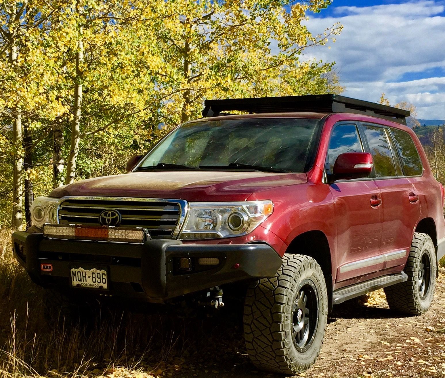

I have run 33/12.5r18 Nitto Ridge Grapplers for 3 years. XD Machetes +25 offset. 2-3" lift. Slight rubbing back inside front fender wells at full turn. No complaints for width and size. My next set will be more than likely be 285/70r18 to fit inside fender well a little closer.
