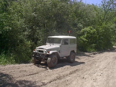

33x12.50x15 witrh 2.5" lift springs, stock front shackle, 3" over stock rear shackle (remember this gives another 1.5" at the axle, giving a 4" lift total in the rear). It sits with a slight rake. This is the minimum lift to stop the tread from rubbing on the uncut wheel wells during typical articulation on the trail. If I did rock crawling, the wheel wells would probably need to be cut.

I have a small block Chevy conversion. This weighs less than the stock six. So the front sat up a little higher than the back. The back needed to come up about a half inch to make it ride level, which would have needed a 1" over stock shackle. I went ahead and put in a 3" over stock shackle (1.5" lift at the axle). This gives me a bit of wiggle room for when it's loaded down with people, cargo, trailers, etc. If you're running the stock six, I doubt the front will be higher than the rear.
Here's a side view. It looks like a lot of rake, but if I parked the other direction it would look like it has a lot less rake.
