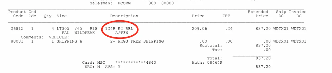

305/65/18s on +20mm Success!!!
I looked up my old order from 2018 and it does appear they were E-rated. They were purchased through discount tire, but trying that part number gave a broken link.
Can't believe the tire went up 100% in price in 5 years!
