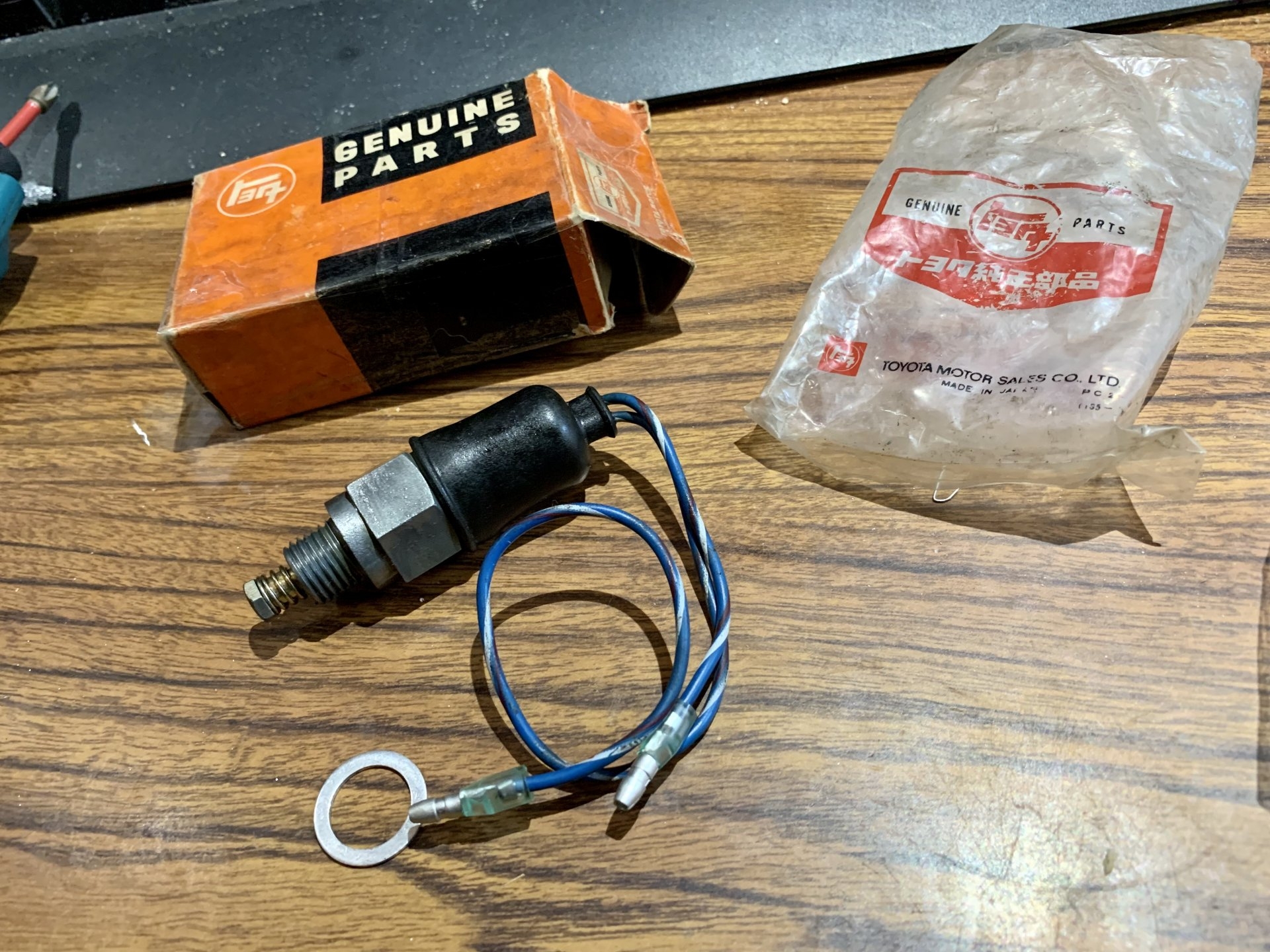

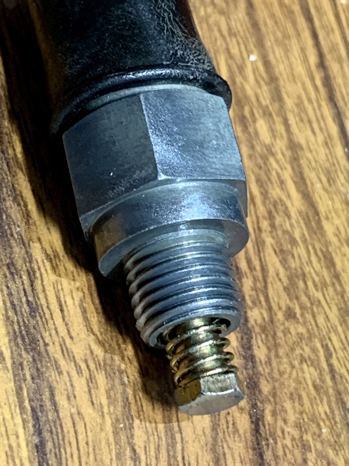

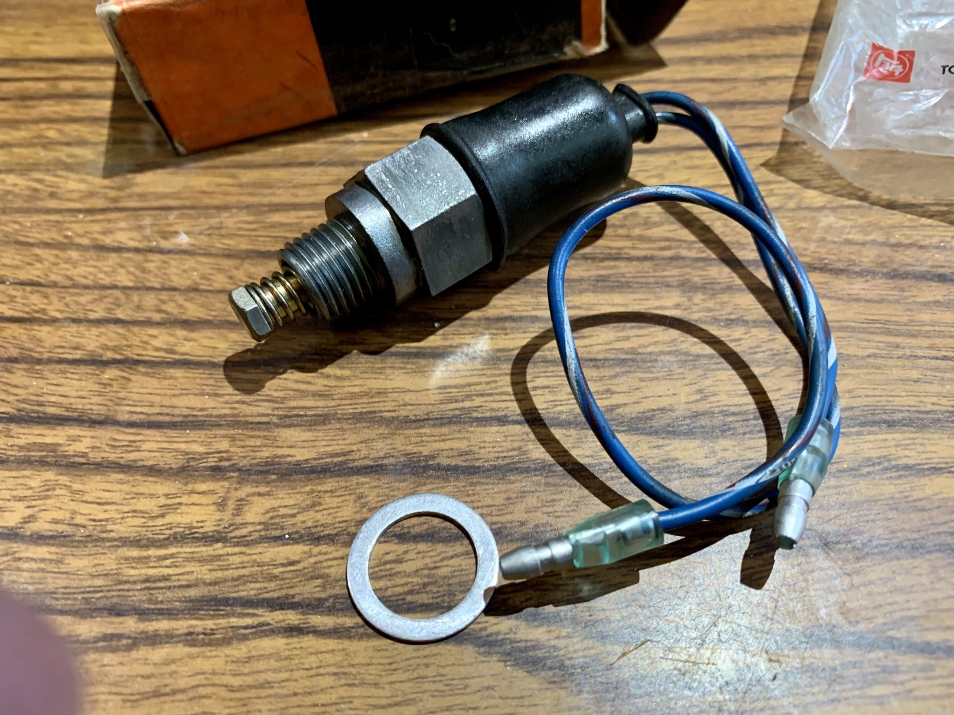

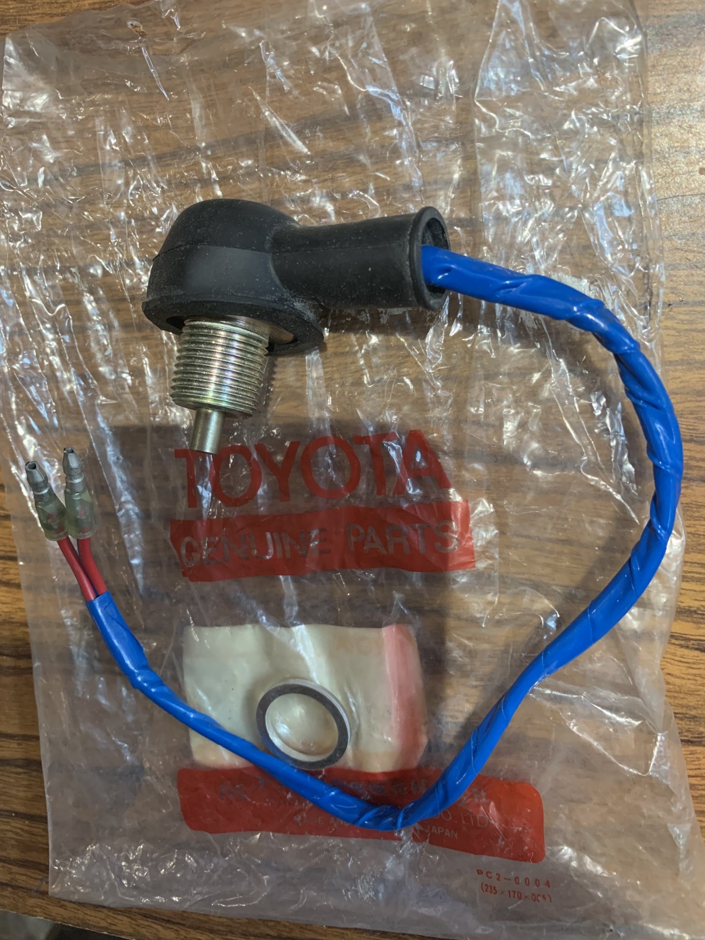

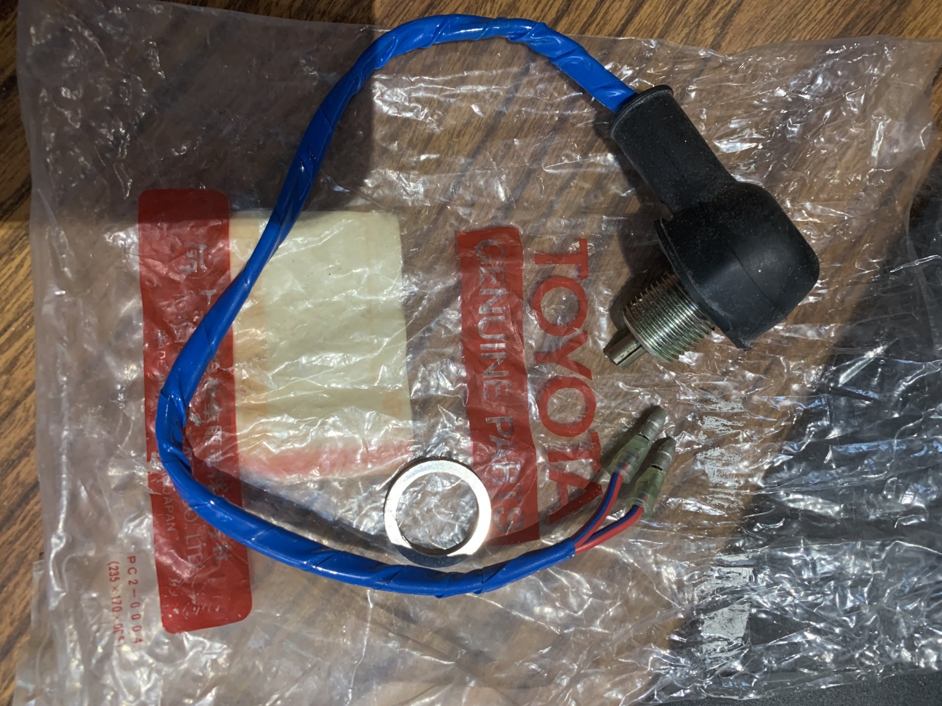

This NOS Switch Should be your unicorn 🦄
it’s simply a later one with pigtail / verse your early make bullet connectors equipped terminals one
I have a box of these and they indeed have solved this problem you have going on
however I don’t know all the tech on any changes that may have occurred though out the entire column mount shifter era ?
you don’t state the model
Year or production date of your land cruiser ?
this would help nail the coffin shut and perhaps I indeed think this may solve your issue at hand
I can measure any specs you ask for
and please ask and provide some
thanks
What does the all wise and WAG knowing @3_puppies
have to input here ?
thanks

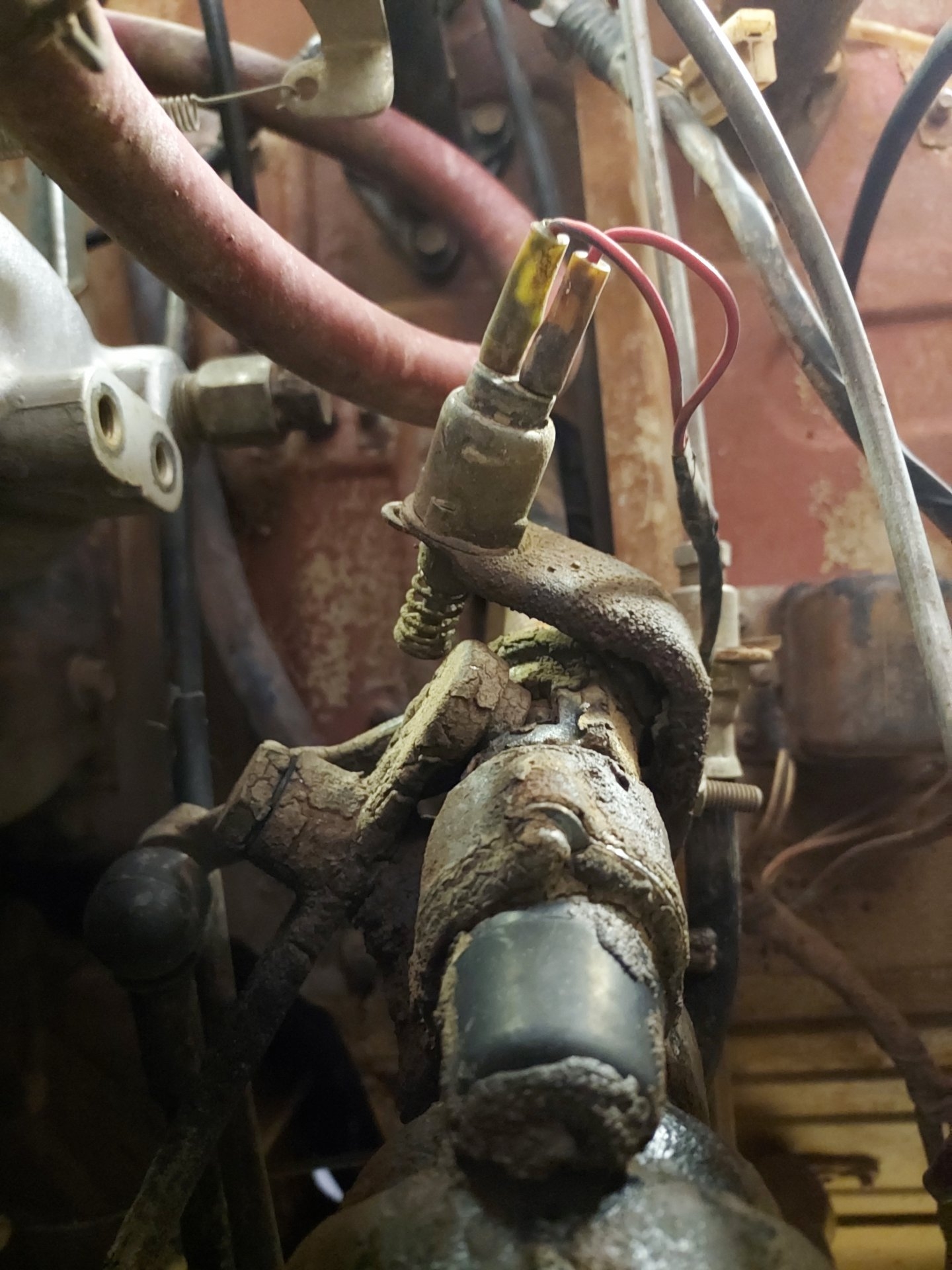

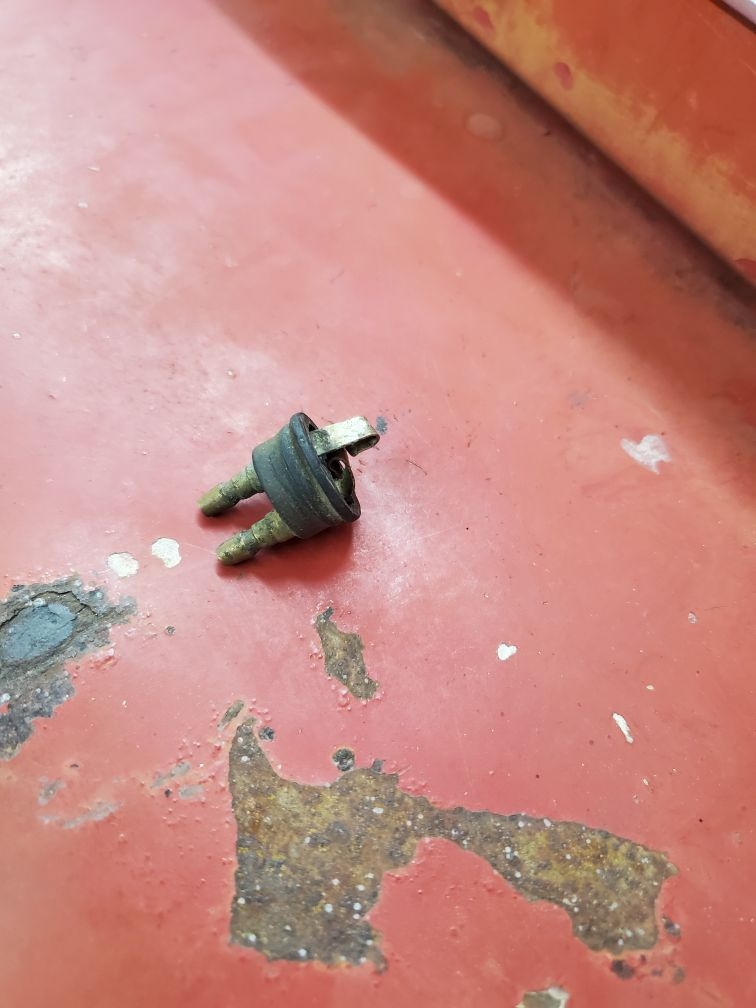

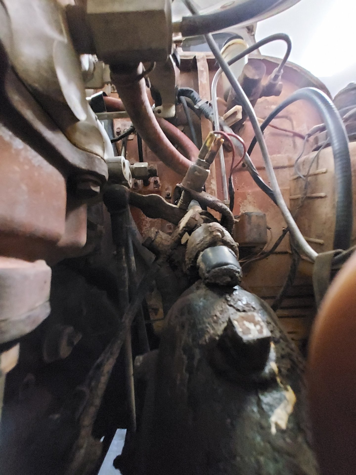

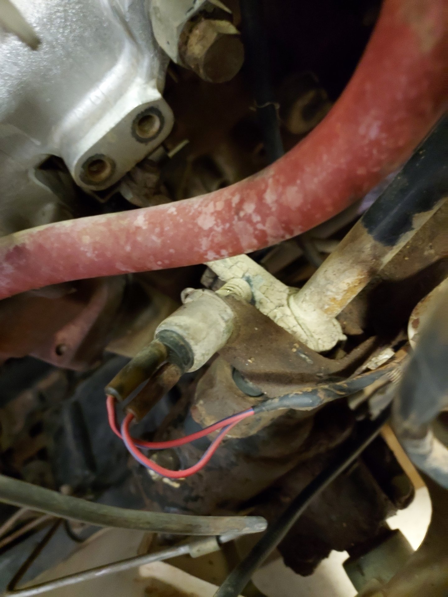

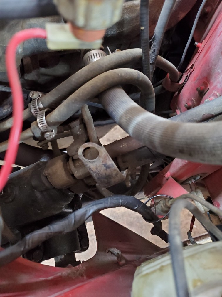

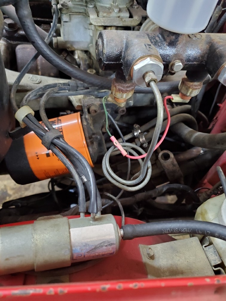

View attachment 2750957View attachment 2750958View attachment 2750959View attachment 2750960View attachment 2750961
Thanks for all the input so quickly!
My FJ40 is a June 1971.
Below is a photo of the area where the switch attaches to the linkage.

where is the rest of your switch ?
do i need to supply you with a hex nut ?

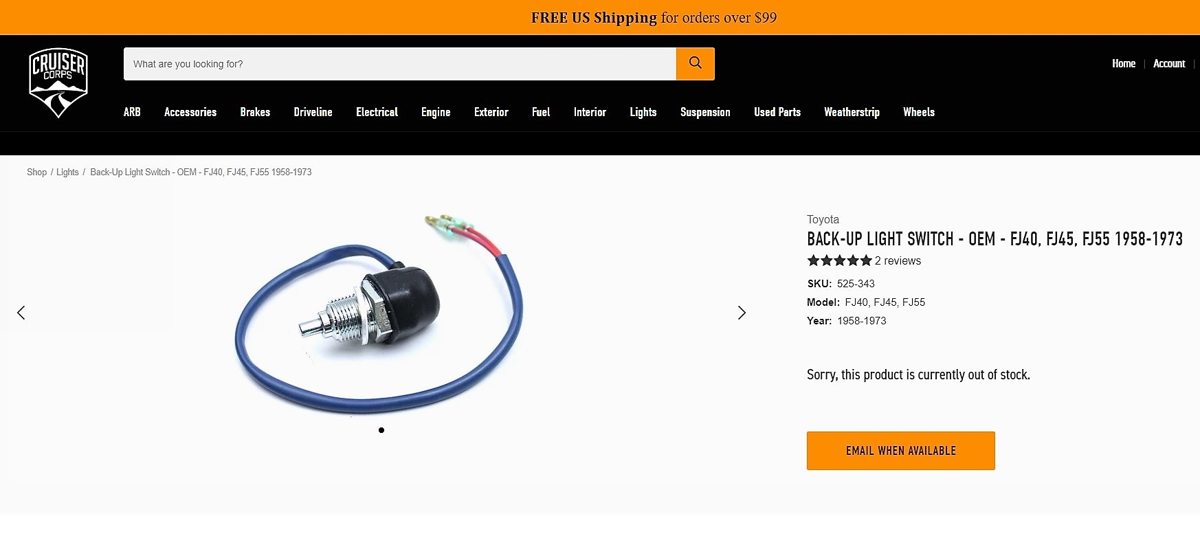

This one looks like in screws into the transfer case. Not sure how well it would hold up to the weather. They also use a C clip to hold it to the bracket. What is needed is a weather tight normally open spring.loaded momentary switch. Can get a picture of the ome.in my 70 FJ40 mounted to the base of the steering column.
Should.add it needs to be activated with a plunger.
This is from the cruiser corps web site to be clear , and is only being used for TECH reference ......
would you say John this switch is a correct application with the screw in threads it appears @ZachA does NOT need like you say ?
he needs a clip style with his sheet metal round hole bracket
right ?
right ?
I believe this is for the floor shifter style. Our column shifter uses a clip similar to brake hard lines and a wavy washer, but one may be able to retrofit it to work.

First picture is in gist gear. Other two are while in reverse .View attachment 2751185View attachment 2751186View attachment 2751187
if anyone knows the tech it's JOHN and mark A :)

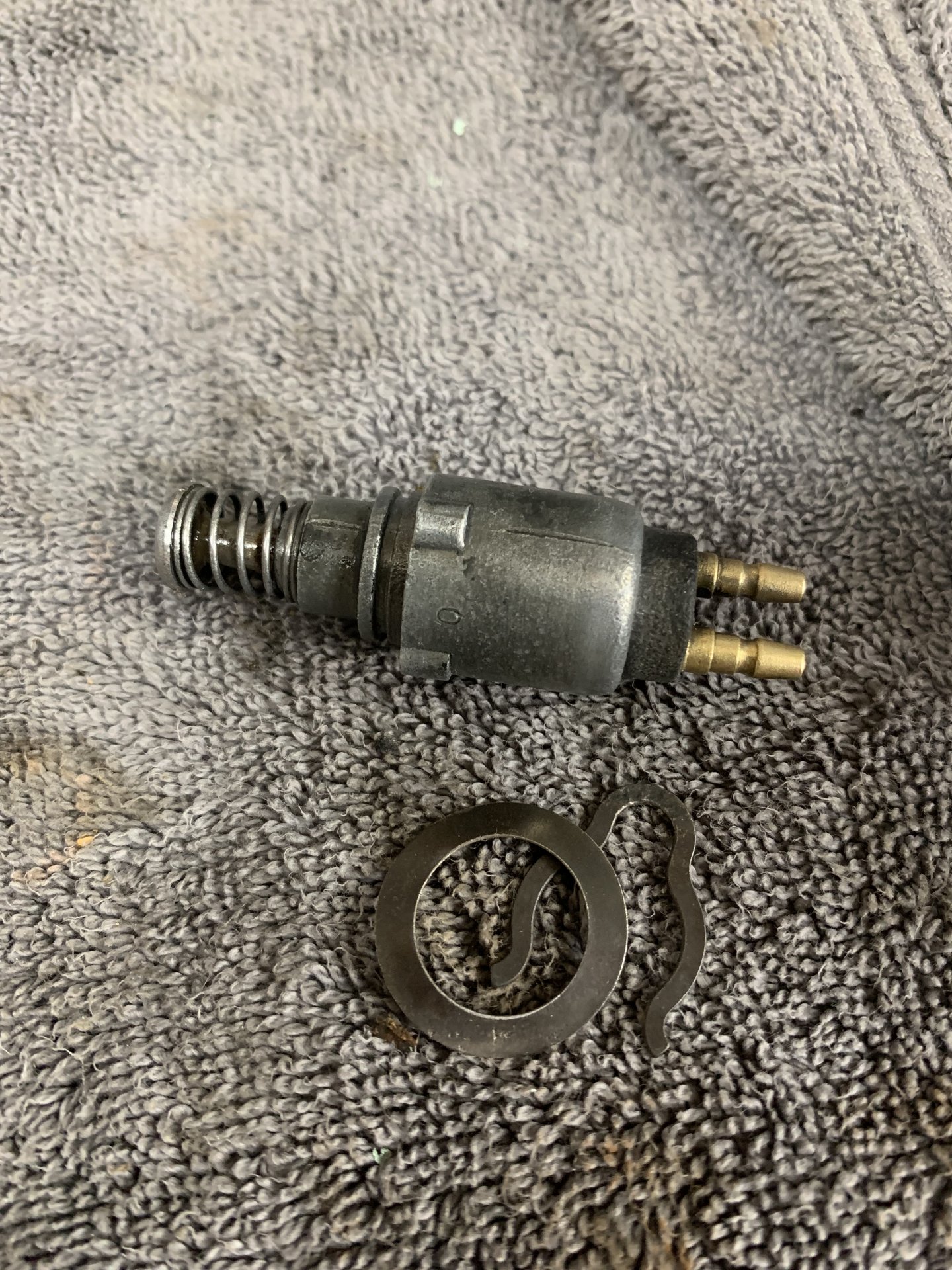

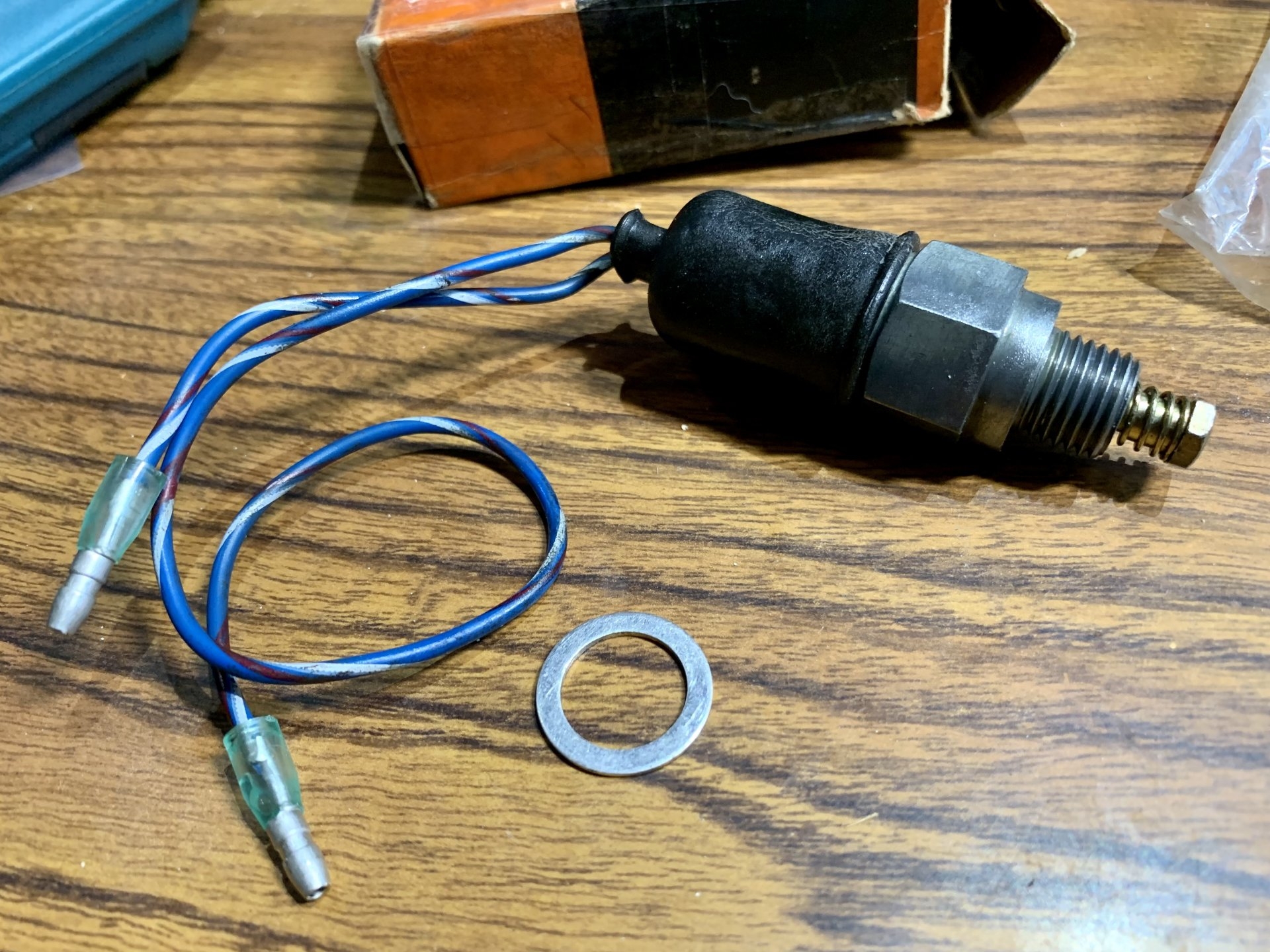

Here is the one from my 71 column shift, for reference.
Pretty clean 40 - I just hope the bezel police doesn't see it . . . o_O
On my 11/69 I used a Fastronix 305-001 aftermarket momentary switch which did the trick. Seems more durable than the factory. Had to change the wire ends from bullet to ring terminals, that was it.
Looks like a good option as a replacement. Really hard to fault the OEM switch. Those ended 9/72. That makes many could be fifty years or older mounted open to the environment under the hood. Switched my 68 to a floor shift in 1974. Then later to a four speed. Know thinking of putting column shift three speed in if I paint it. Luckily kept the bracket and switch all these years. Bracket would be much harder to replace.
