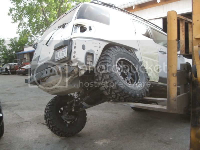

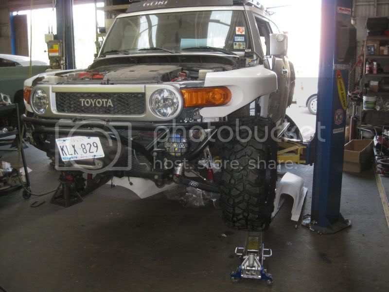

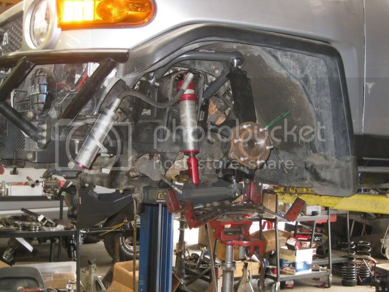

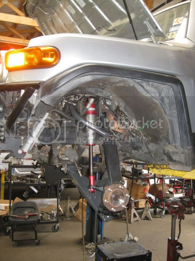

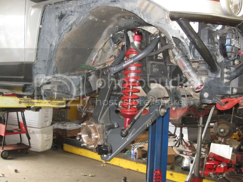

14" of travel on the front.

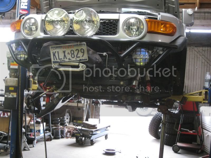

CVs will be fine, the angle isn't substantially different from any 3" lift kit or 2" Long Travel kit (only slightly greater (few degrees) due to the additional rotation in the Camburg uniballs). What is gaining you the additional travel is mainly the width of the front suspension, allowing for larger wheel travel at the same angles as a normal suspension setup would. Draw up a free body diagram with the suspension at OEM width at various angels and then add in the additional 2" or 3.5" and you'll see how the additional travel is gained.
From what I've seen those who have broke them were doing something dumb or gave it too much skinney pedal. Regardless I'd rather have the CV as the weak link than anything else....much easier to replace those on the trail than a differential or transfercase.
Using extended 4340 axle shafts. The only real implication it has is a greater torque on the inner due to the additional length (larger moment arm). Fortunately, the outer is what tends to fail on FJs....not the inner.

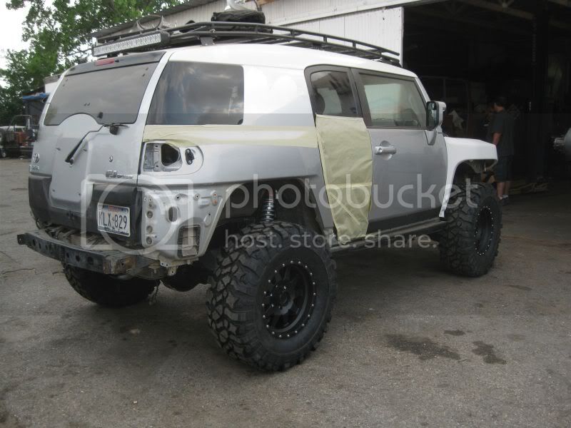

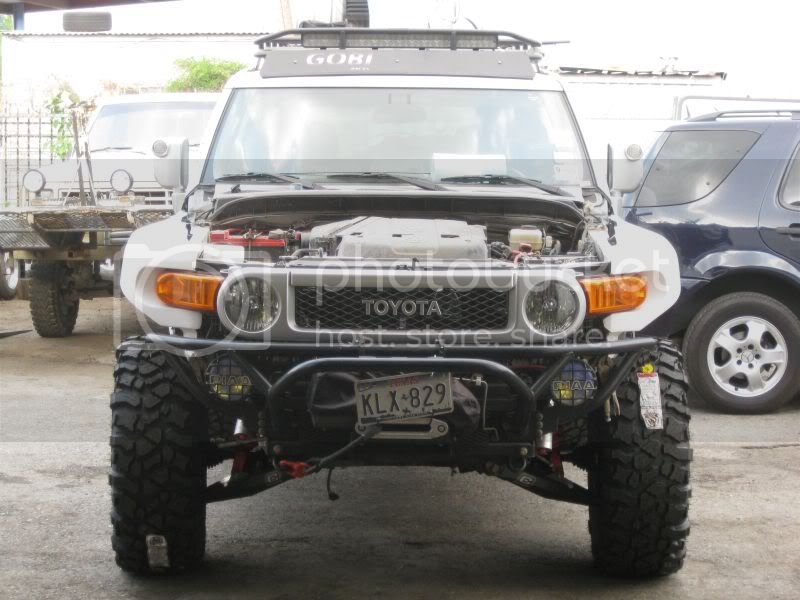

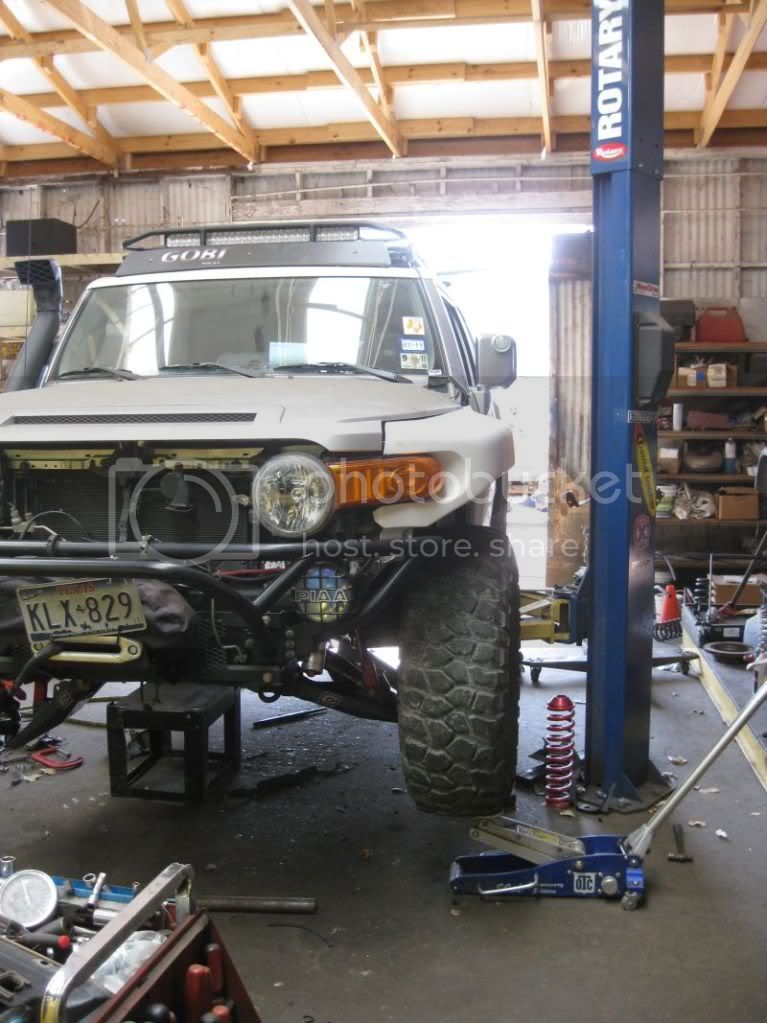

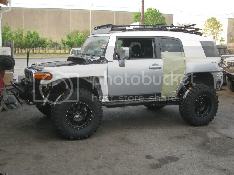

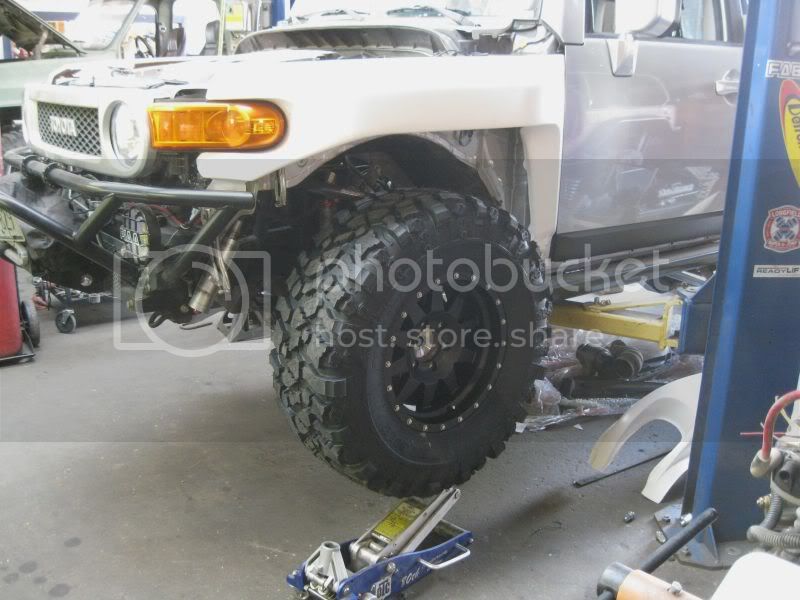

Actual wheels and tires I'll be running came in

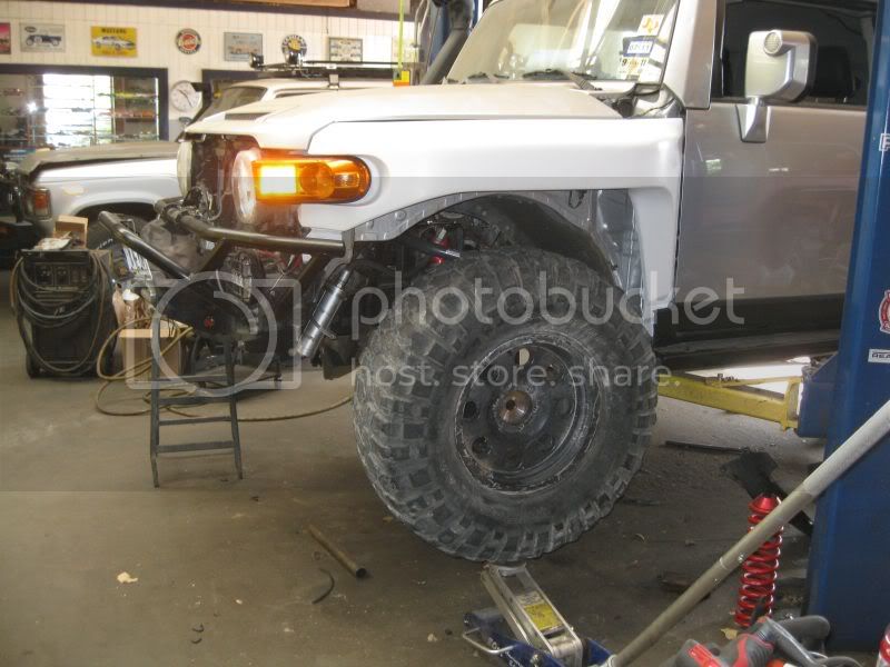

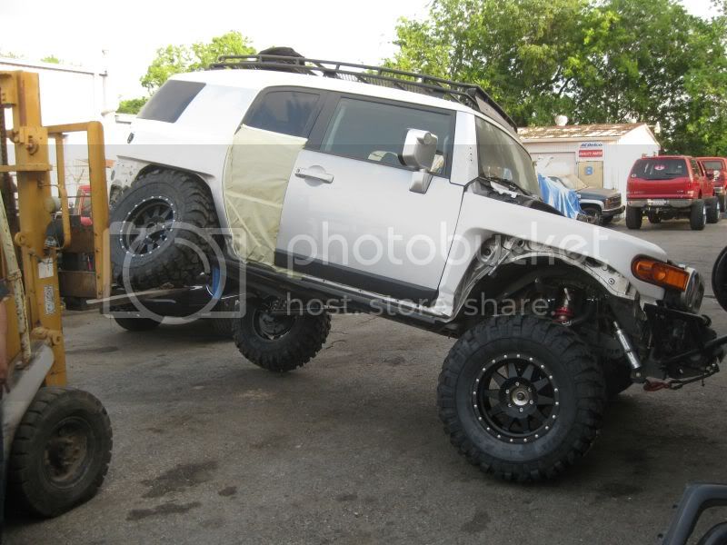

Once the fenders get setup and the axles are changed over to 3.5" axle it should moving under its own power for awhile. Then out comes the lefty and in goes some modifications to the drivetrain tunnel to fit an Atlas 2 + crawlbox.
Able to roll around now...won't be the final ride height since some adjustements will need to be made with the bumper on and weight in the back.

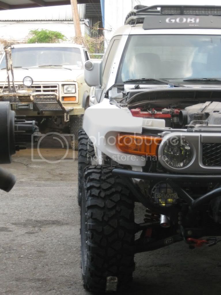

35x12.5. Unfortunately they weigh more than most 37" tires. Might switch over to MT/R + Kevlars since the weight is higher than I'd like. Even with a fairly light wheel I'm still near 105lbs of rotational/unsprung mass there.
That's not so bad considering they are a 12.50. My SSR's in 35x10.5x16 weigh in at 98 lbs each, with the steel beadlocks, 133 lbs...:eek:
Wow thats a heavy tire. Boggled my mind them weighing that much, doesn't interco advertise them at 76lbs for 35x10.5x16?
Although I think I'm more impressed your steel beadlocks only weigh 35lbs. Thats on the light side for a 17" aluminum beadlocks I looked at. All the steel ones (Staz's and others) were closer to 50lbs or more.
Pitbulls are around 78lbs a piece. Thats about 12-20lbs heavier than most other 35x12.5" tires that I've seen.
That sounds right, the wheel being ~22 lbs. The steel beadlocks are made out of FJ80 steelies and a kit from Stan @ Toyoutfitters. These only have beadlock on the outboard bead, others may have both beads locked, adding the weight of the extra steel rings and associated nuts/bolts/washers...
